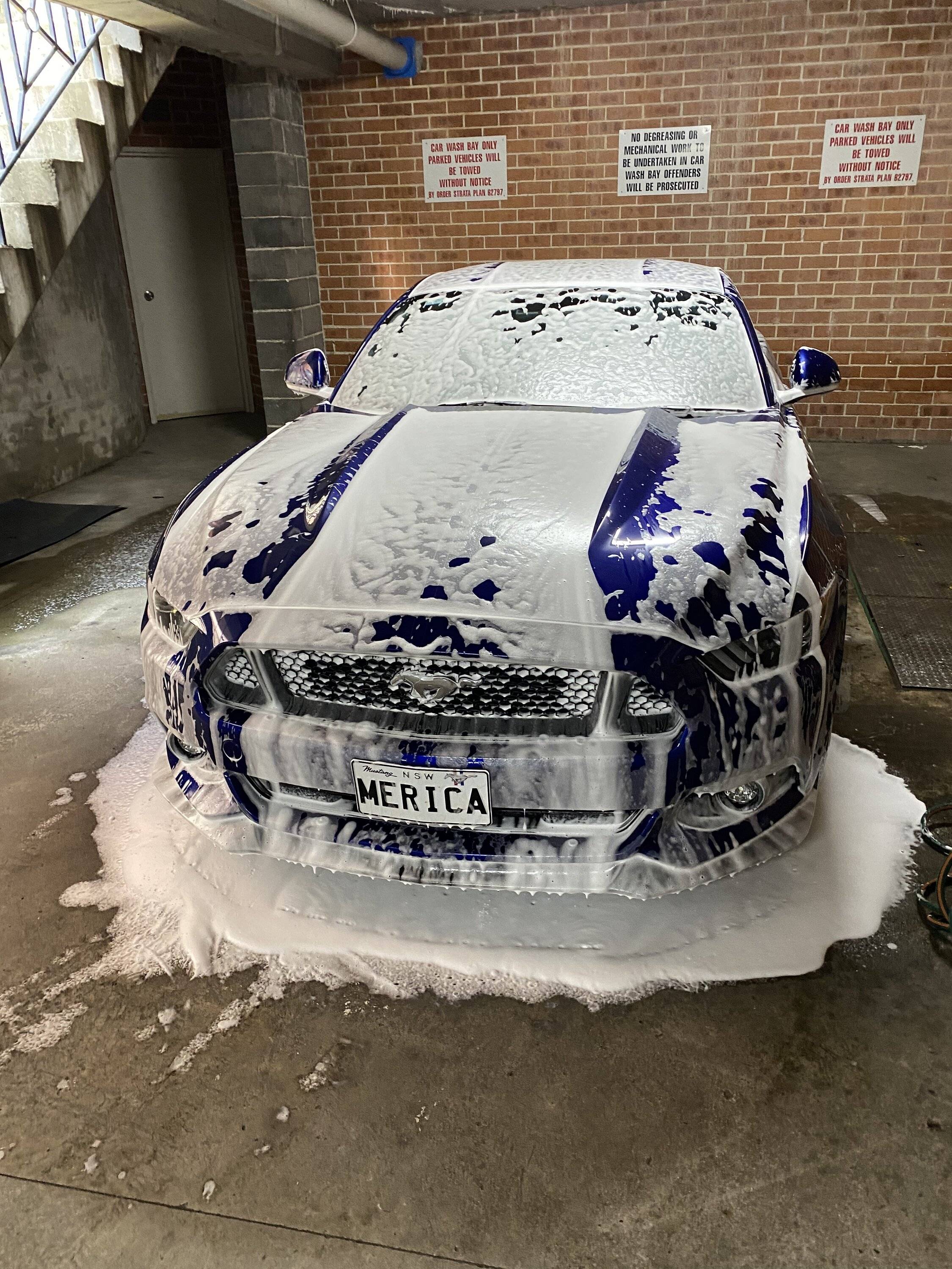

washing the car with the music going
The artist is Klangphonics by the way, they are really good but every so often do techno without computers, and use a vacuum cleaner or something

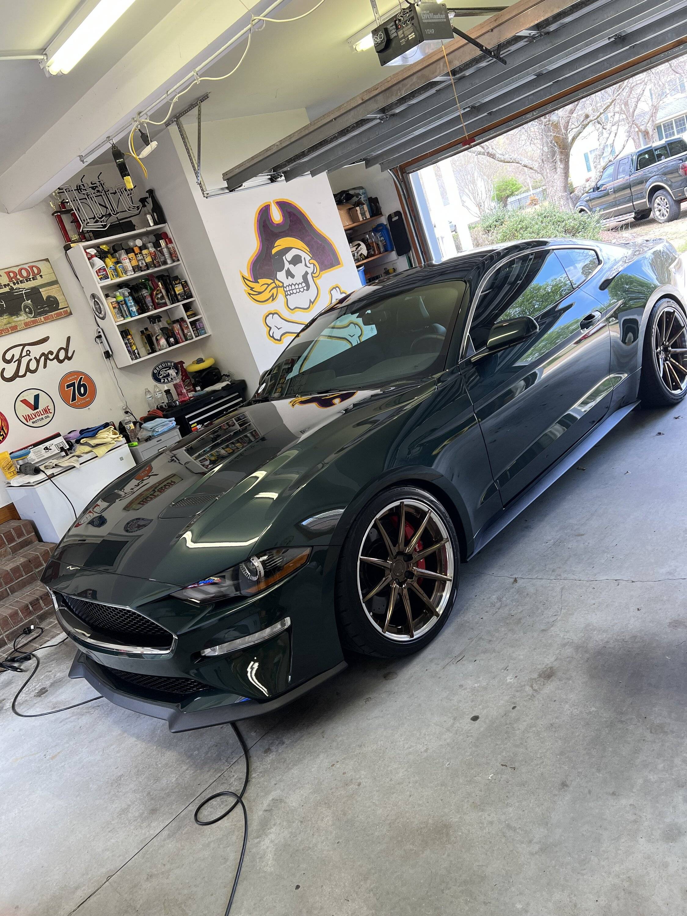

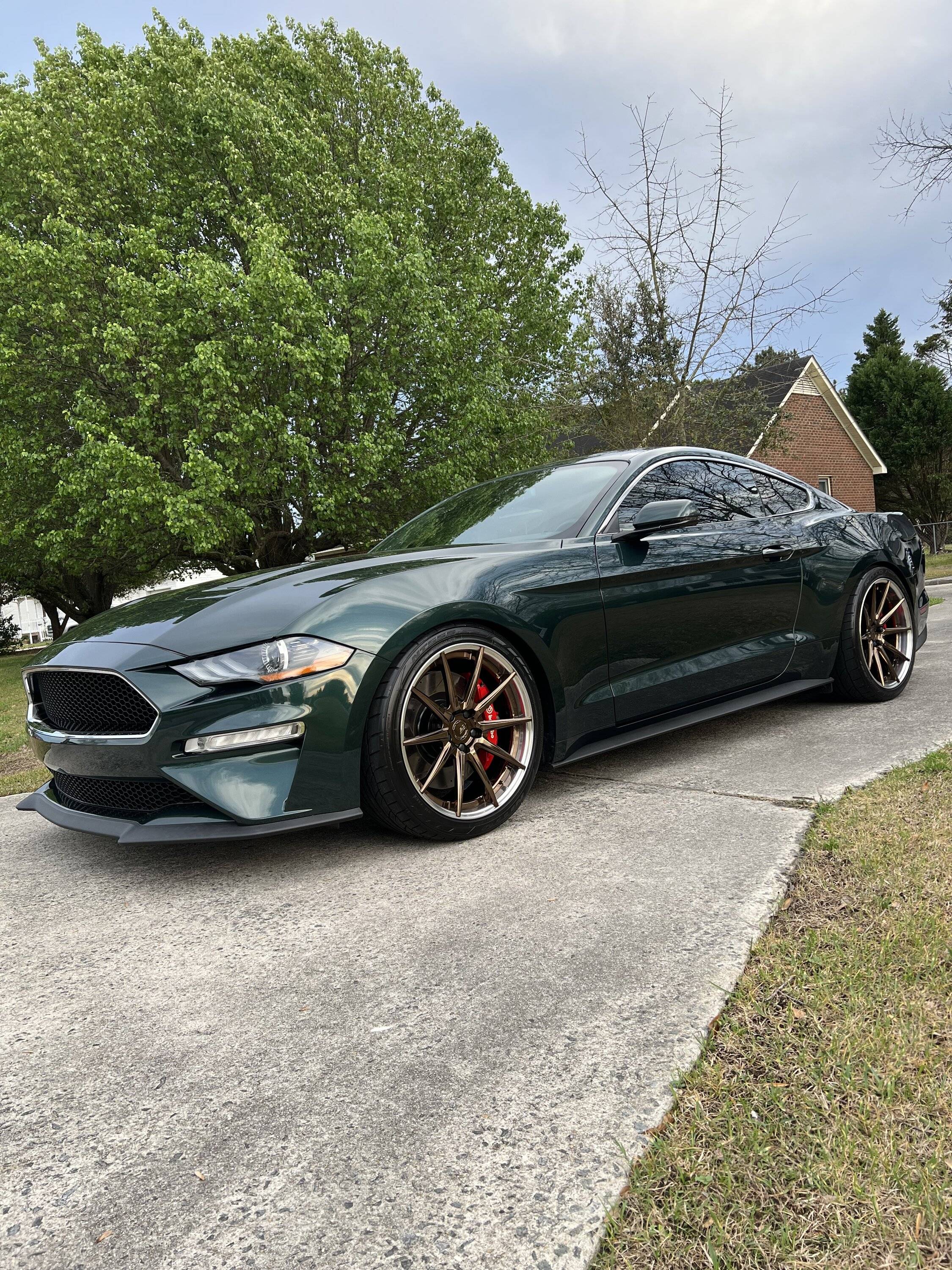

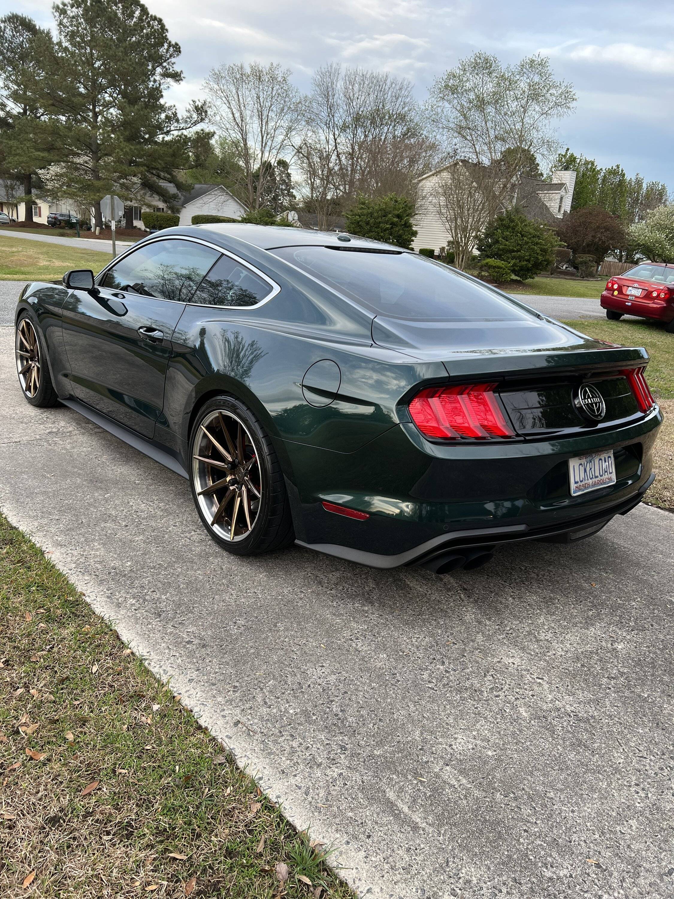

OK wanted to show off my work and my process. Thanks to @DFB5.0 for all of the threads and information you post as I have lurked for a while and looking for +100 on the gloss meter (dont have one but if this work doesnt get me there . . . well)
OK. Here was process and products used:
Wash: Used Chemical Guys Cleaner wax (they say takes off previous waxes and sealants) and for the most part it does:
Then used Chemical Guys Iron Remover on the paint and wheels of the car. No good pics as there was not much iron and only a little purple but nothing of significance.
Then used Mothers Clay block as first attack on contaminants using just soap and bucket:
Sun was only out for a little while so no issue with drying soap on the surface of the car and the temp was about 73f. A very nice day to detail a car.
Then dried car off in the garage and began working on the panels and preparing to polish the surface.
The next thing I do is the "plastic bag" test looking for areas that need more decon. This test really works and if its rough I know I have to take the clay bar to it.
Areas around the vents where stuff and accumulate are perfect places for things to stick to the paint. I used a Megiuars Clay Bar and Quick Detailer to remove these contaminants.

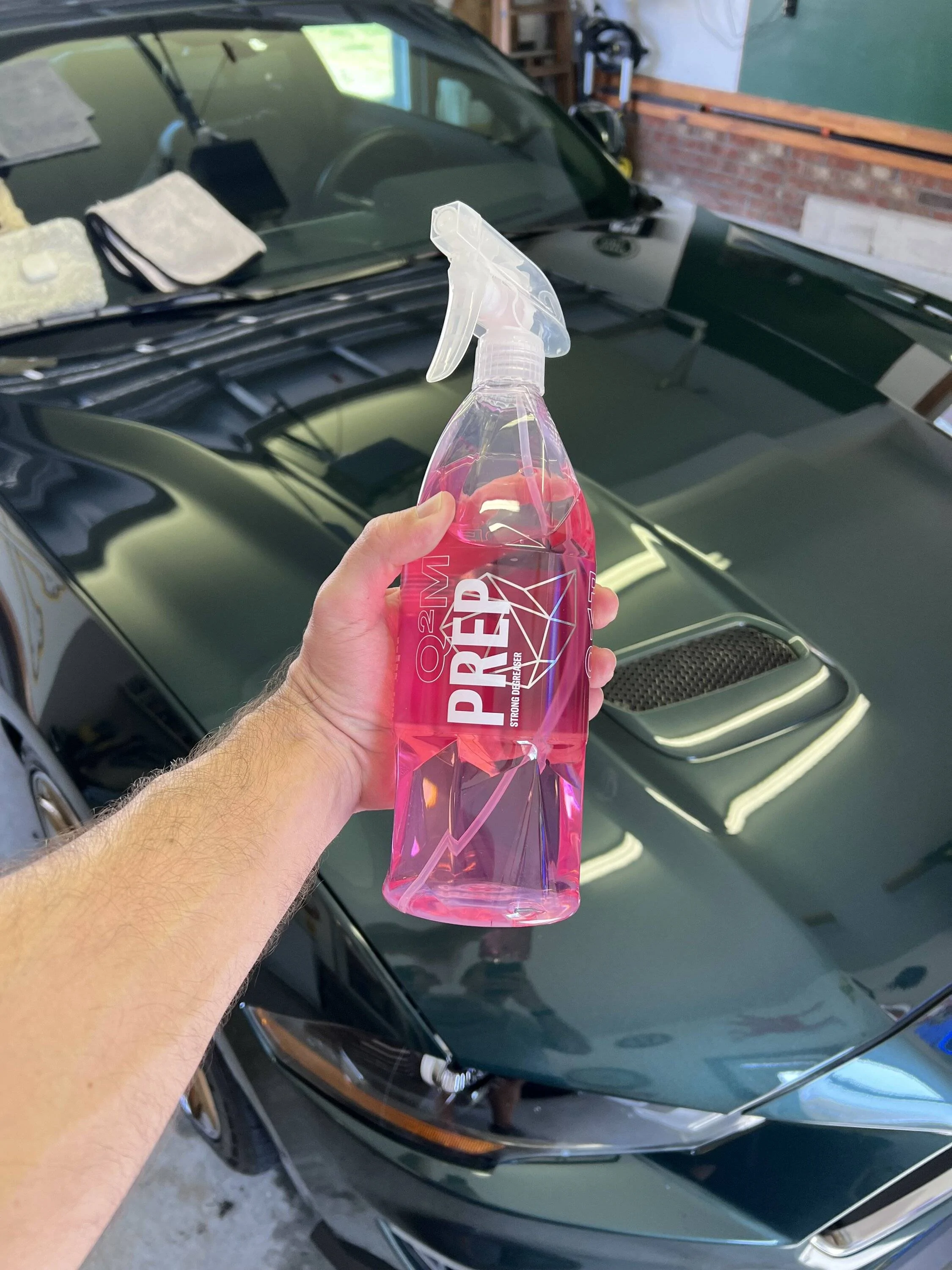

Next I prepared the surface for polish using the Gyeon Prep. I like this stuff a lot and think it was very useful in ensuring the surface was ready to go:

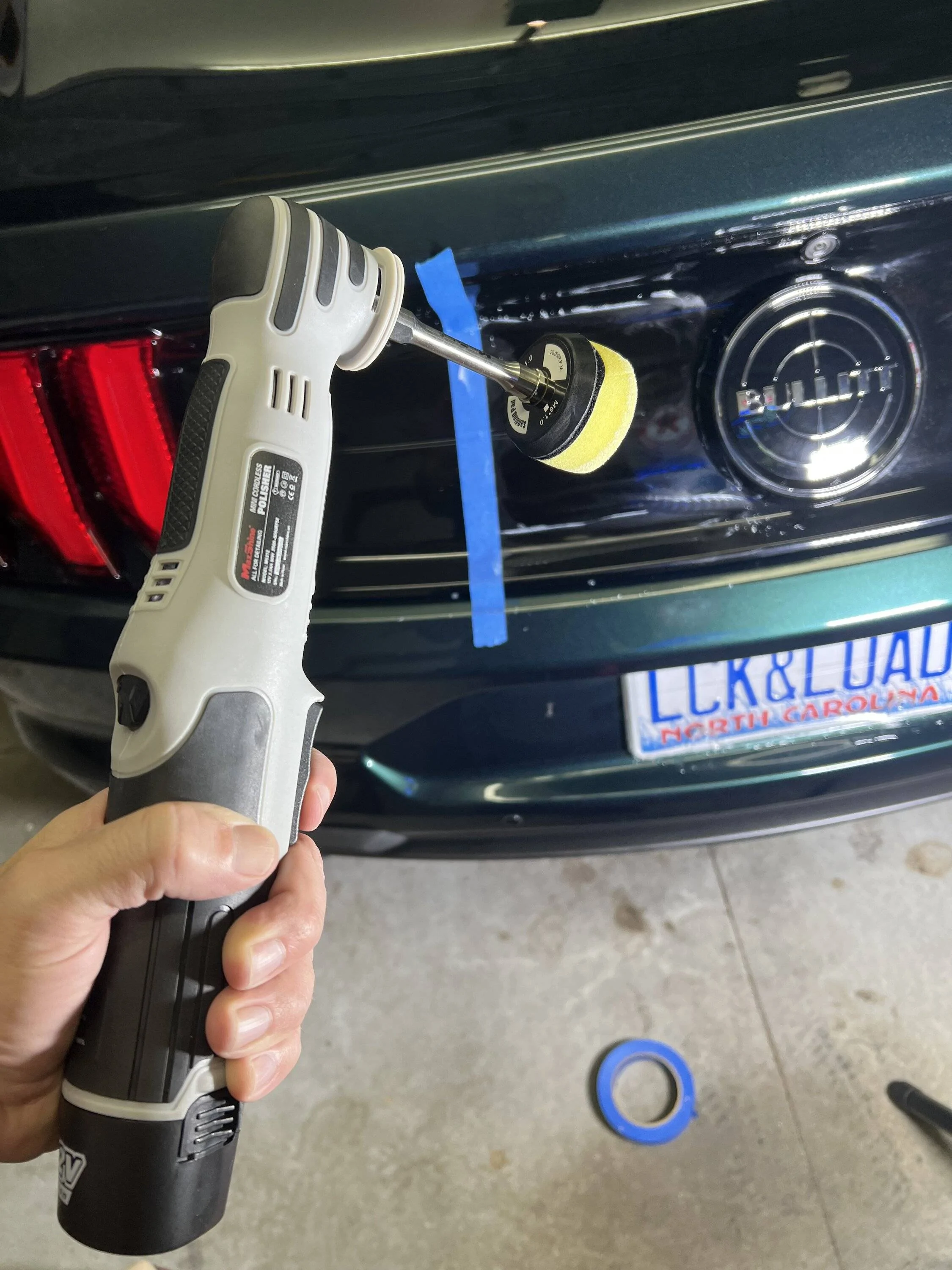

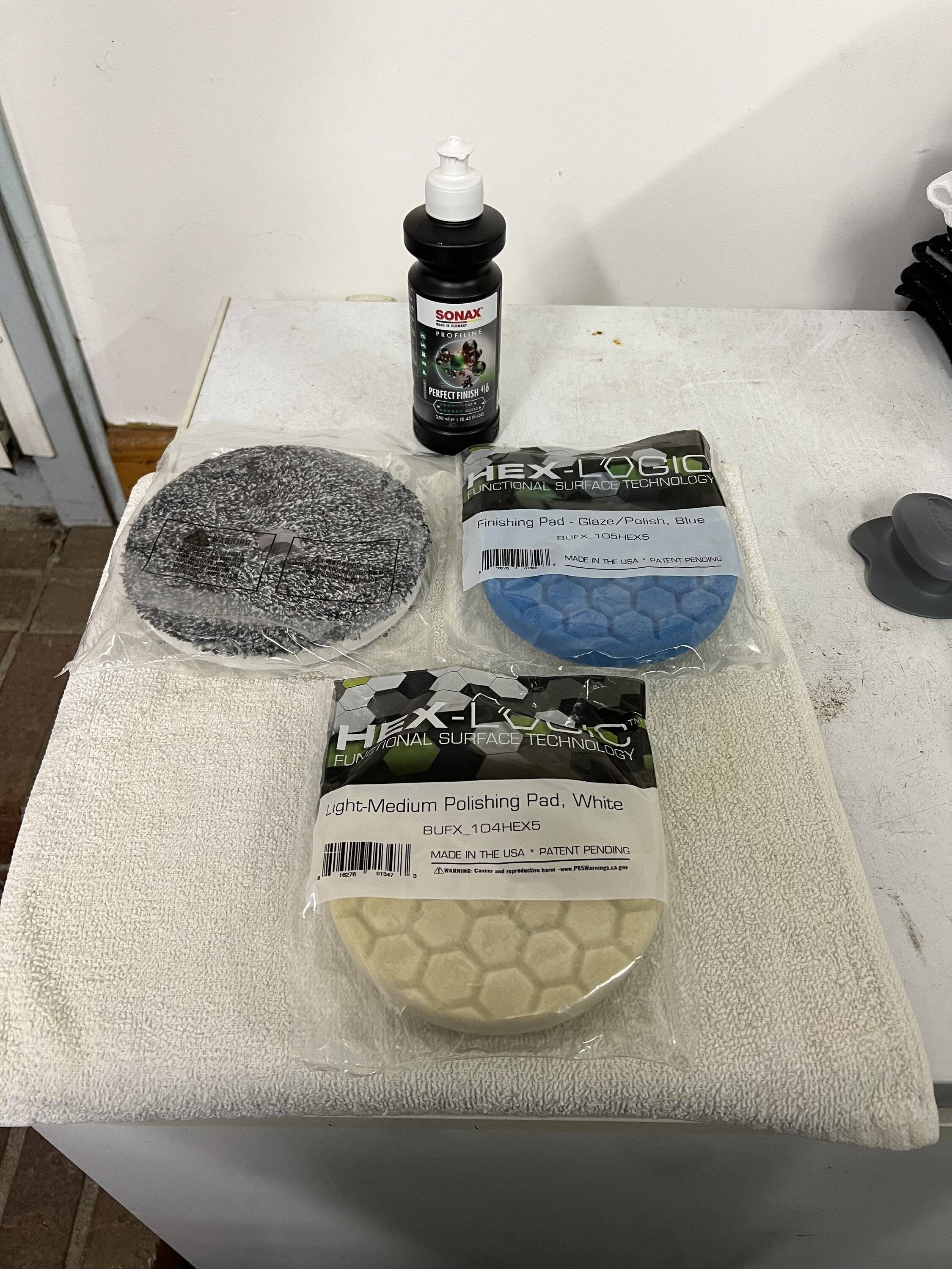

Next came polishing. I polished each panel of the car using Sonax Perfect Finish using a DA polisher set on 5.5 and different pads depending on how much I need to cut vs finish. Perfect Finish can do both so if I had some areas of swirls (Which I didn't have too much) I would use a more aggressive pad other wise I used a finishing pad.
For the smaller areas I picked up the Max Shine Mini Polisher. The back panel was driving me nuts cause I felt like I could not get a good polish on it:

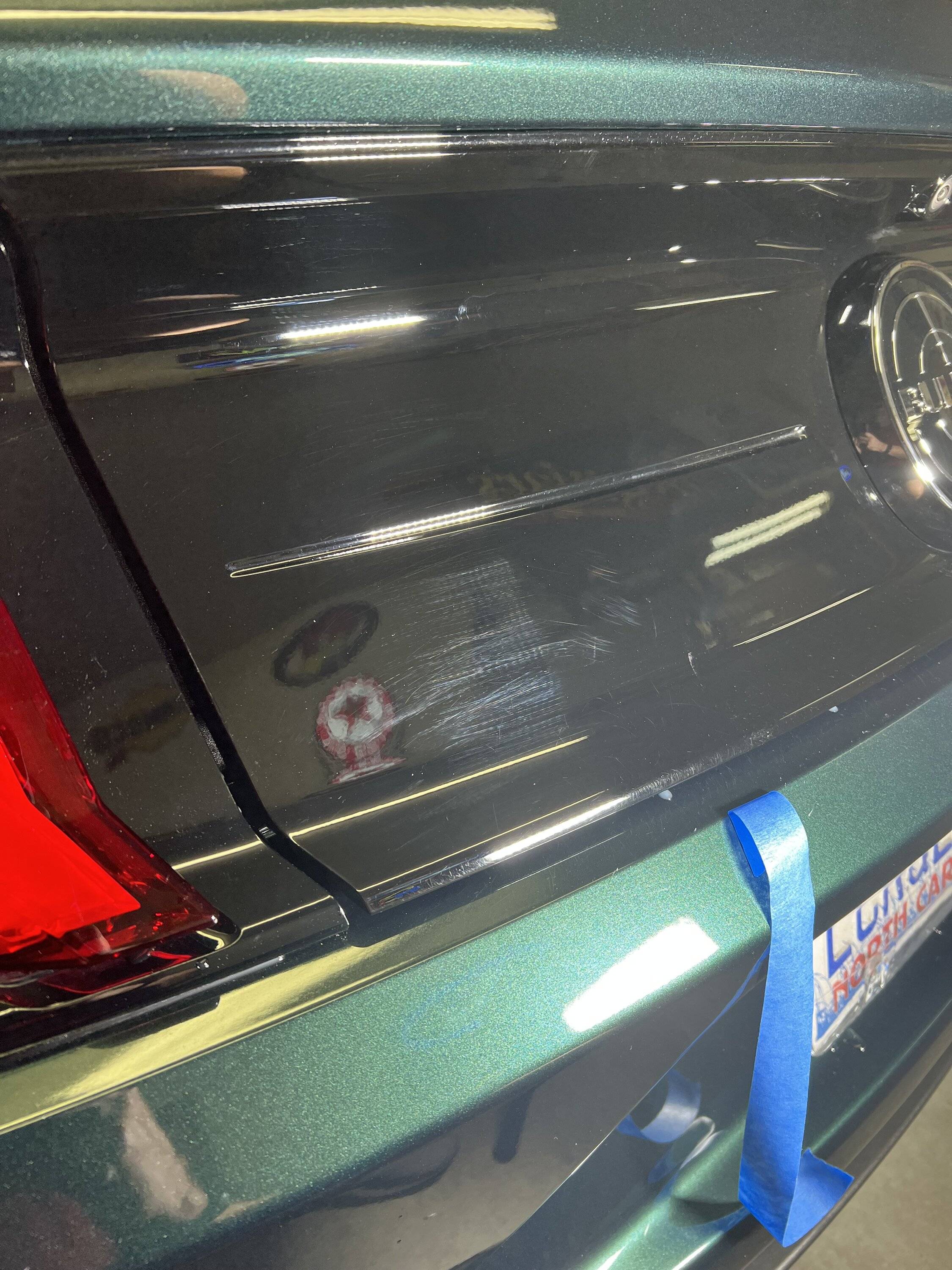

Yes that is a couple years of neglect and washing and wiping and black paint. I know its kind of embarrassing but it is corrected now and can be properly maintained.
Another round of Gyeon Prep and I was ready for some new stuff.

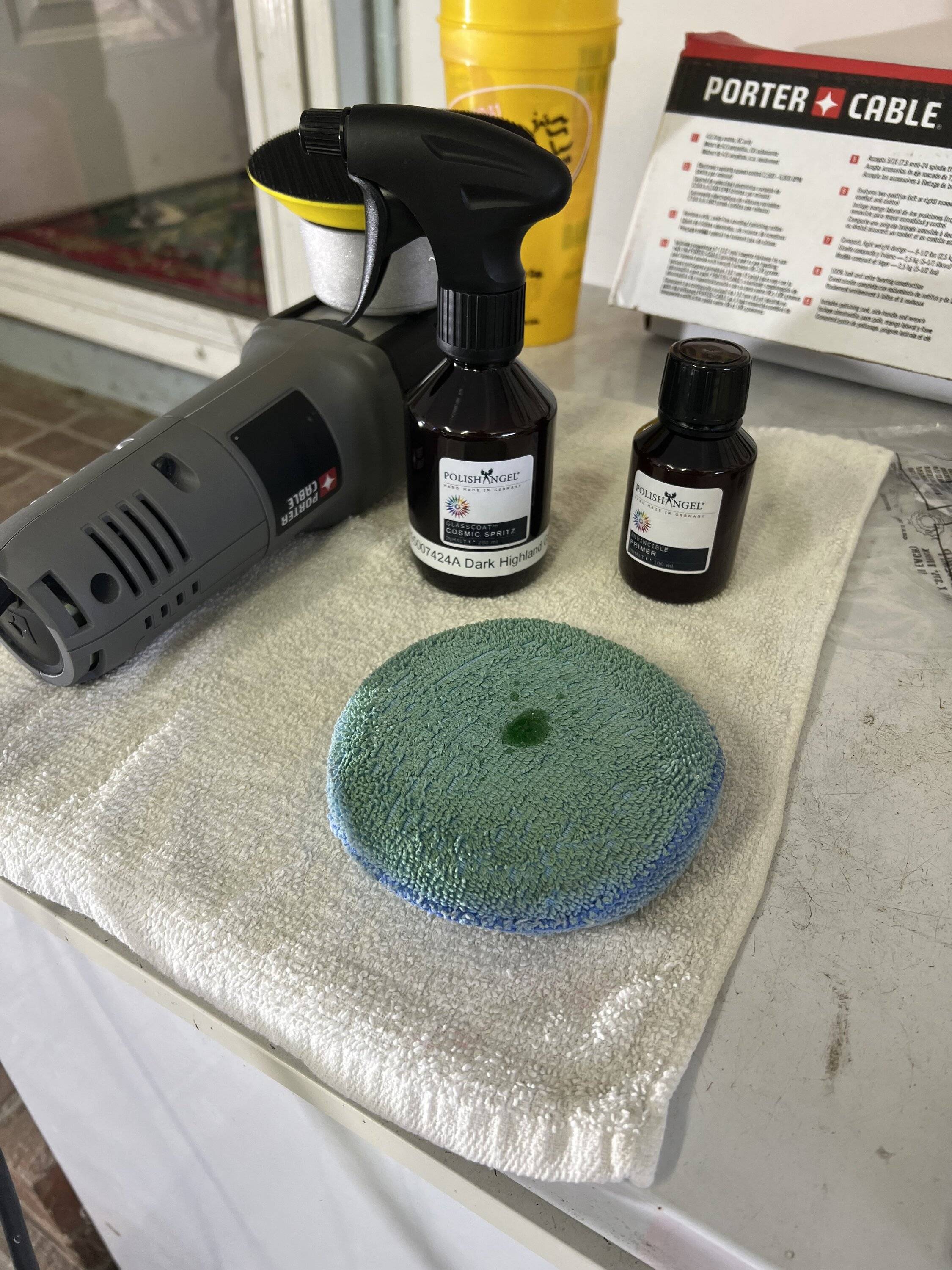

In my research I came across some Polish Angel Cosmic Spritz and read the reviews and people really like it. Well I found out that you can get some that is now "color matched" not sure how much of a gimmick it is but they got me. Took my money:
Its a two step process of putting down the what they call the Polish Angel Invincible Primer and then (2) coats of Comic Spritz. One thing I like about it is that you can use it as a drying aid as well when you wash and it maintains the glossy look. We will see.
First Step: Invincible Primer
It went down easy and came off easy and seemed to be like another pass of a finishing product so I liked that. I used the DA with blue finishing pad and did the sections around the car. They say that you have about 8 hours to then apply the Spritz.
Next Step: Polish Angel Cosmic Spritz formulated for Dark Highland Green
It comes out of the bottle as Green but as Dark Highland Green (idk). Either way it went on very easy by hand all the way aorund the car. It took me about 30 mins to make it around the car and I waited 2 hours and did a second coat and then allow to cure for the night
Results: Pics dont do justice let me say . . .
Recap on Process:
- Wash
- Decon (Iron Remover)
- Wash
- Decon (Contamination Remover)
- Inspect
- Clay Bar
- Prep (Gyeon Prep)
- Polish (Sonax Perfect Finish)
- Prep (Gyeon Prep)
- Polish Angel Invincible Primer
- Polish Angel Cosmic Spritz (2 Coats)
- Cure overnight
Hope this helps. Thanks to everyone who has posted their processes. Very helpful.

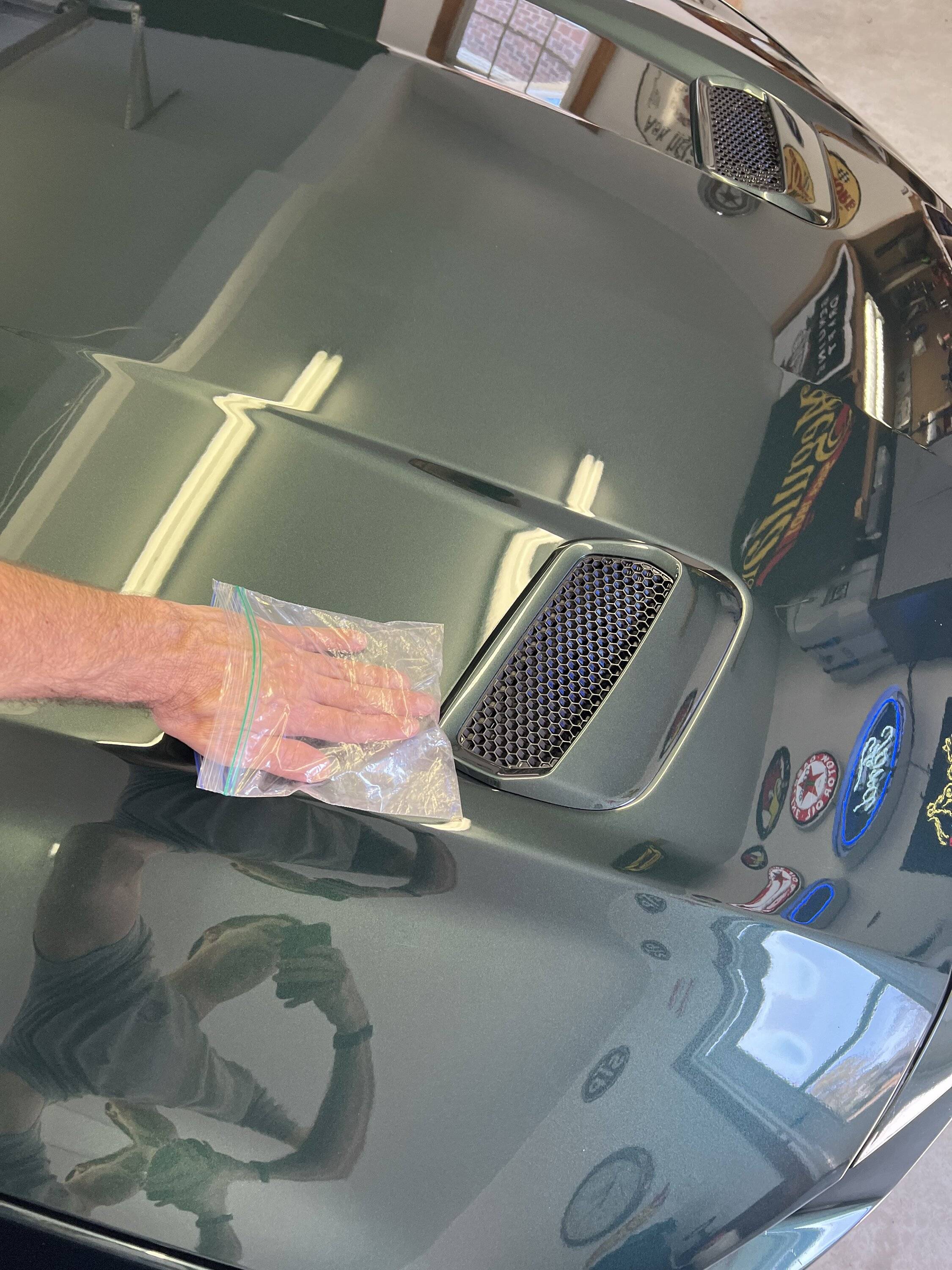

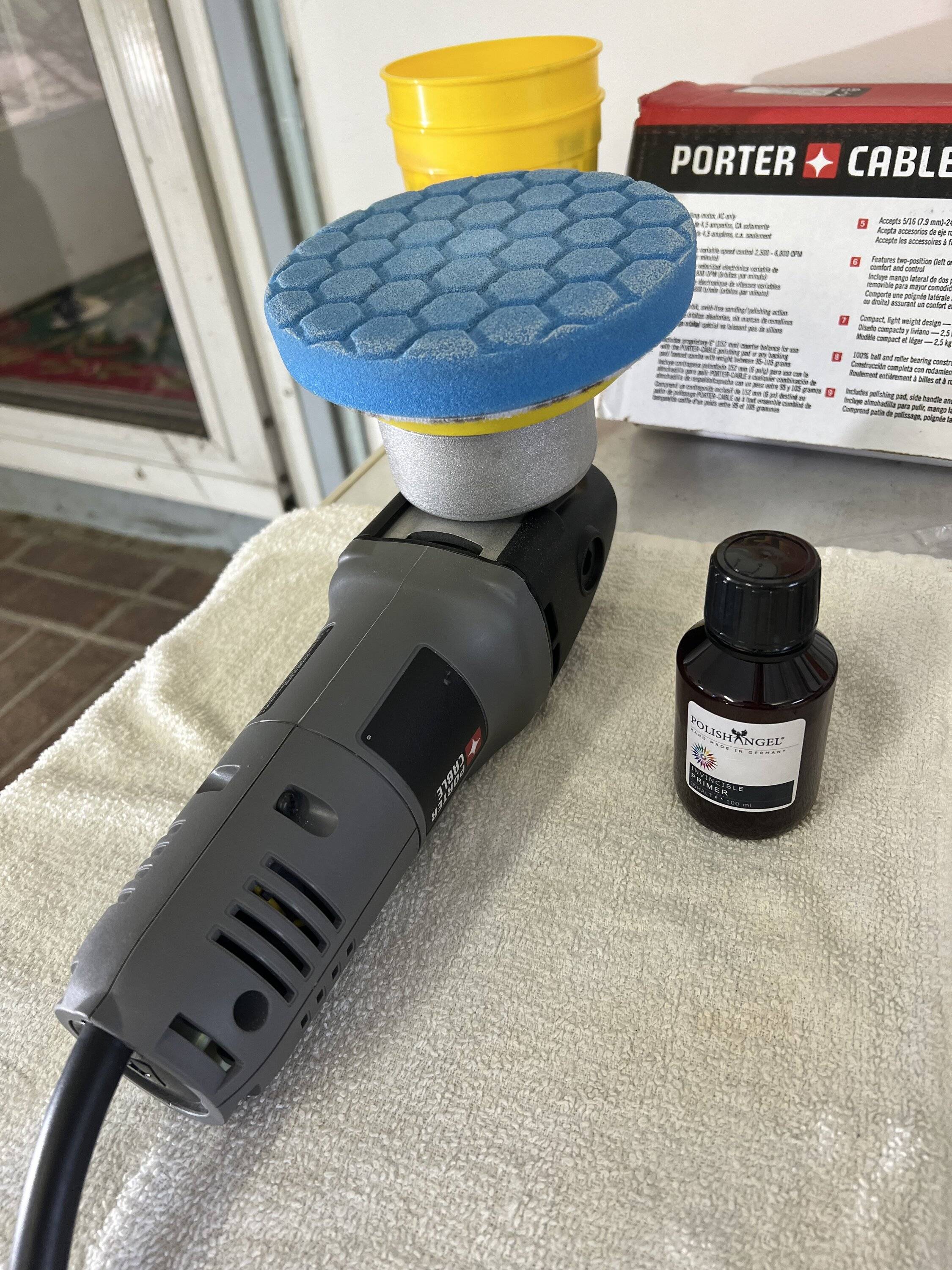

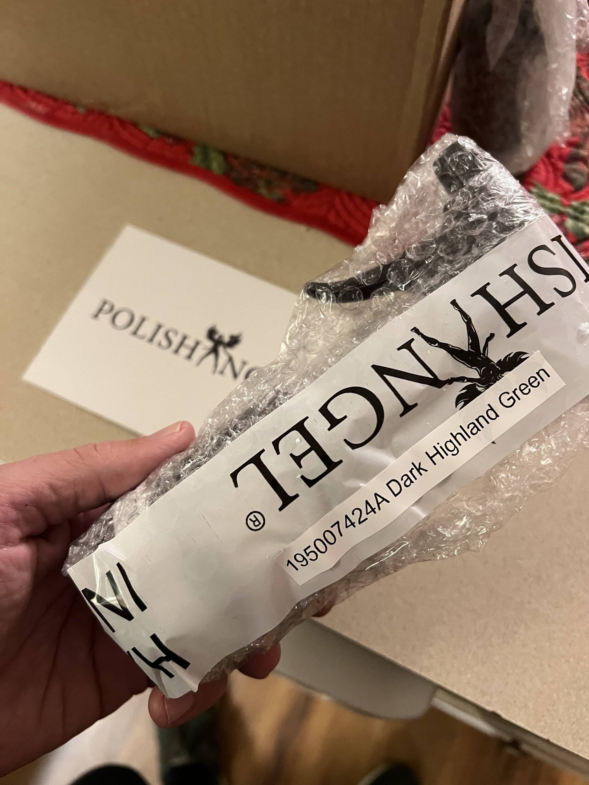

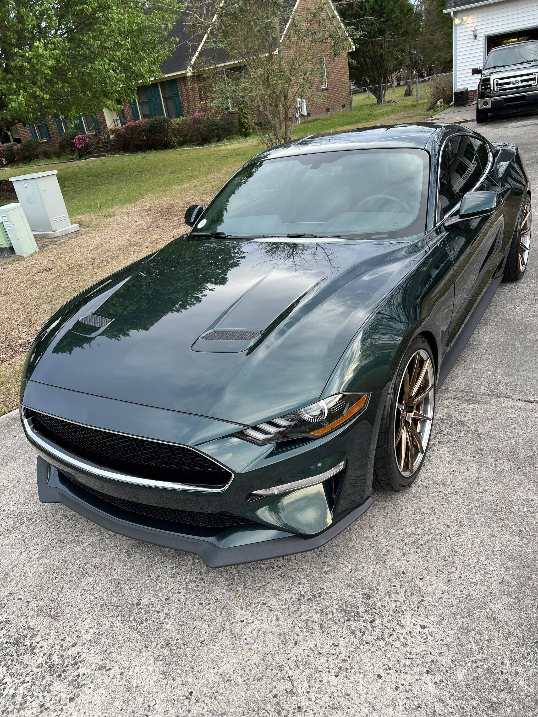

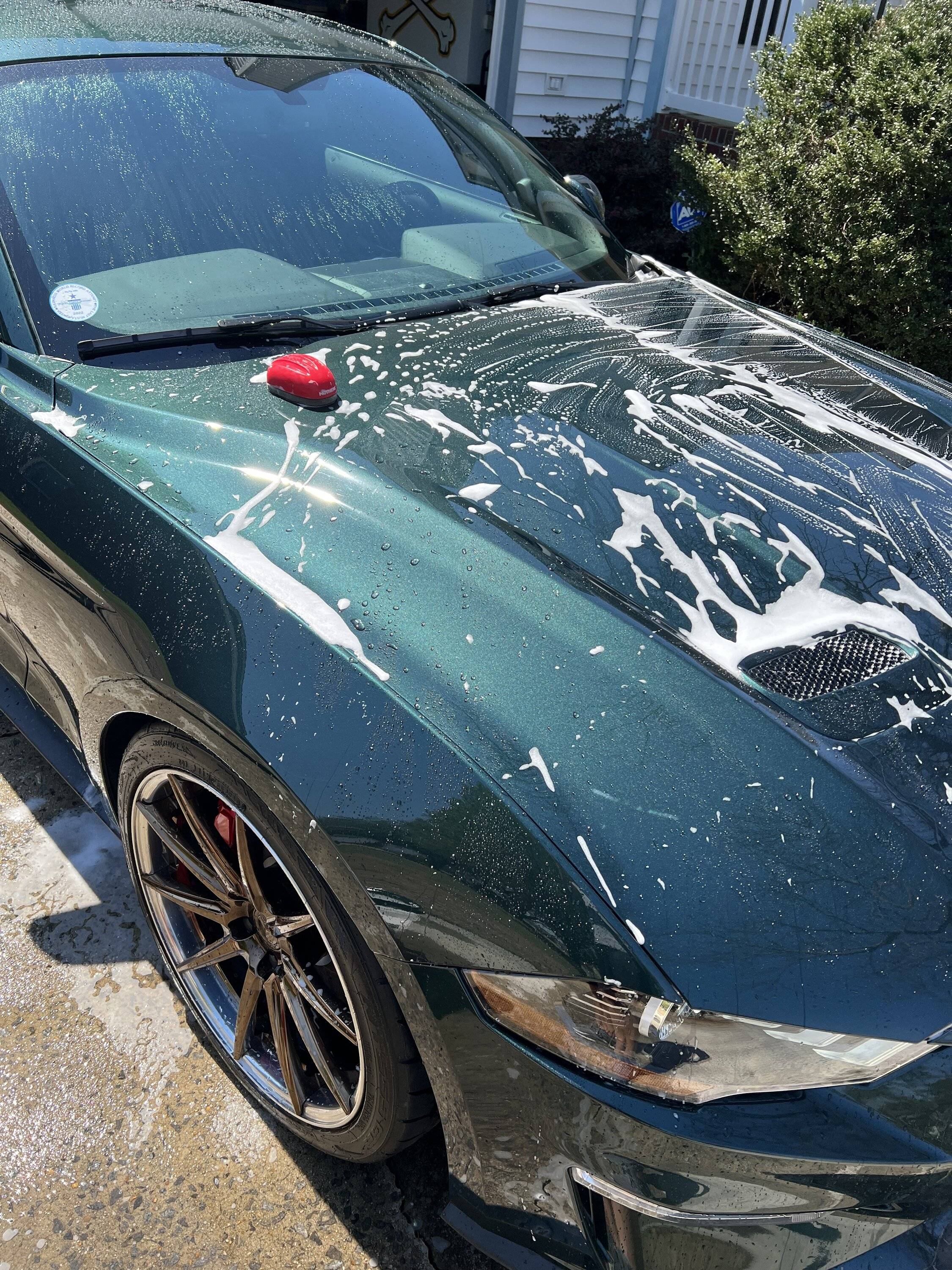

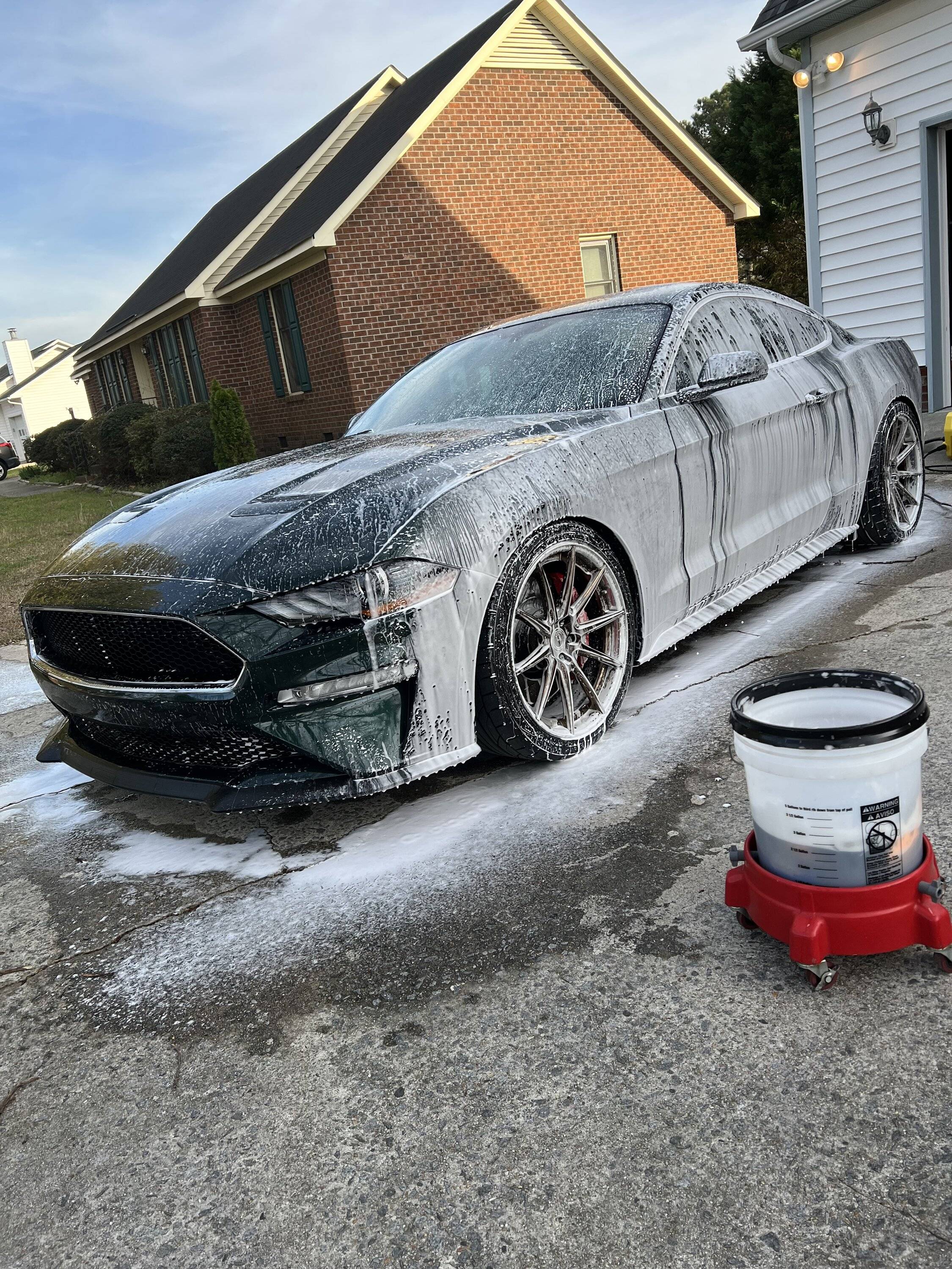

- Wash
- Wash

Oh, no, the photo's do it justice, I can tell. :clap:
Couple of favorites used there, I love using Gyeon Prep for the scent alone and Sonax Perfect Finish is pretty fantastic!
How do you like the mini Maxshine polisher?
Well done by the way, a lot of hard work there and I can definitely see that in your finished results. :like:
