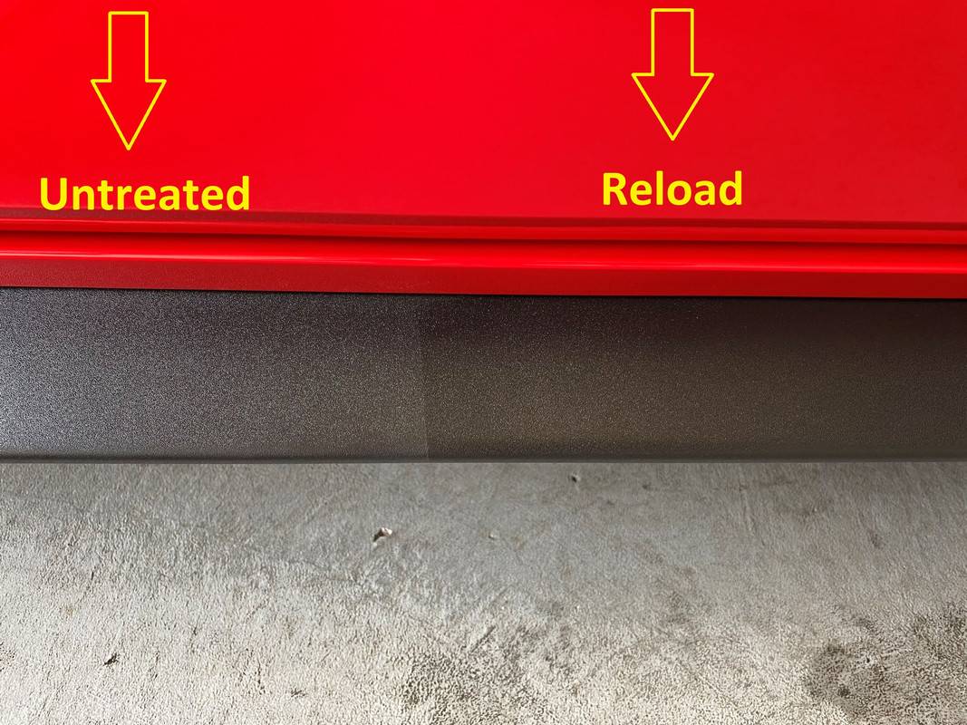

Exterior Black Trim - I have made a sideways step with this category. There are three main ways to deal with this area of the car; trim dressings (short term durability), Si02 spray sealants (medium term durability) and ceramic coatings (longer term durability).
I stopped dressing black trim after I applied a ceramic coating, Carpro DLUX, to these areas. However, I have since decided that I don't like the idea of not being able to remove these coatings from plastic like you can on paint. And trim dressings only last a week to a month at best. Which leaves Si02 spray sealants.

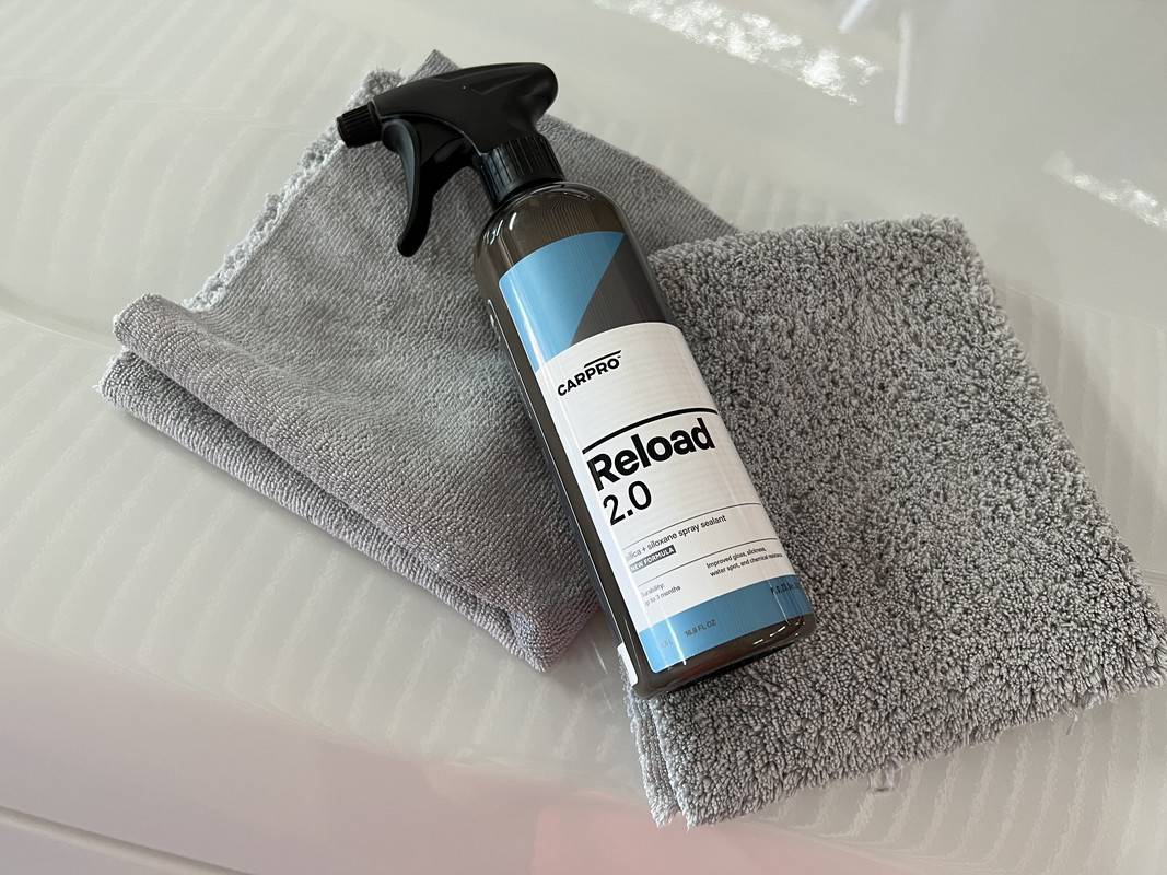

I really like Carpro Reload for trim. It won't impart any slickness or gloss to these areas, but will add a deeper, richer finish. Application is easy and doesn't require the extensive prep a coating would. Prep here would involve washing as normal, if the trim has been previously dressed, then wipe it over with Carpro Eraser to lift this out. (Eraser is good to have on hand anyway).
As mentioned, Reload is my preference, but Gyeon Cure, Obsessed Garage Drying Aid and NV Boost v2 are solid options too.

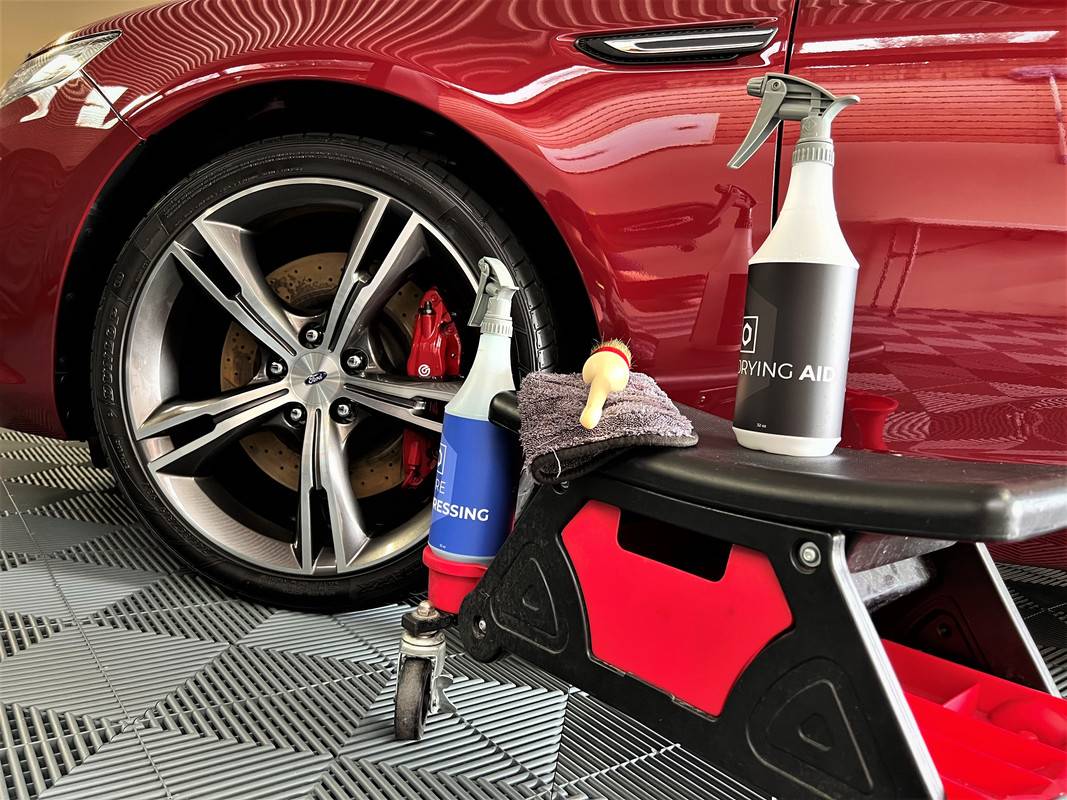

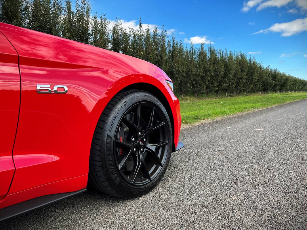

Tire Dressing - an undressed tire is just not in my nature, so here are a few low-gloss/satin dressings -
Carpro Perl - you would dilute this down and give the tires a wipe after 15 miuntes to achieve a satin finish. Try at 3:1 to start, go out to 5:1 if needed. You will also want a suitable spray bottle to put the diluted product in. Carpro Dilute make it easy.
Get CarPro PERL Surface Coating | Waxit – Waxit Car Care
CarPro Dilute | Waxit – Waxit Car Care
Obsessed Garage Tire Dressing - you would apply this thinly and buff down after 15 minutes to achieve a satin finish. Ready to use.
Obsessed Garage Tire Dressing (detailingshed.com.au)
Meguiar's M40 - a strange option, but one that will deliver the desired look with no additional buffing.
Meguiars Mirror Glaze Professional Vinyl & Rubber Cleaner + Conditioner 473ml #M4016 | AutoMegaStore Australia

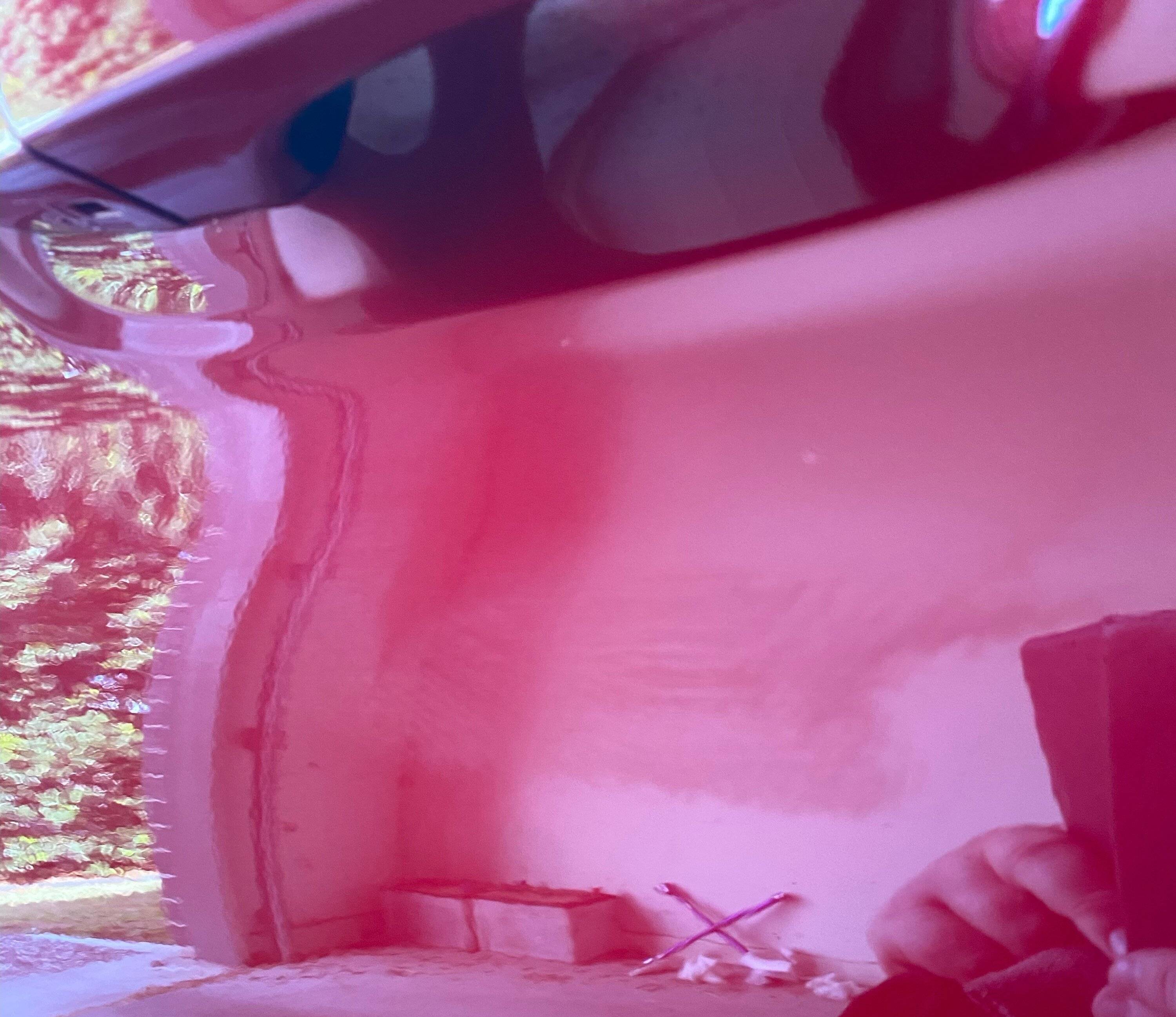

I also noticed this area under my driver side door handle. No idea what this is. It feels rough, and won't rub off. Is it maybe the ceramic coating wasn't applied/wiped off correctly?

Looks that way , i'd take it back to your detailer . Likely need to be polished out and re ceramic .

Being Gtechniq CS Ultra I believe it needs to be sanded? I will let him know when I take it back for the front bar. He wouldn't coat it as it had been resprayed and it needed to wait a month or so before being coated.

Yeah light sand possibly with some 2000ish grit
