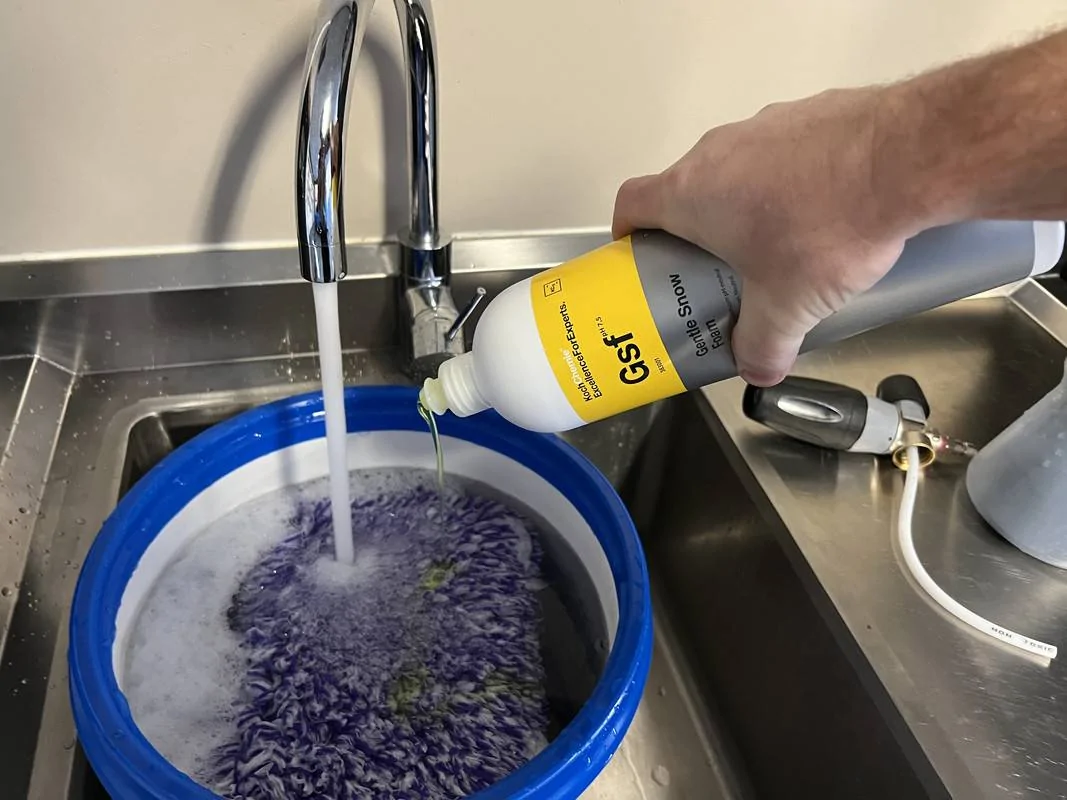

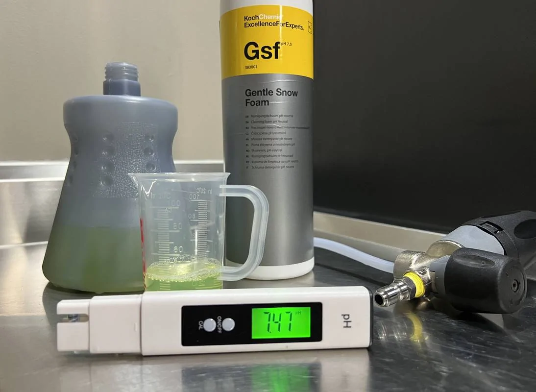

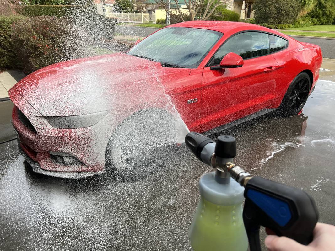

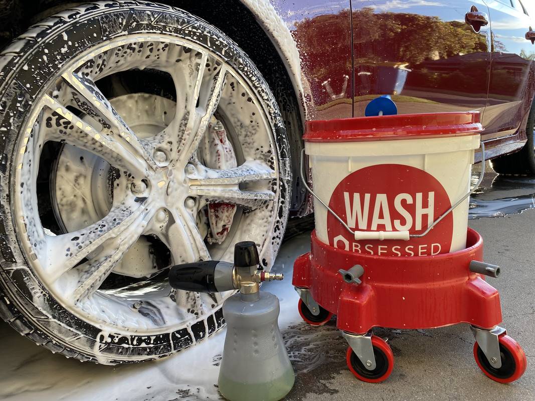

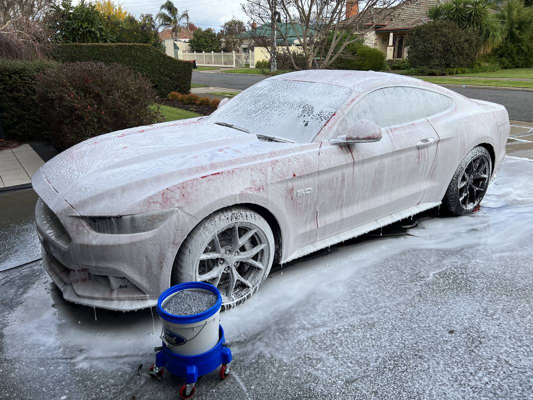

GSF (Gentle Snow Foam) - I would challenge anybody who didn't fall in love with this soap. It really does tick all the boxes, pH neutral, cleaning ability, foaming ability, slickness and lubrication, scent. It's that last aspect that really impresses, the cherry fragrance is addictively excellent. Can be used in a bucket or foam cannon. I even use it to clean my wheels. Yes, its up there in cost, but its worth every scent in my opinion.
Koch-Chemie - Gentle Snow Foam | The Rag Company

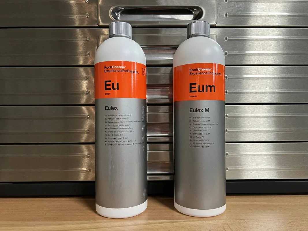

Eulex - this is strong adhesive and tar remover. You won't use this often, but it's certainly good to have on hand for those occasions when nothing else will get the job done. Use with caution and rinse or neutralize thoroughly after use.

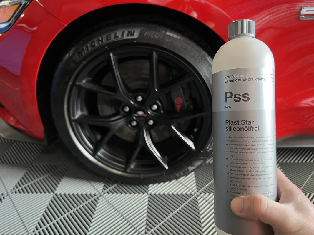

Plast Star PSS - a tire and exterior plastic dressing that seems to have decent longevity. It applies quite wet but finishes down to a dry, semi-matte finish.
Koch-Chemie - Plast Star Silicone-Free | The Rag Company

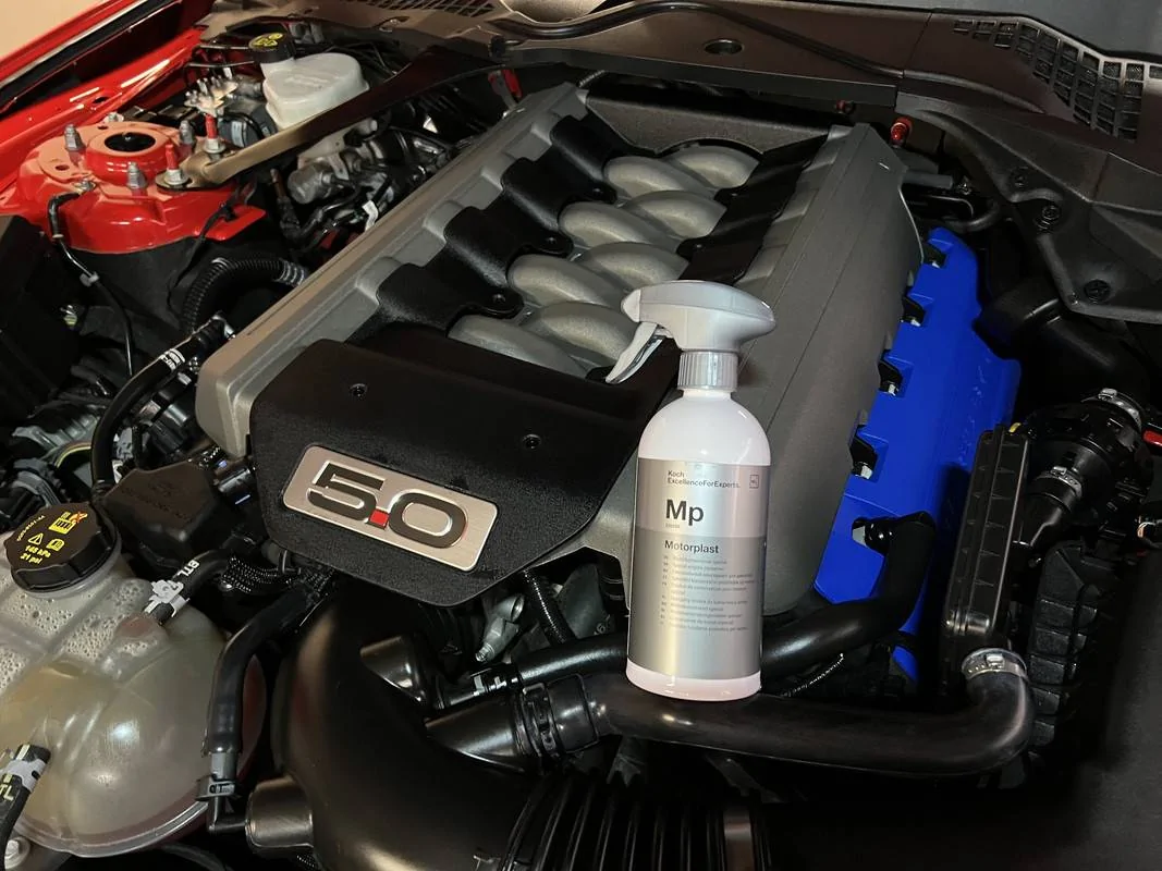

Motorplast - a product used to enhance and protect engine bay plastics. It can be applied to a wet or dry surface and is self-leveling, meaning that as it dries, it doesn't necessarily need to be wiped down.

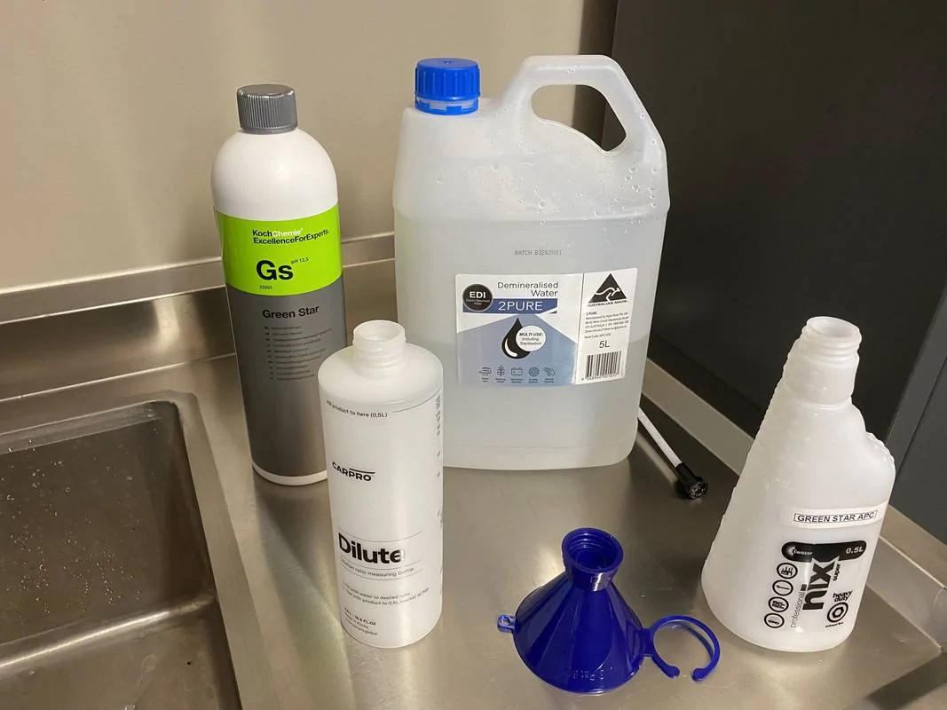

Green Star - I don't use much APC, but it's certainly good to have on hand. This product is dilutable to safely suit the cleaning requirement.

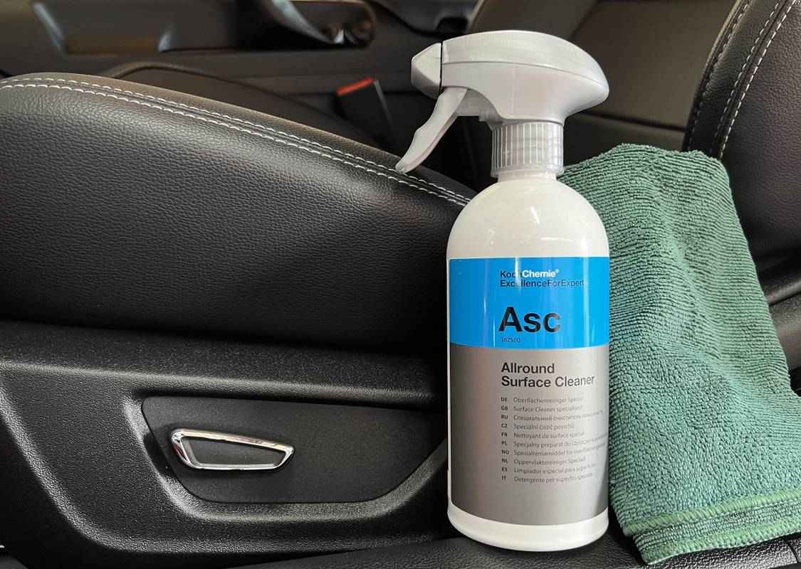

Allround Surface Cleaner ASC - an interior quick detailer. This can be used on all interior surfaces to remove dust, fingerprints and light soiling. Leaves a matte OE finish behind.

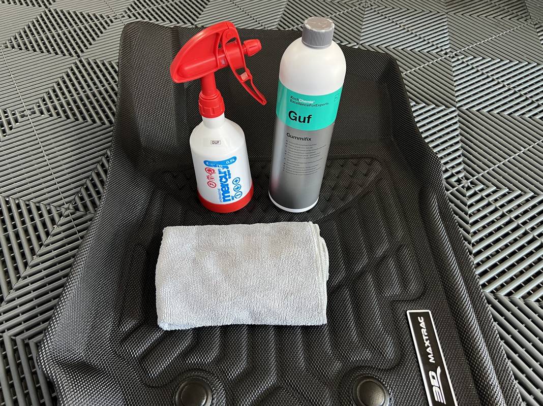

Gummifix Guf - this is a very specific product used to dress rubber floor mats and cargo liners. In most cases, it's not a good idea to dress these items, but Guf was designed to offer an enhancement without making the surface slippery.

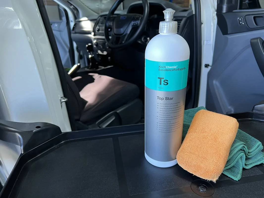

Top Star TS- If you like applying an interior dressing, then this is a very nice product, offering a natural OE looking finish.

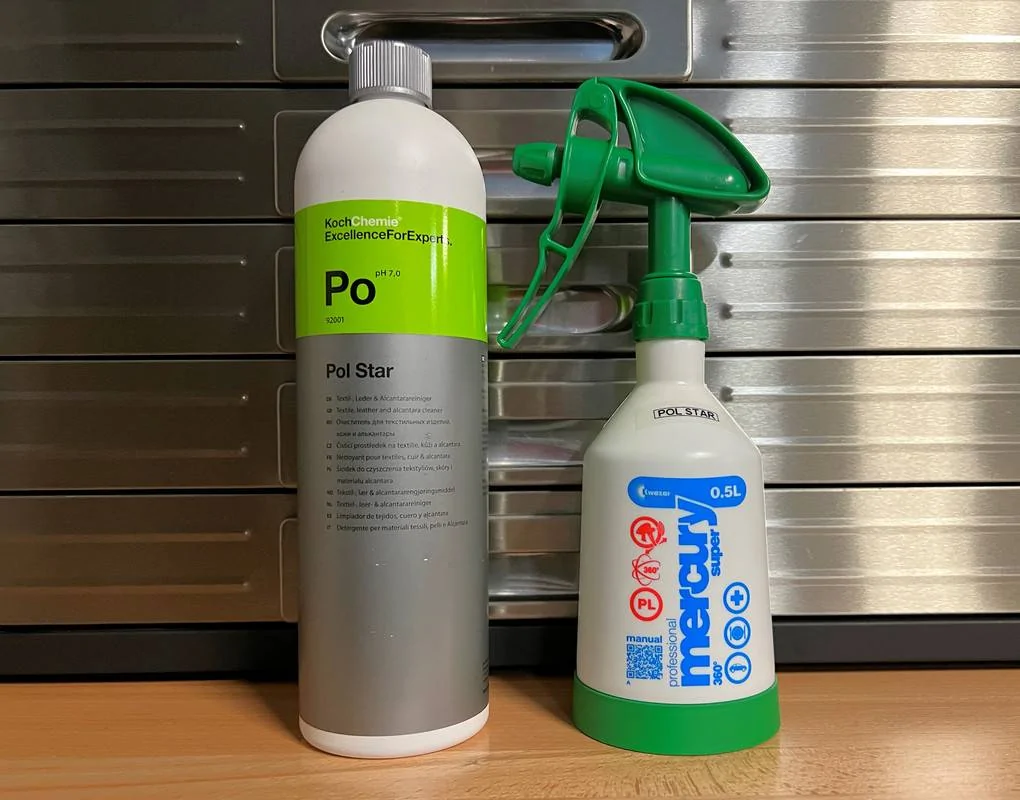

Pol Star PO - a safe interior cleaner that can be used on plastic, carpet, leather and cloth trim. Like Green Star, it can be diluted to suit, making it super economical as a leather cleaner, and has the ability to remove stains from carpet and cloth. Unlike Green Star, this product is pH neutral, making it safer to use on interior surfaces.
Koch-Chemie - Pol Star | The Rag Company

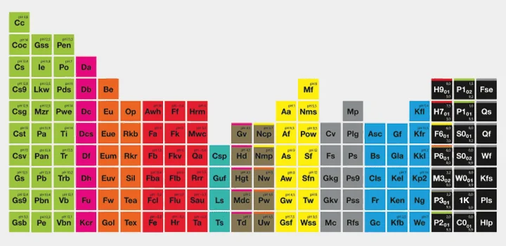

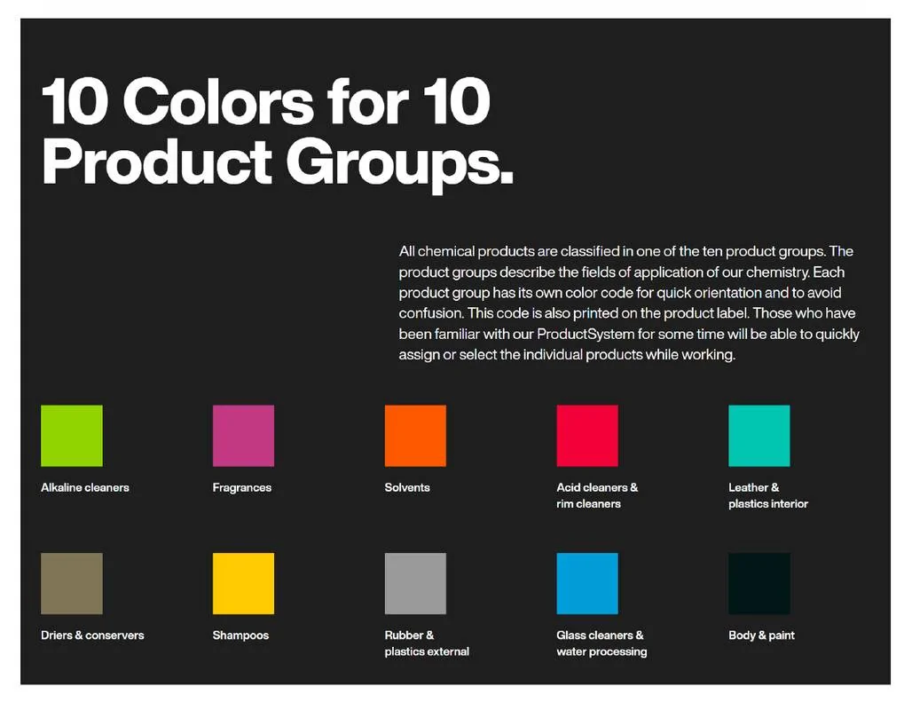

What I also like about the Koch Chemie brand is that despite the large product range, the branding is color coded to make selecting products easier to understand.

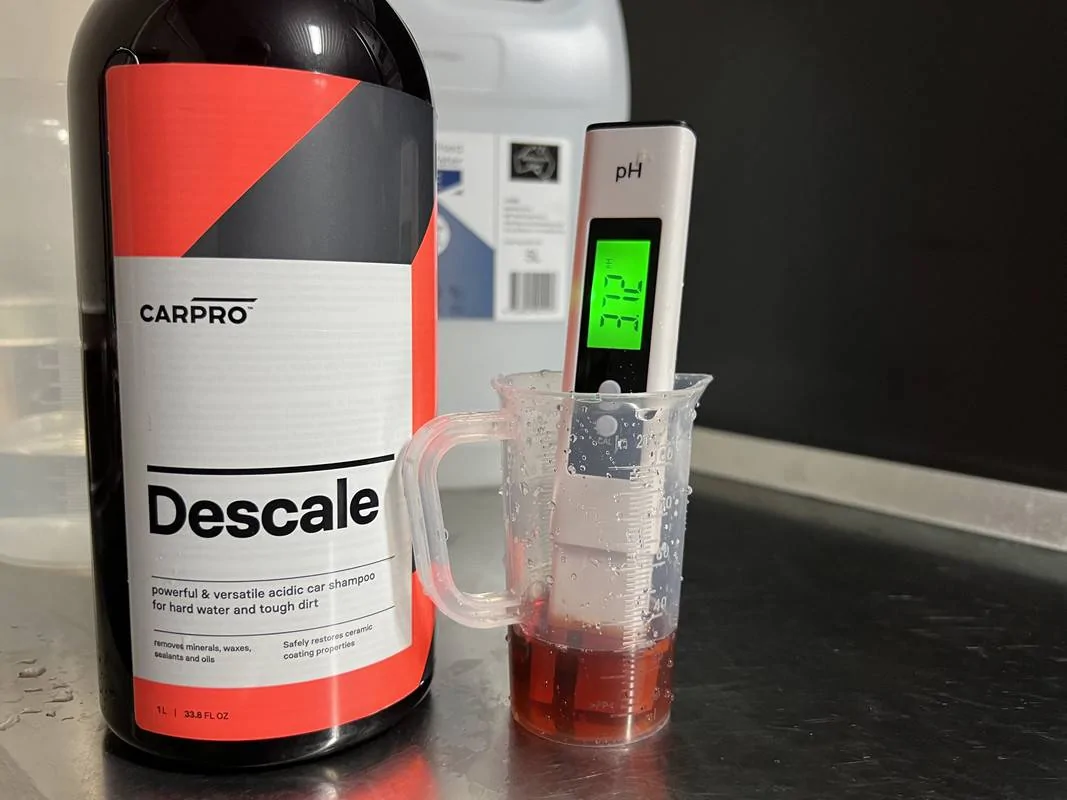

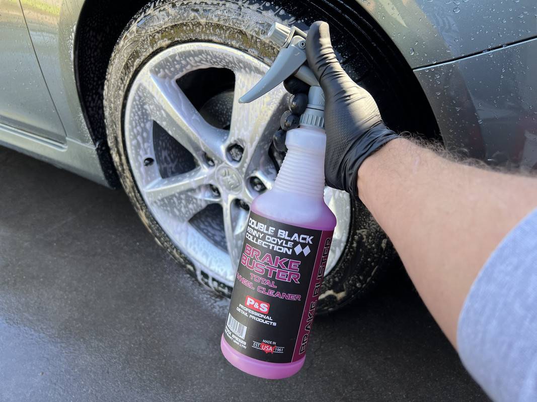

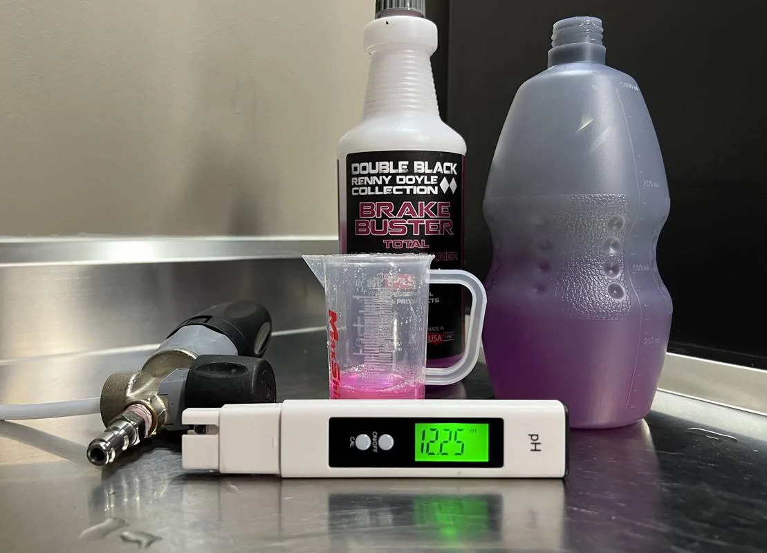

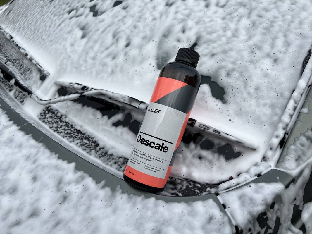

A complex question that needs some basic understanding of the pH scale.
When a cleaning product leans either side of neutral (7.5), it becomes more aggressive and targets particular types of contamination.
Acidic - in theory this is when a chemical tests below 7.5, but most products termed acidic are below 6.0. An acidic product can be desirable when dealing with mineral deposits, often seen as water spots. The acid helps neutralize the minerals that cause the etched water spot. An acidic product will also strip and remove previously applied waxes and sealants. Most ceramic coatings have an acid tolerance down to about 3.0.
Acidic products are pretty rare to be honest. Most wheel cleaners were once acidic, but that has become exception these days. Think Meguiar's Wheel Brightener. Some iron removers are mildly acidic (6.5), while Carpro make an acid leaning soap for helping decontaminate a ceramic coating. Descale is a brilliant product by the way, something very useful to have on hand. Notice how it sits just above the threshold for acid tolerance, meaning that it can be used safely and effectively.
Neutral - a pH neutral product is important for when using a chemical frequently, interior cleaners and exterior soaps for example. In this case, that neutrality is less aggressive, meaning it won't degrade waxes and sealants or dry out or damage rubber trims and plastics.
Most iron removers are considered pH neutral. Certain interior cleaners are pH neutral to avoid damage, think P&S Express or Koch Chemie Pol Star. This is particularly important on leather, don't use APC for this role. Maintenance soaps are also generally pH neutral.
Alkaline - in theory this is a chemical that tests beyond 7.5, but most alkaline products sit at 8.5 and beyond. Alkalinity is desirable in removing greasy and oily stains and will degrade or remove waxes and sealants. Most ceramic coatings have an alkalinity resistance up to about 12.0.
Most "non-acid" wheel cleaners are alkaline in nature, likewise, tire cleaners and All Purpose Cleaners (APC).

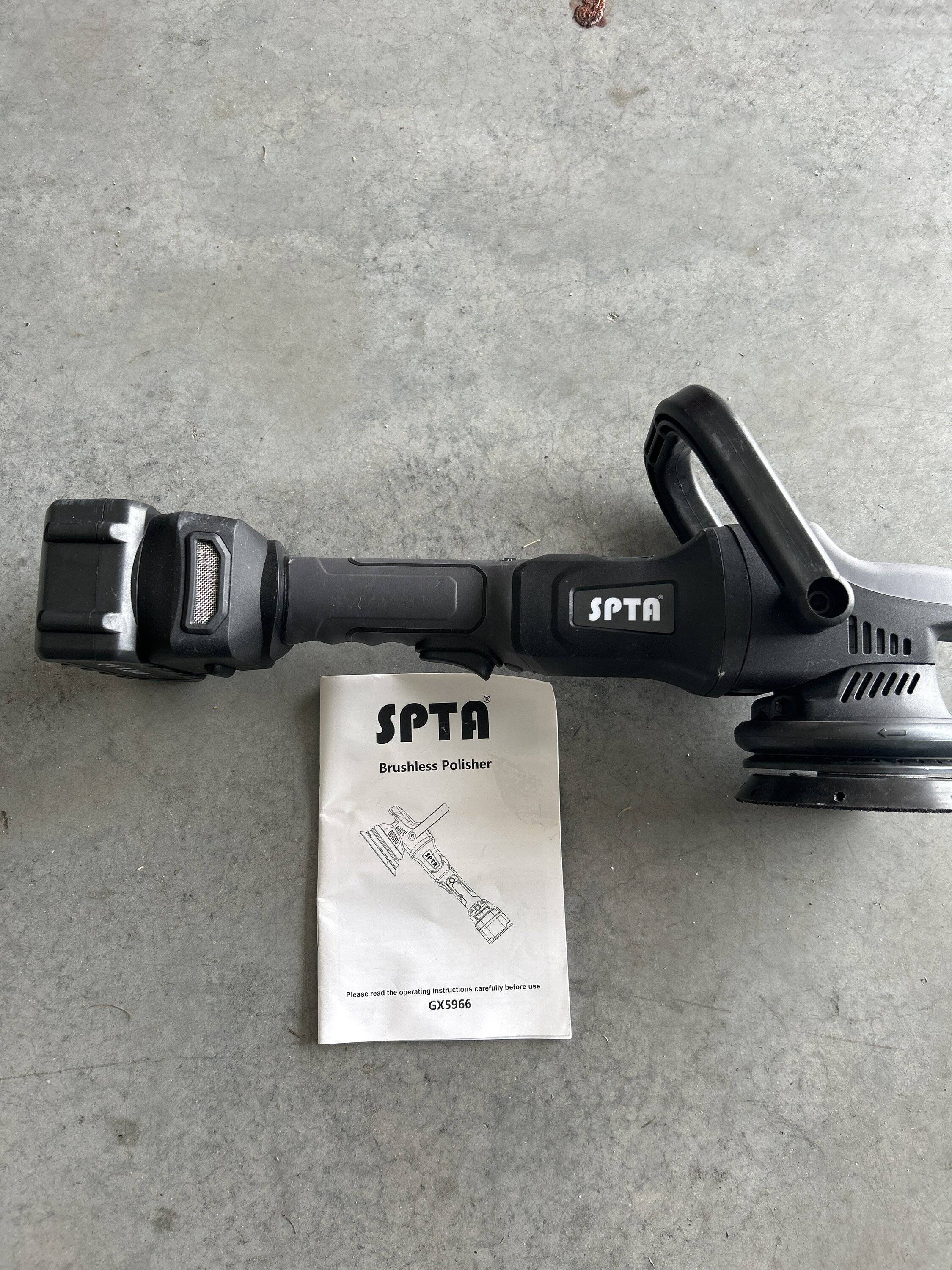

What polisher did you buy?

The SPTA model GX5966
