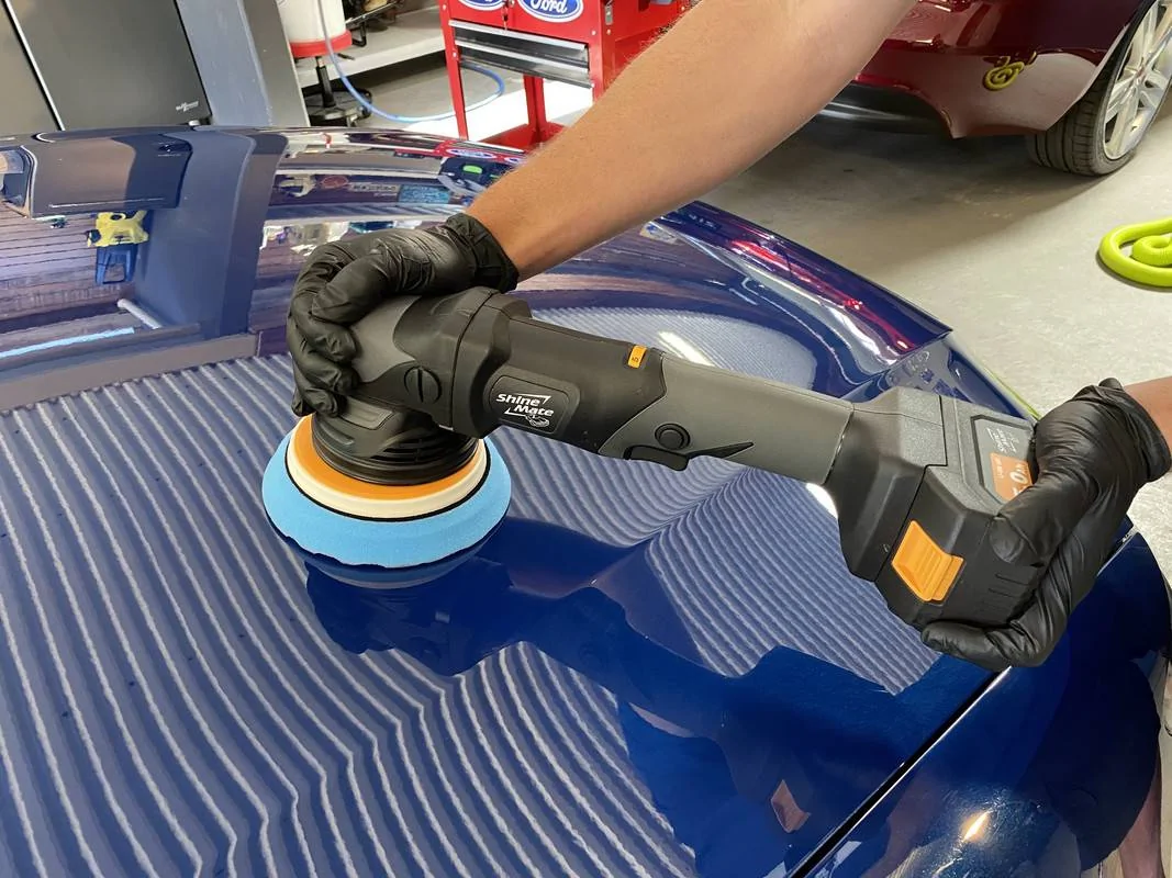

Shine Mate EB351-5/15 –
This is a battery powered unit that offers superb ability without having to manage a cord. I have this machine and really enjoy using it, battery life is not a problem when cycling between at least two batteries.

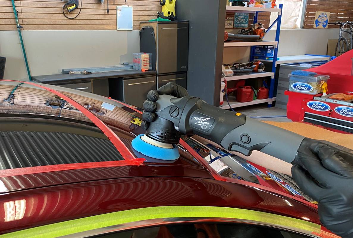

Shine Mate EB351 3/12 –
This is the 3 inch version of the battery Shine Mate listed in the previous category and uses the same battery system. I find I grab this machine more than I thought, its also good for restoring headlights.

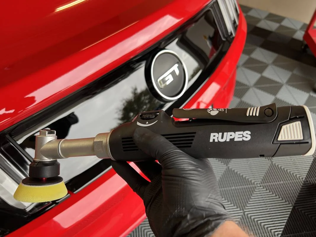

3rd – Micro Machine
At this point, you are getting into the luxury level of polishing, as in machines that are just nice to have. The 1 and 2-inch machines are going to cater to the tight spots that would be mostly done by hand. Think door sills, around badges, intricate wheels or even interior trim polishing.
Rupes iBrid Nano Long Neck –
A very highly regarded mini polisher, impressing with it’s versatility and smoothness. This can be used in rotary mode, 3mm orbit D/A or 12mm orbit D/A. The only thing the counts against this machine is the price.

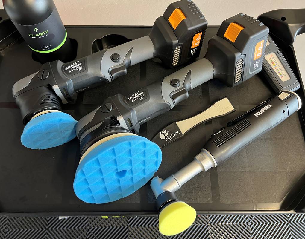

Obviously, there are other options to consider, including rotary, pneumatic and forced rotation dual action machines. But largely, the first and second steps will get you 98% of the way, the last 2% would be covered by hand or with a micro machine. Happy shopping!
