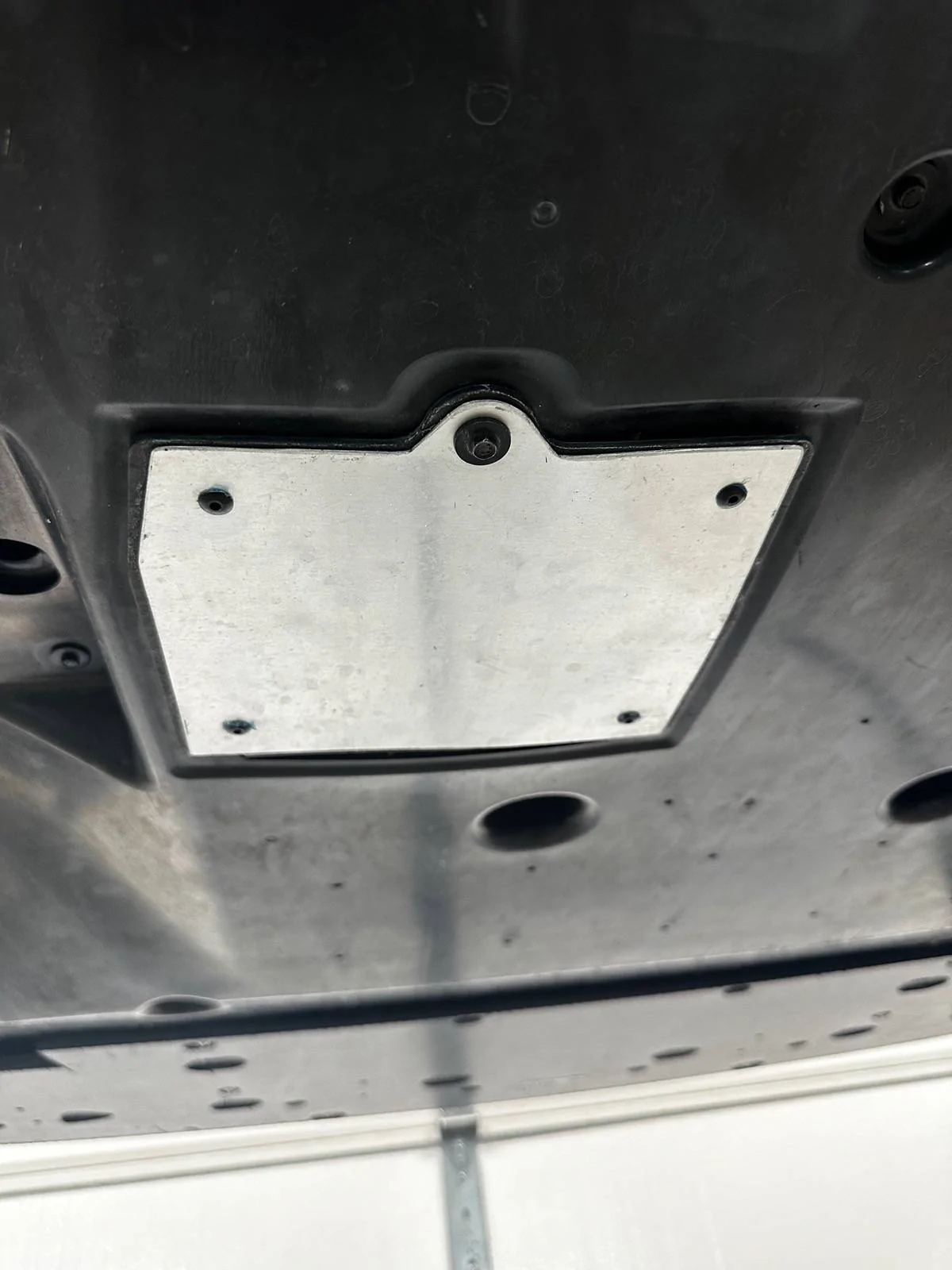

Don’t buy another one, it will just warp again from the heat. I also tried heating it up and shaping it. But it will always warp again.
I took some thin gauge aluminum sheet from Amazon, shaped it, rounded it and bent it to fit nicely. I used some rivets and attached it to the existing plastic door. I’ll put some pictures up when i am home.
Here’s what I ended up doing to mine.
