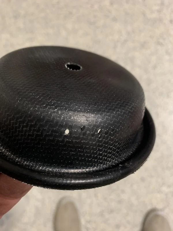

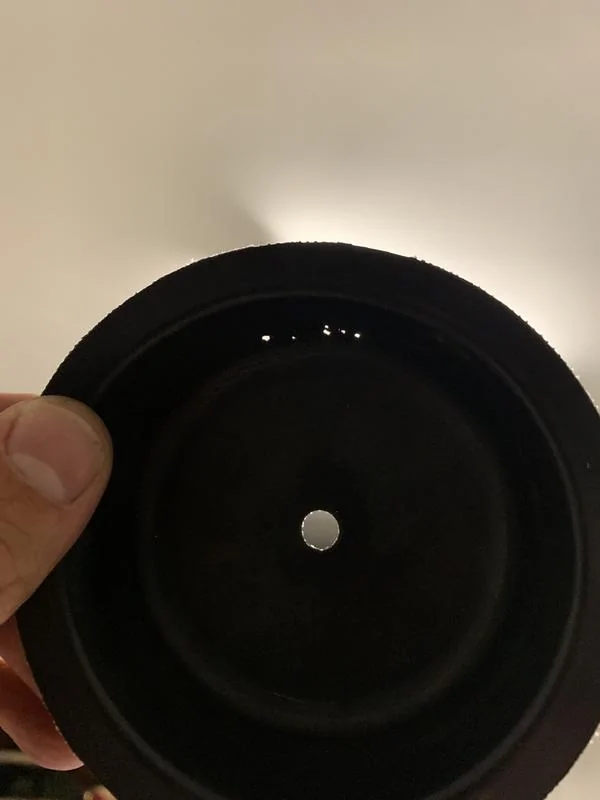

Just a little heads up to anyone running the Vortech BV57 BOV. Mine started making a muffled sound about 2 weeks ago, sounded like it wasn’t releasing boost properly when coming off the throttle at higher RPM.
I pulled the BOV, opened it up and found the internal diaphragm had failed, with multiple tiny holes developing.
Only ran on the car for 18 months/ 5000 miles.
$60 replacement diaphragm later, she is running like a champ again.
Pics:

I think im dealing with this exact issue. where did you purchase the part?
Thanks

I phoned Vortech and ordered over the phone. Part 8D003-091, DIAPHRAGM,BYPASS
