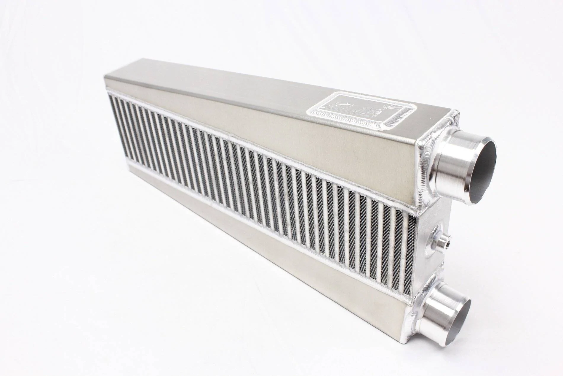

I’m not so sure that there would be a large drop. The core is as large as many companies but at 4” thick instead of 3” like most companies

You'd think, but they are of a rather thick internal bar and plate design. Heavy thick, durable, cools the most out of all designs, but also has the highest pressure drop. Vertical flow tube and fin is usually the best design for ample cooling and the least pressure drop. Many have inlet/outlets on the same side because of design, but there are some that have end tanks of each side as well.

The pic you posted is a bar and plate unit.
