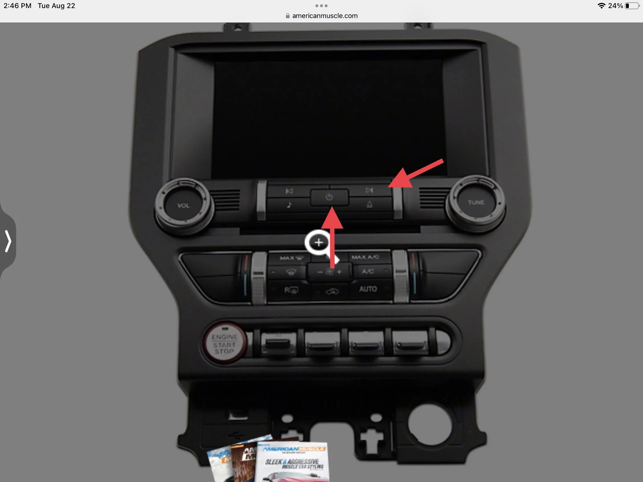

Try a reboot guys. I’ve had my radio freeze up several times and this is how I reboot.
- Press and hold the two buttons with the arrows pointing to them (at the same time) until the screen goes dark. Several seconds later the screen will power back up and it should be working normally once again.
