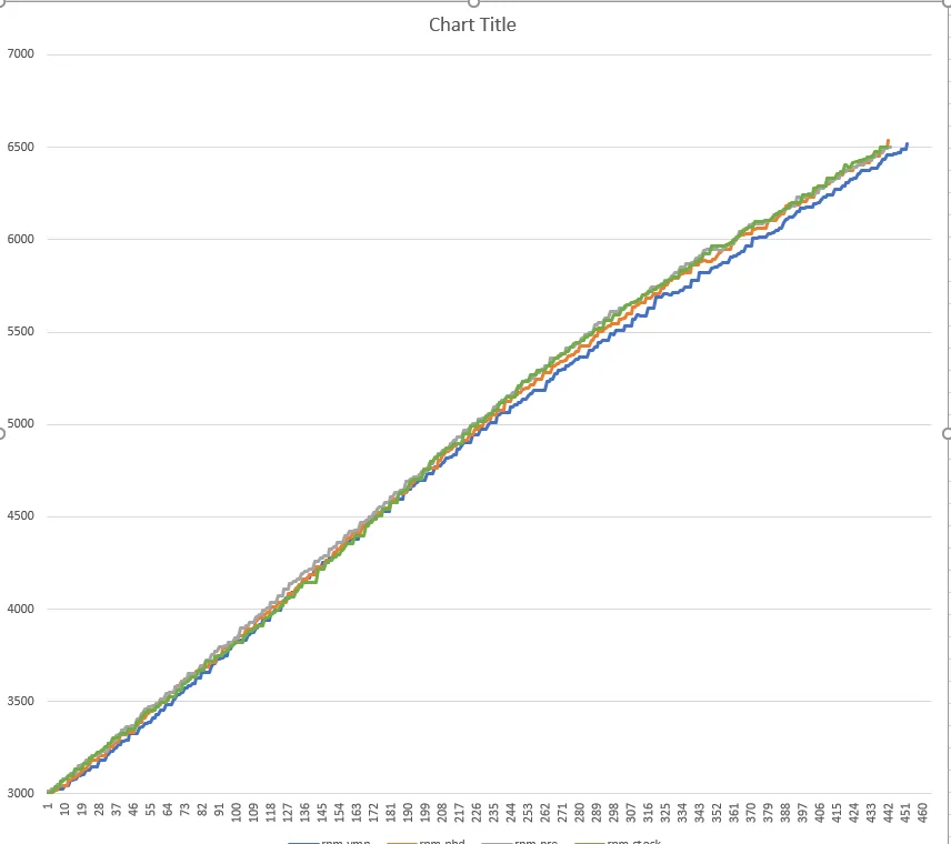

I have a 93 VMP tune on a 16 GT. I have done MANY data logs from 3000 to 6800 and then pulled the data into excel to graph. It is always a little slower then stock. I then got Pbd. No gains over stock. I actually put back to stock with a pedalmax. Like it the best this way.

I did not go to a dyno. I did data logs on the same road with all my tunes. Then took the Data time to go from 3000 to 6800 and charted it. Virtually no difference and vmp always a little slower. Vmp and Pbd also used and was tuned for an 18 airbox.
My original suspicions held true. A stock engine really has no room for gains. Maybe maybe a very small amount. For street driving I so wish I spent the money on suspension instead.

It does look better. But still only about a 2% increase. If I translate that to acceleration that means I get from 3000 to 6800 rpm about .1 secend quicker. Nothing I'll ever feel on the street. Might a see a little at the track though.
Also the preloaded 93 tune from sct always was a very little better then Pbd too.
