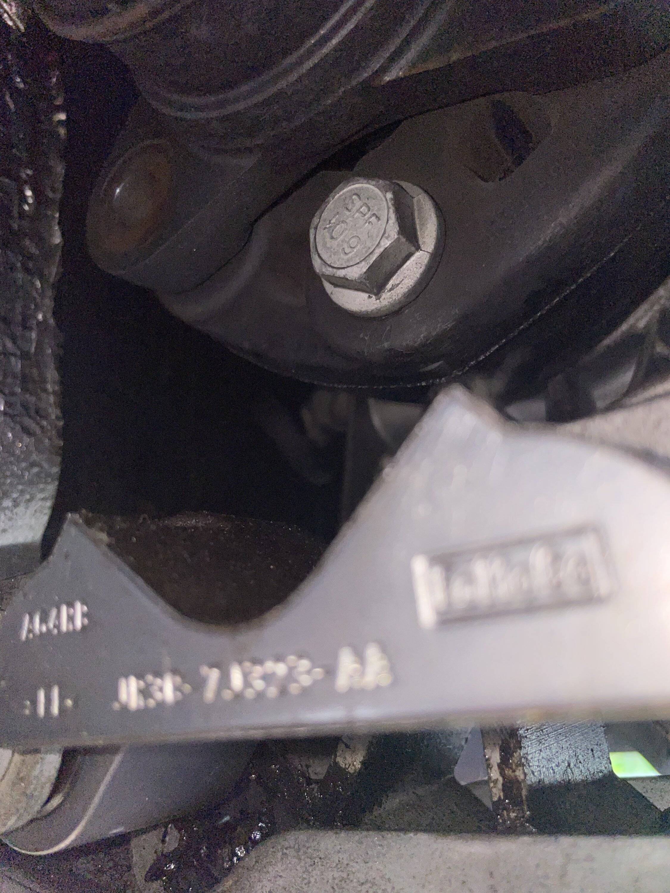

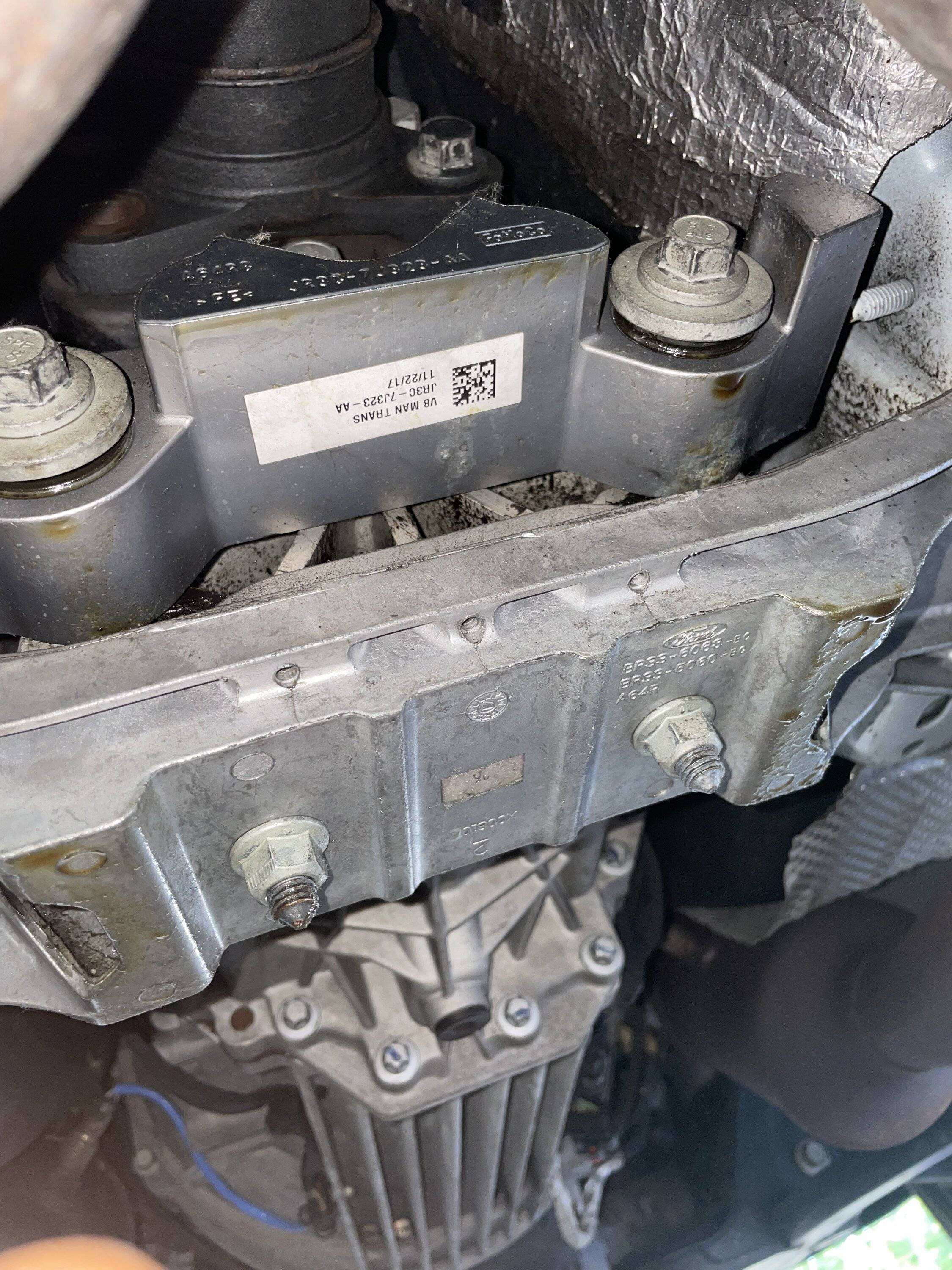

I had some time to get under the car today, so far I found two issues I’ll start with. There’s a bolt missing from the top of the driveshaft and there’s a leak on the trans mount but I couldn’t find where it was coming from

Whatever you do - don't go driving it anymore with a missing driveshaft bolt. If one is missing that's an issue of itself... because driveshaft bolts shouldn't just be falling out.... check torque of ALL other remaining driveshaft bolts.
Driving around like that will and can lead to detrimental failures of either driveshaft, cracking the gearbox case, or worse case scenario, cracking/damaging the engine block.
Was that trans ever serviced before? Maybe it's me, but the trans mount bolts (to me) look like they have been R&R'd by someone and not just the initial assembly line install... Usually initial factory assembly, the heads of bolts don't look tampered, because almost every one is installed by either a bot or a person using a specified tool with predetermined torque settings that won't mar the bolt heads.
It seems likely to me that the vibration is caused by the missing bolt on the driveshaft flange.
The sudden appearance of the vibration is likely due to the bolt falling out IMO.
It would cause an unstable coupling that would vibrate under certain load and speed conditions.
I think this needs to be remedied right away.
Dropped the car off at a dealership yesterday, they said they should be able to get a look at it today. Not while I’ve had it, and I can’t find the previous owner’s service records at the moment. I also noticed those bolts when I was showing another mustang owner so hopefully the service records will show something that ties to that.

Missing bolt, unbalanced driveshaft, vibration at the yoke let oil past the output seal, that's my guess on the leak.

I bet your exhaust is touching the trans crossmember under load. It makes a hell of a noise, but it's an easy fix.

The dealership was really back up so it took a while for them to get it on the lift. I’m not sure if it was service from the previous owner or maybe when I got my 30,000 mileage service, but a tech left the nuts on the trans mount bushings loose and then there was also the bolt missing from the driveshaft. After addressing those issues the car drives completely fine
