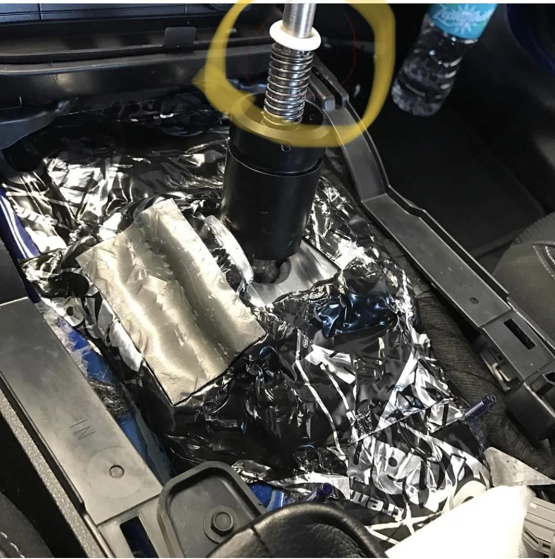

After you have checked the install and make sure there is nothing loose, then I have a solution for you to quiet it down.
TJ is correct the nvh levels are same to stock, however when you are pushing the car then the NVH are slightly higher but nothing to be concerned about like in your matter.
Look at the photo I have posted. The yellow highlighted area has a white ring make sure that is in place or else you will hear somewhat buzzing noise, if that is there make sure the black collar is sitting properly. Once you have checked everything and it is all good, then follow the steps with the dynamat and lead sheets.
You have to purchase lead sheets and also get some dynamat.
I know this will sound excessive, but it actually made the noise much more quieter than stock and also the shifter “felt” stiffer in a way as well.
apply dynamat around the entire shifter as you see in the photo, than tightly mold the lead sheet around the dynamat, and then apply dynamat over the lead sheet and do this about 4x and your transmission noises will be completely dead quiet. Please be careful using lead and wear gloves.

And that’s exactly why I asked about grabbing the lockout. I did the exact same thing. The white collar had stuck itself into the boot on removal, fell out before install.
Hence, had no idea it existed until I found it on the ground...and the noise :facepalm:
