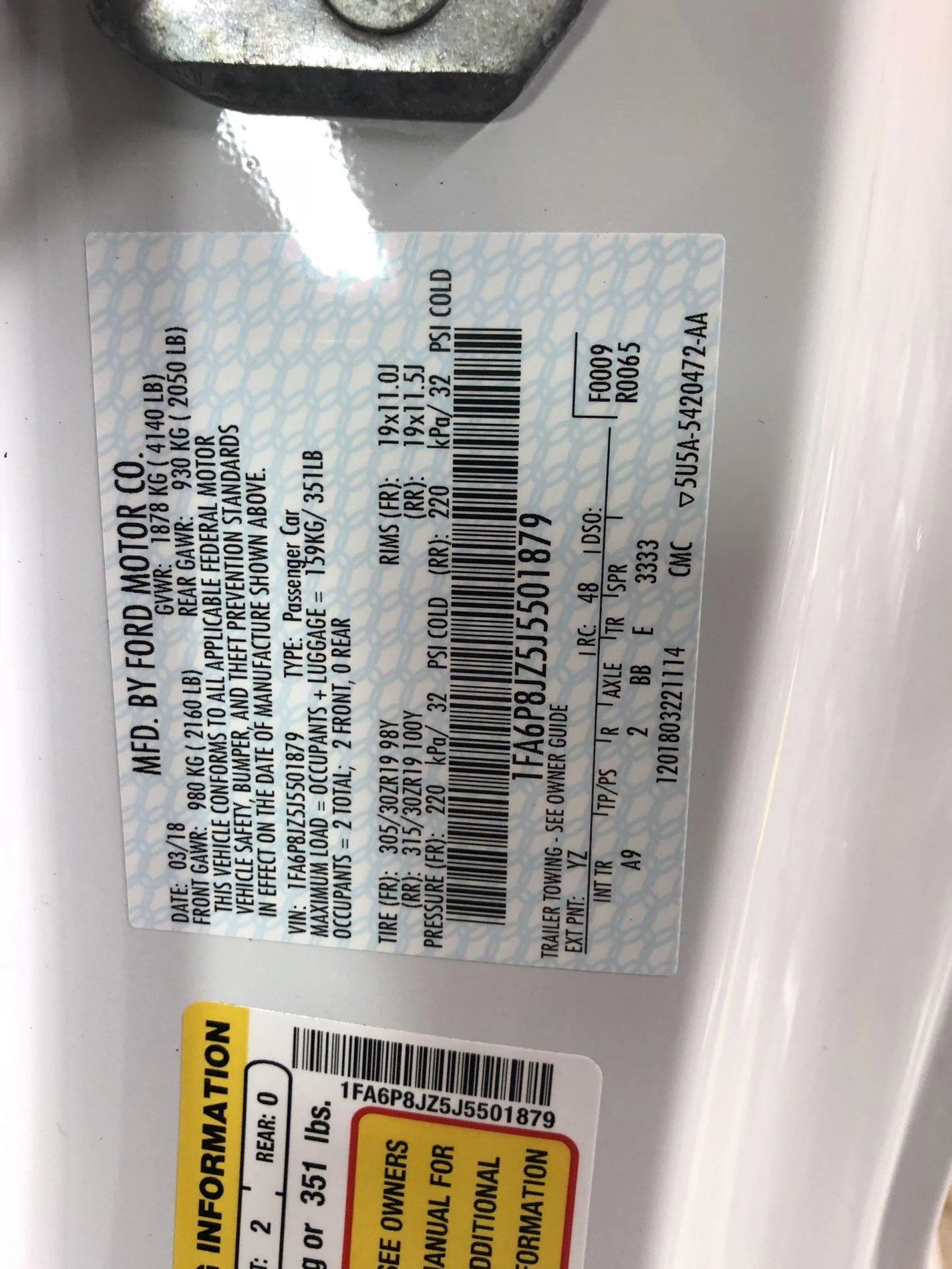

I’m interested in knowing if the 2015-2019 GT350R has a unique vin number.
What I mean is back in the day they had “R” code cars.
I once had a 1963-1/2 R code galaxie 500 427 R code car.
Does the new GT350R vin show anything stating it’s a R?
My 18R doesn’t seem to.

The older MY Rs started with 1FAT (vs 1 FA6 which was used for the non Rs). Cant remember when this was introduced. MY18 I think. Once this was introduced, I don't think there is a code differentiating between the 2 models.

Anyone that has a 2015, 2016 or 2017 R model the 4th digit in the VIN namely "T" indicates that they have an R model as the "T" indicates a vehicle with front safety belts, front air bags and a 2 passenger vehicle.
For some reason for Ford decided to replace the 4th digit for the 2018 R models with a "6" instead of remaining with the "T" as was the case for the first 3 MY's.
Regardless if you have a 2018 GT350 or a GT350R the 4th digit in the VIN will always be a "6" and have not found anyone at Ford who can provide me with an explanation as to why the change for 2018?
I would expect the 2019 R models to go down this same path but who knows and Ford may go back to a "T" for the 2019MY for all R models but expect not.
