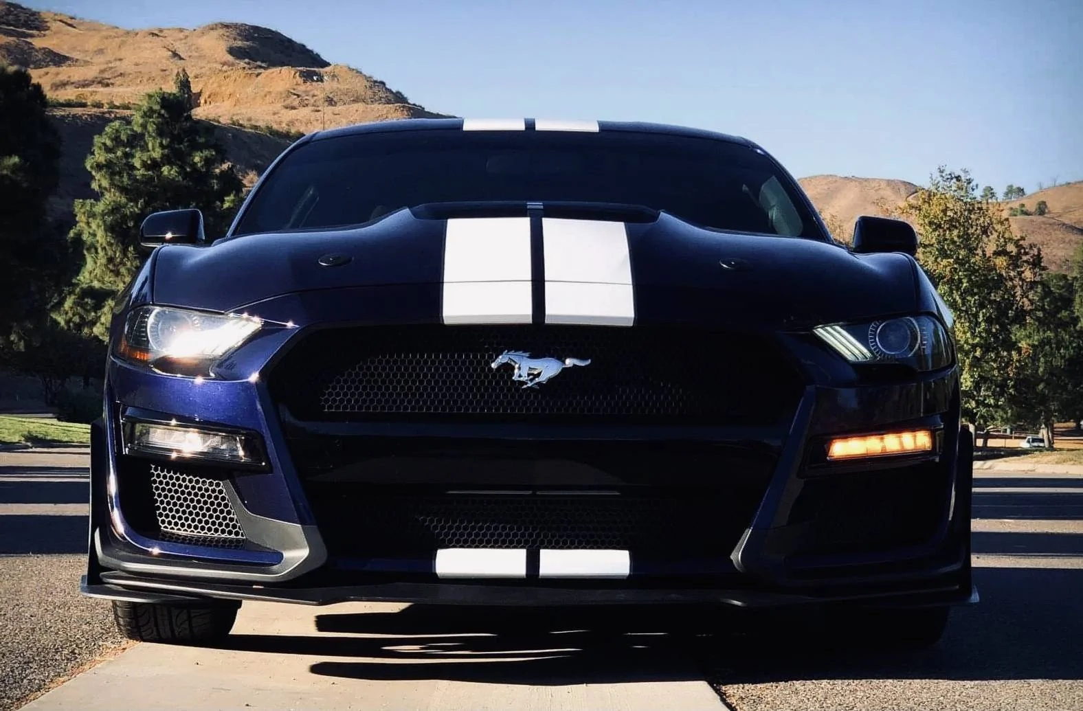

Are these Big Worm? If so are they narrow or wide?
Yea, they are big worm, they’re 7” I believe. I dunno if I’d recommend Big Worm though. The stripes were not cut straight at all. Thankfully I got the pin stripes because the outside edge was cut all wonky and the shop had a hell of a time hiding it. The section that was in the roof was completely unusable, so they had to make their own that matched the hood and trunk lid because the section Big Worm sent for the roof was so janky

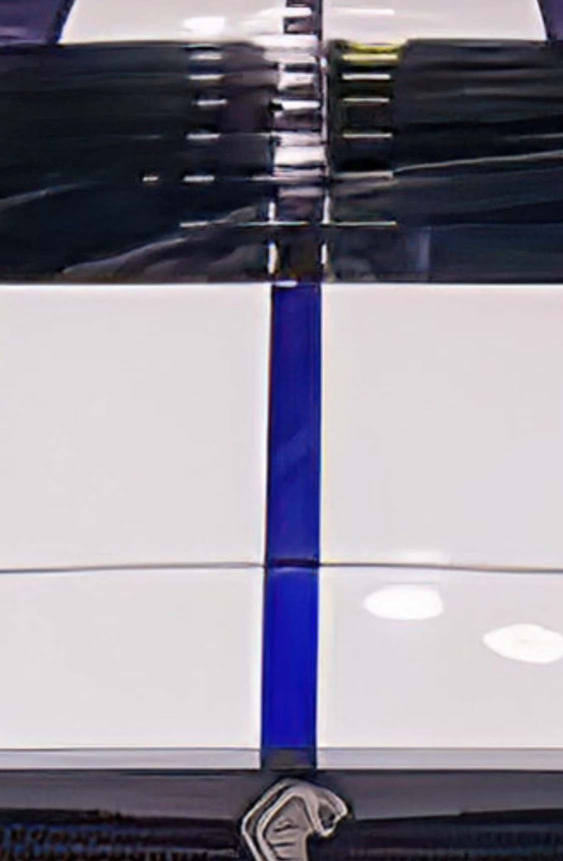

Also, I told the shop to center the tripes on the center support for the louvers on the hood. I have seen some people put stripes on their cars and they don’t line up with the louvers and it drives me crazy

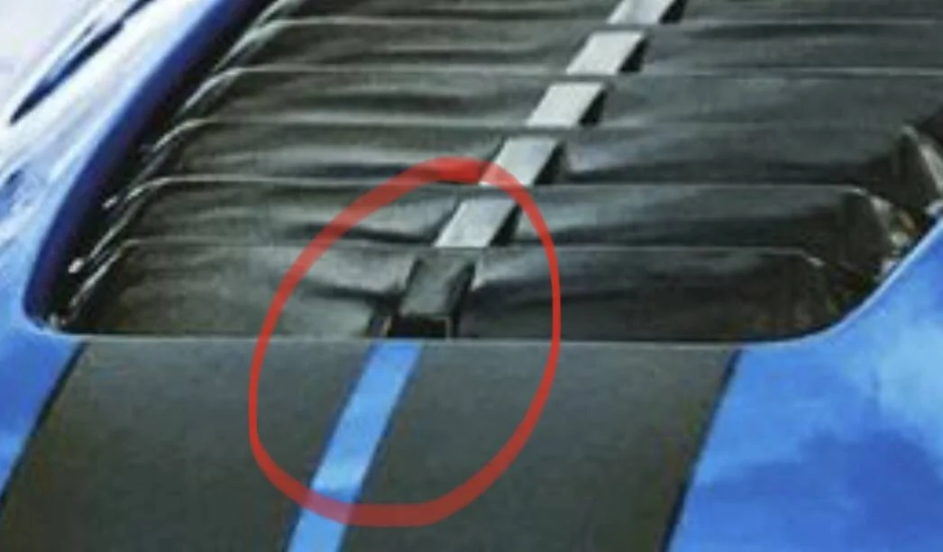

Yea, see… THIS bothers me… these are photos of someone else’s cervini hood and the stripes aren’t lined up with the center support on the louvers. I would have had them redo it if it came out like this. I was VERY specific about it when I dropped my car off. I think the spacing between the stripes is suppose to match up with this support perfectly.

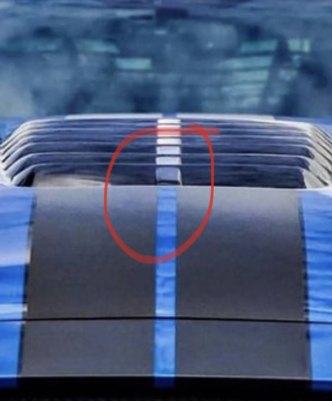

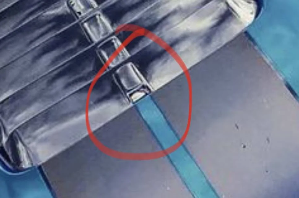

This is how it’s supposed to be on the GT500

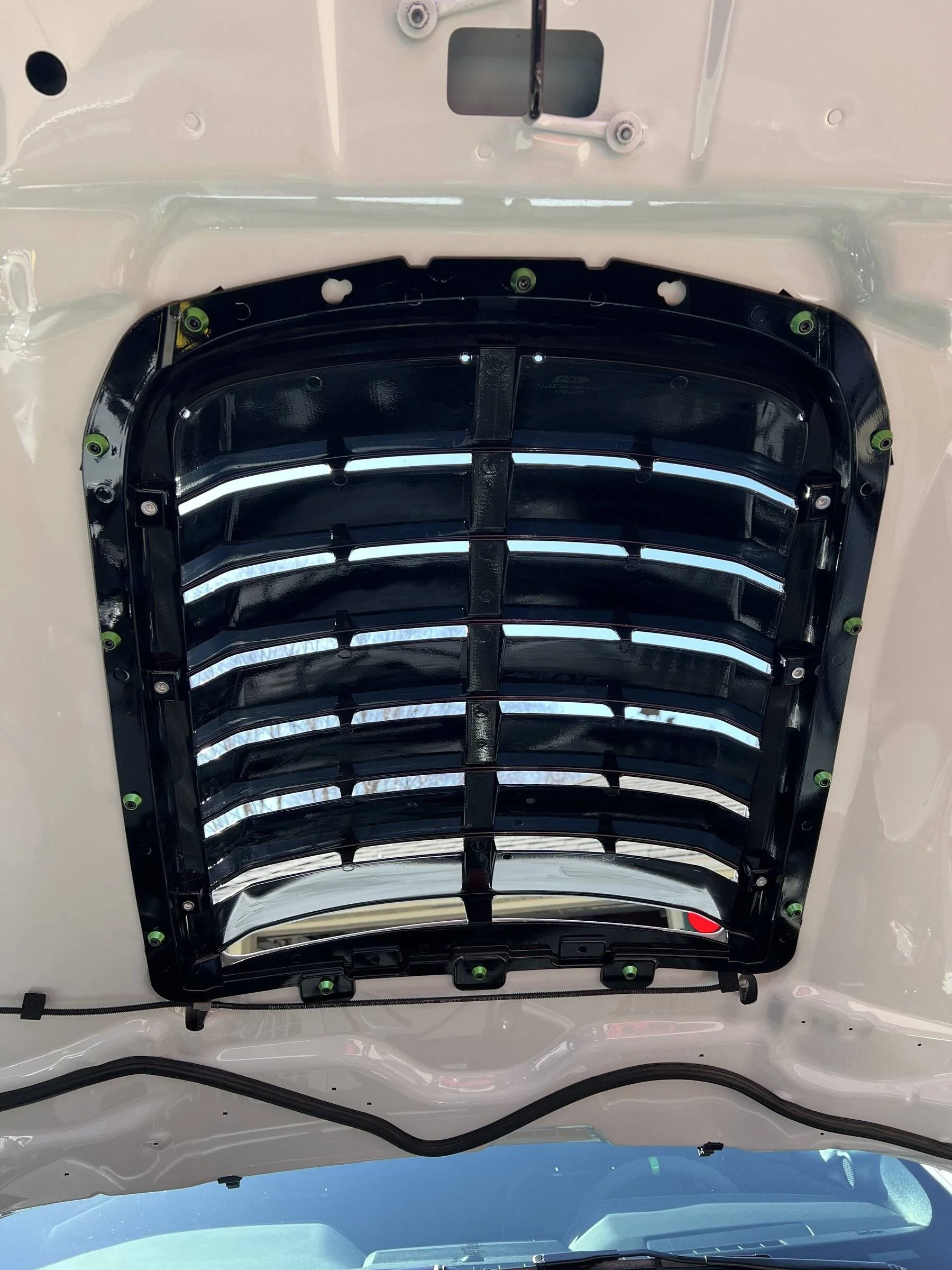

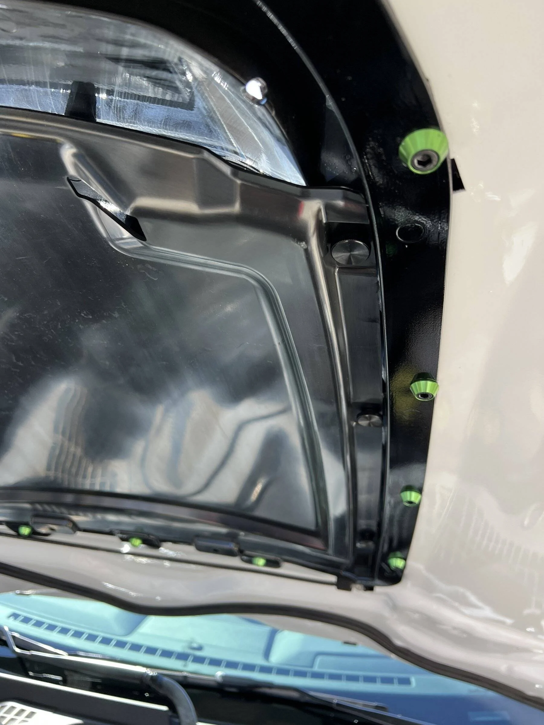

So here’s a pic of the hardware I used to mount the vent and then used rivet nuts and finger screws to take the rain tray off n on with ease. Oh and before painting I did add weep holes on front two vents in the same location as the actual ford one

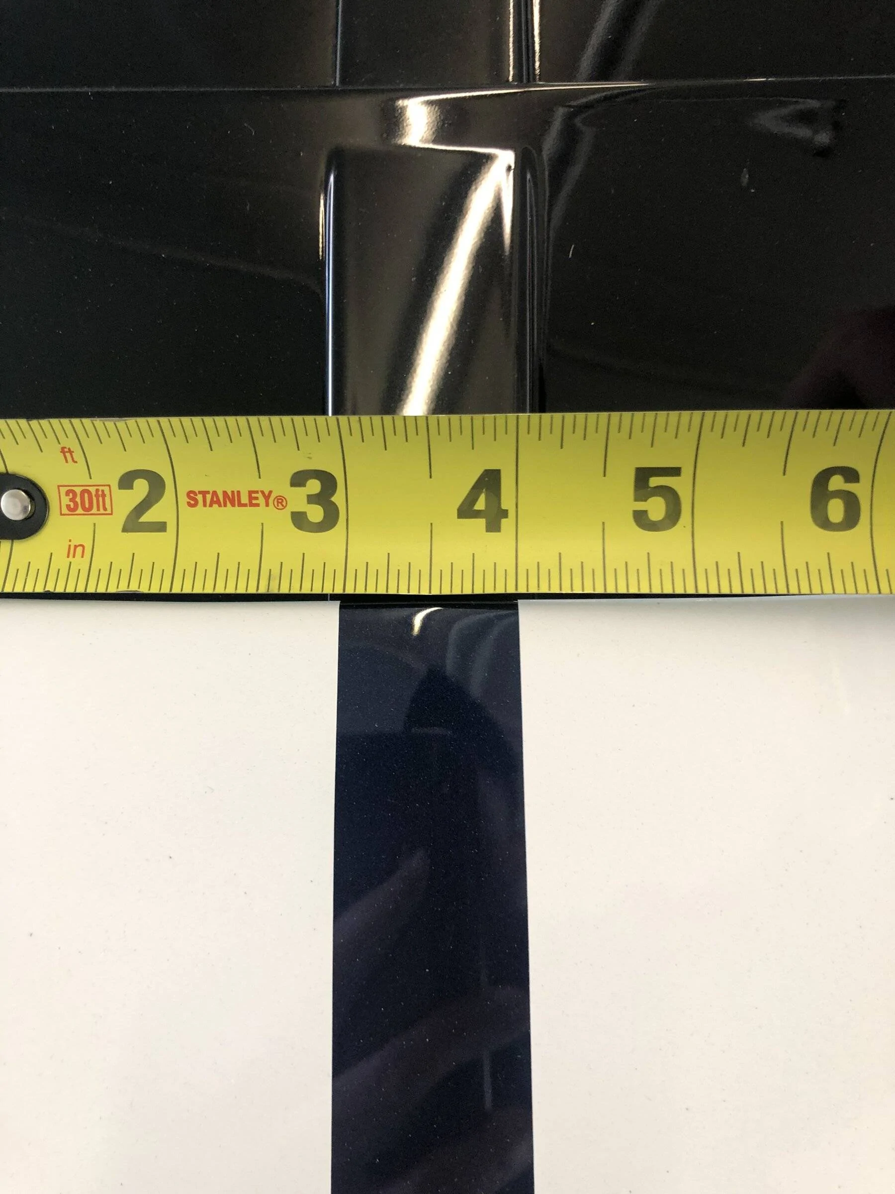

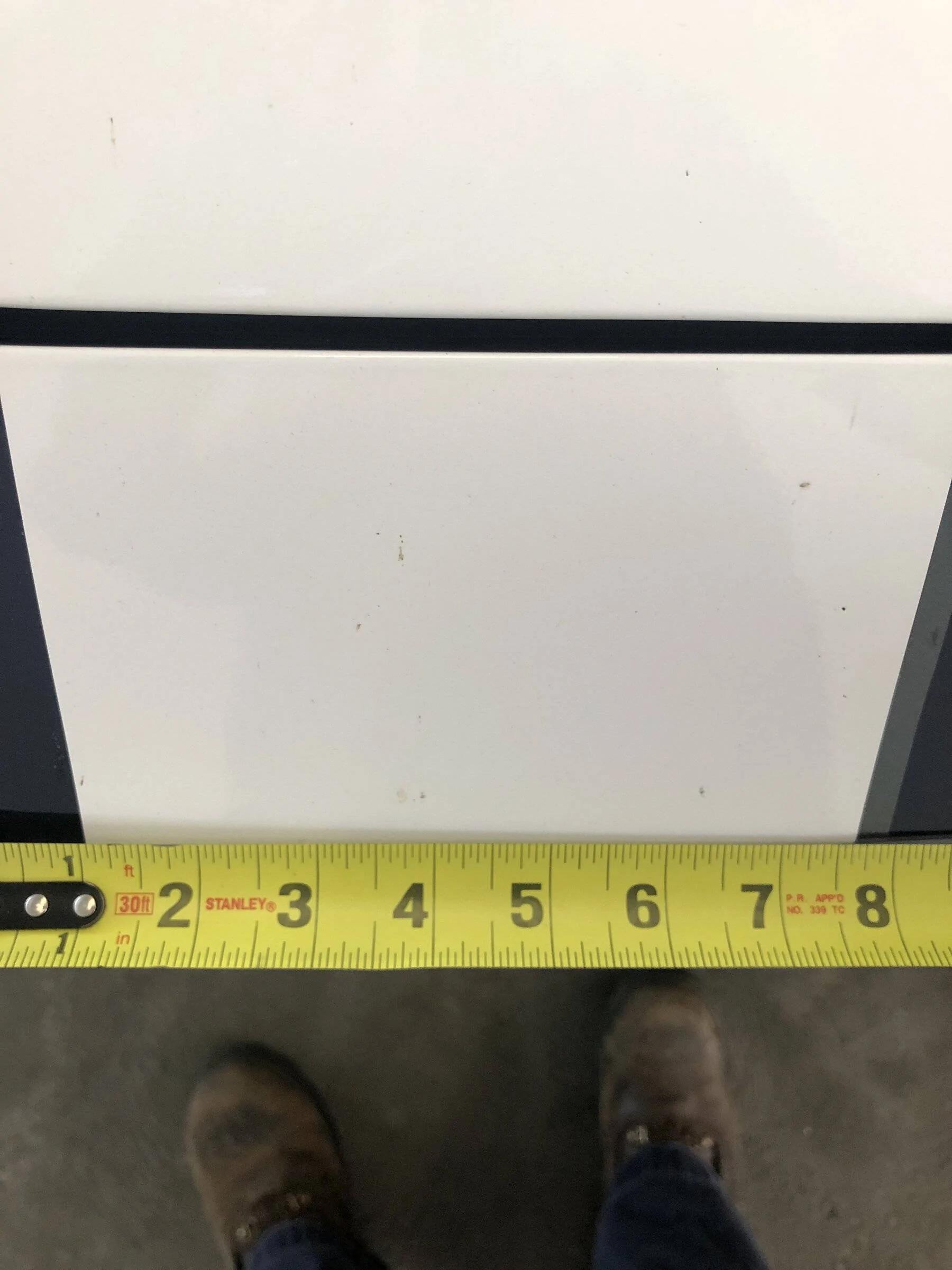

It looks like my stripes are 7” wide total, including the pinstripe (I started measuring at the 1” mark instead of the 0” mark to make the lines clearer)
also looks like the gap between the stripes is close to 1” even
