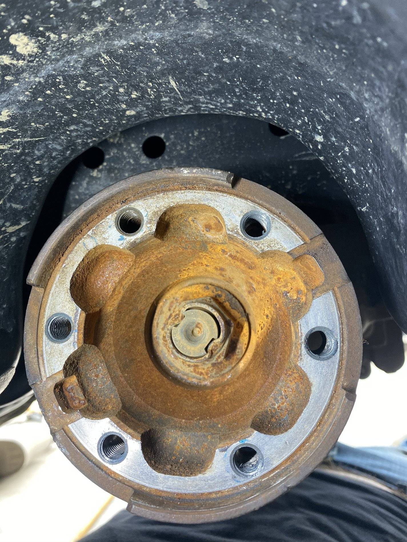

Being a Ford Registered Technician (Driveline Specialist) for over 17 years, I have done hundreds and hundreds of rear-end overhauls. Having said that, I also have seen almost every combination of factory recommended repair methods, as well as a lot of non factory recommended repair methods and short cuts.
What they mean by: " phase it the same way" is: The end of the pinion shaft (the threaded end, has 2 notches at the very end. Ford stakes the pinion nut into these 2 notches from the factory so the pinion nut won't come loose. These two notches have an index relationship with the flange itself, being there are 2 notches on the outside of the flange also, this is what they mean by the phase. The phasing is most important when using the same parts for reassembly, (So you get the flange back on the pinion in the same exact location). When you are replacing either the flange or ring & pinion, the phasing becomes less important.
No doubt the 2015-2017 IRS Mustang Driveshaft to Pinion flange was uniquely balanced. With the introduction of the 2018 model, a greatly improved pinion flange was introduced.
This 2018 pinion flange had some impressive improvements:
A. An anodized finish
B. A tighter-spec balance (Zero balance)
C. Painted on the outside, with part number markings.
I believe the part number is still: HR3Z-4851-B
So, your last question: I would go with the 2018 specific flange.
tips or tricks: You will probably need a puller to get the flange off of the pinion shaft. At least all of the ones I have done, needed a puller. (Do not hammer on the flange)
Getting the same preload as original is the most important thing you need to accomplish.
Some mechanics can feel the preload, and get as close as possible without any measurements.
Myself, I have a (beam-style) inch-pound torque wrench I use for the before and after, But I have also done many without.
Other things to consider: This job can be done by simply removing the old flange, installing the new flange (and new pinion nut always), tightening the nut until the preload is the same as original, and all is well.
Others say they prefer to remove the flange, pinion seal, thrust washer, bearing, and collapsible spacer. The only problem with replacing the collapsible spacer in the S550 is you have to remove the differential from the housing because the spacer won't come out unless you remove pinion shaft from housing. (The spacer won't clear the front pinion bearing cup, therefore it can't be removed from the front)
Using a new collapsible spacer (crush sleeve), pinion seal, and pinion nut, reassembling and tightening the nut until the correct preload is achieved. (It will take a lot of torque to collapse the new spacer, I have needed a long breaker bar with a jack handle extension to collapse mine. You will need a good 1/2" drive 1 1/8" socket for the torqueing of the pinion nut. You also will most likely need a pinion flange holding tool (NOT a good idea to tighten the pinion nut with an impact wrench !)

@JohnVallo Thanks for the info. I will buy the 2018 flange and a new pinion nut. I am fairly confident that I can do the swap.
So just to be clear, the 2 notches on the flange should be lined up with the two notches on the pinion shaft like in a straight line? If you look at my post 3 i have a picture of both and the 3.55 isn't close to that it is almost 90 degrees off but the notch on the 2018 3.15 is really close to lining up.
I think the new flange will make a big difference, and I shouldn't have that vibration anymore.

You phase the new flange the same as the phase on the one you are replacing, (The same relationship).
Not necessarily in a straight line.
You will put the new flange on the 3.55 the exact same: "almost 90 degrees off", don't pay any attention to the 3.15 phasing.
Honestly on the new 2018 flange, the phasing isn't really that important, but it never hurts to try to follow the written instructions.
