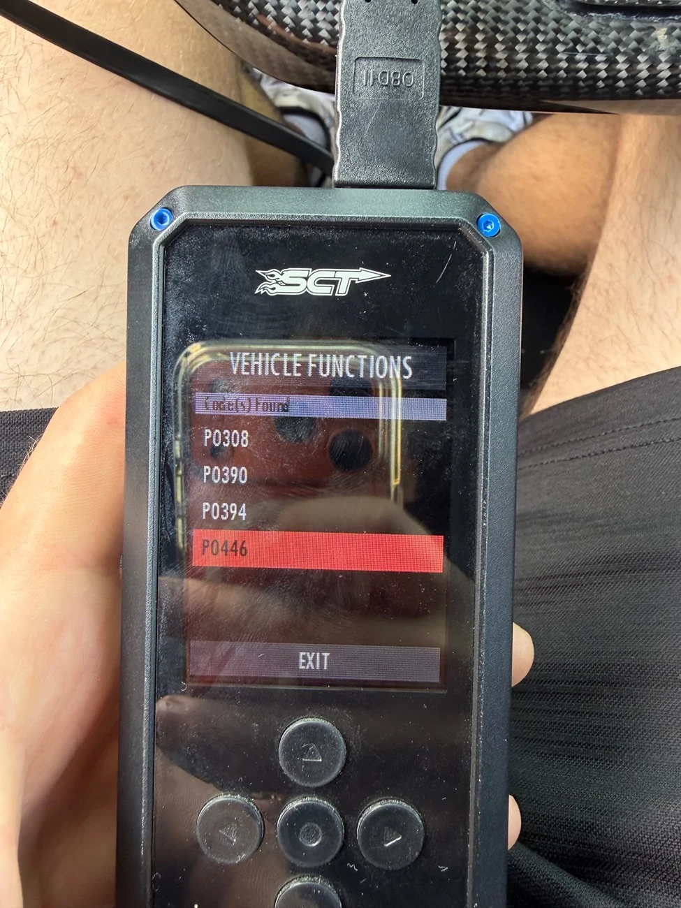

Really confusing issue I am having here. Any help is appreciated. After doing pac1234x springs, ops/cs, and new/upgraded timing components, my car has a odd and very intermittent issue where once every couple redlights/stops, it will misfire bad and it goes away right when i get back into rpms. 2 codes for my bank2 sensor 2 cam sensor (drivers side exhaust cam) and during the misfire events, it is usually cylinder 8 and sometimes 5. It will only misfire when coming to a stop, it will not start if i just sit at idle. I re timed entire engine today thinking it was a tooth off and am now a little clueless. Also replaced the cam sensor and that did nothing as well. Getting higher in rpms seems to get rid of the misfires instantly, say It is misfiring at 1k rpm, i will downshift and it will immediately stop. Some drives it will drive great, no issues at all. The drive after it might misfire at the first stop i get to. Everything I changed when doing the valve spring/opg job was all gaskets, opg/cs, pac1234x springs, boss 302 primary tensioners, secondary tensioners, phasers and cam filter, guides, primary/secondary chains, and went from amsoil 5w50 to mobil 1 5w30. I am having trouble thinking it is a mechanical issue due to how random and intermittent it occurs.

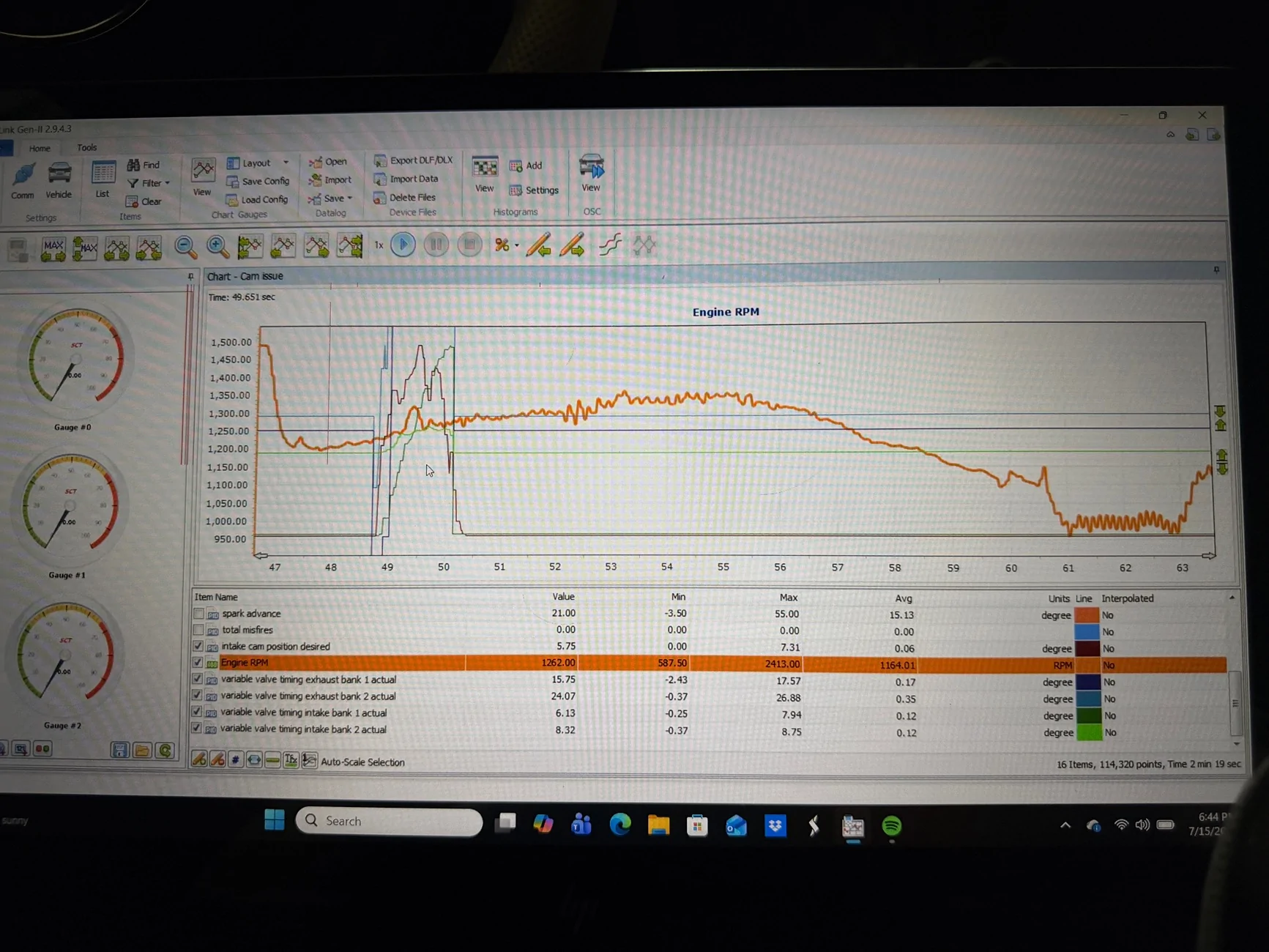

Was able to log it. When misfires start, all cams appear to drop to 0.07 degrees. Not sure if thats what it defaults to if it looses signal or something.

To my knowledge, the reading should be very similar within a few degrees. The difference between bank 1 and 2 exhaust is something to look at. Cams will go to zero at idol , start up etc and raise with rpm.
I’ll do a data log on mine today to compare.

Ford uses some methodology called FMEM. Basically, they try to think through all the possible failure scenarios and build fail-safe functionality into the logic. When it senses a cam position problem, FMEM sends all cams to "home" or "park" position, which is 0, 0. That's why they do what they do when the MIL comes on. I've found various faults that will cause this, everything from erratic position to too much variation between cams. I don't know how good your tune is, but many tunes aren't that dialed in well at MP0/14 timing 0,0 which may cause misfires.
That said...the P0390 and 394 appear to be position sensor faults, one indicating intermittent and the other being hard fault. It can check for things like phasing out of range, speed of cam exceeds range, or no signal detected and that constitutes and error is counted and accumulates. Accumulate enough and it triggers a code and goes into FMEM.
I might be able to tell more if you log desired exhaust cam position, actual exhaust cam position, and phaser duty cycle. I'd log these and maybe a couple of other parameters at a high data rate to give the best chance of seeing what's going on.

Makes perfect sense, i though they were being put in some sort of fail safe the way all of them reacted in unison. I use sct livelink to datalog and a desired exhaust cam pid doesn’t show up for some reason, but now i am thinking that the phaser for the cam with the codes may be bad/defective, Causing the fail safe. Just a theory for now.
