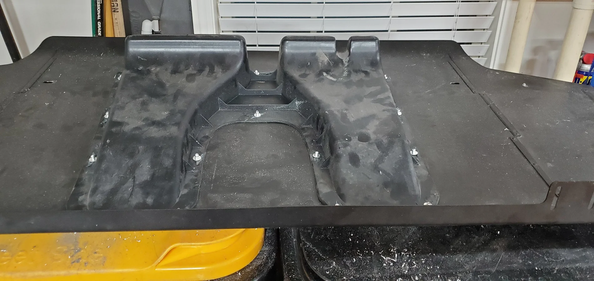

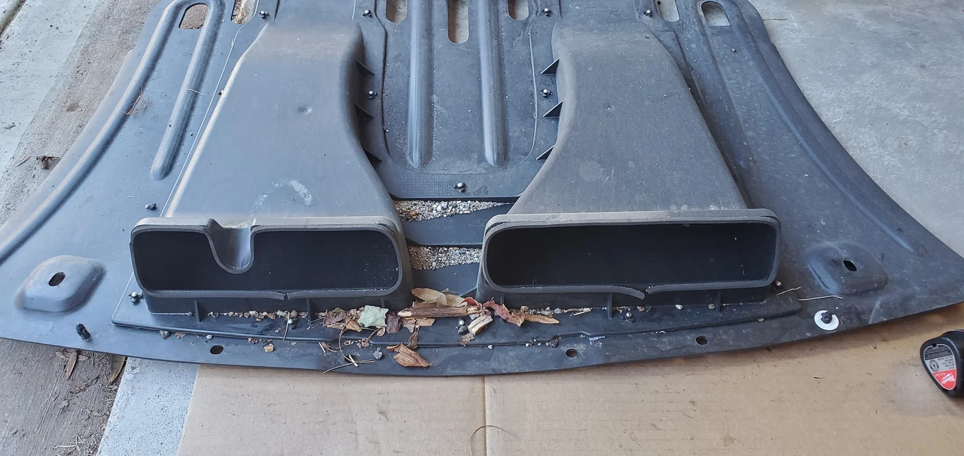

You'd have to ask them. They also sell a template and tools to allow the attachment of the factory diff cooler ducts to their actual diffuser. I believe the strokes may have been developed for class specific rule sets or for those who didnt want to have to dissect their stock setup. Back in the day they didn't have a template so I just had to kind of wing it.

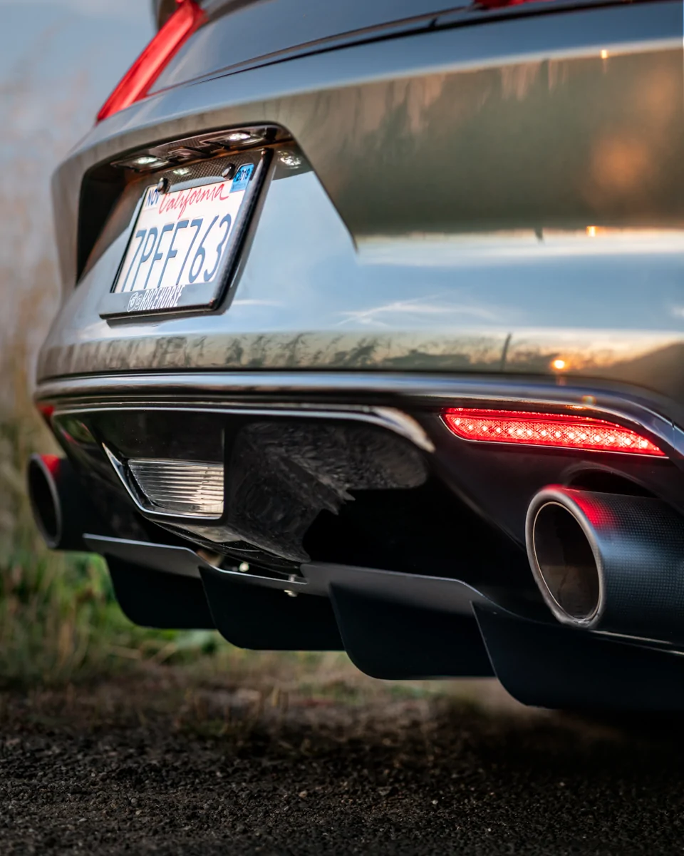

Also for those considering this diffuser. Careful of your mufflers…if you have big aftermarkets…like my spintechs…or a custom full exhaust like mine, it hits. Alot. No I didn’t cut it or anything, I don’t mind and it isn’t super noisy or anything. Just get ready for a super tight squeeze and make sure your bolts are tight. Some modification required sometimes…

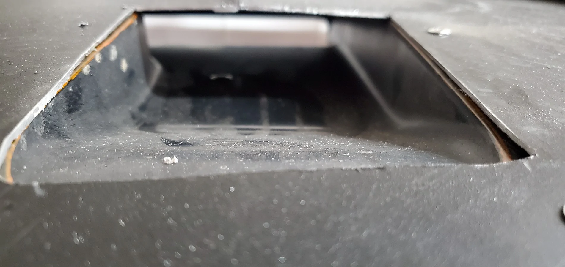

The ducts aren't sold separately. Theyre part of the factory "diffuser" and you have to cut it off of it.
Thanks, I will try to find a part #
