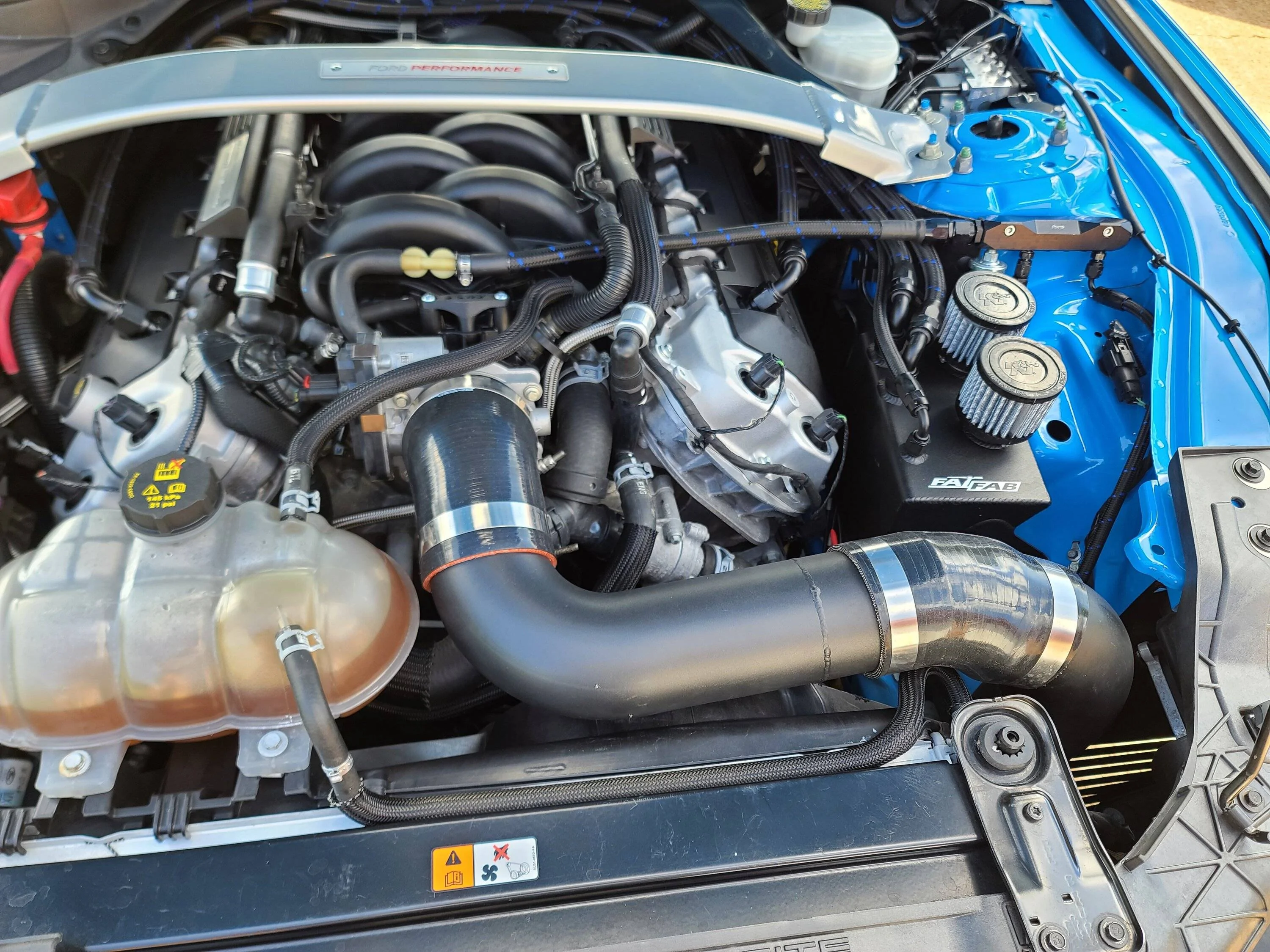

I didn't search high and low but the only one I found that works with the PCV system for my Hellion car was UPR. It's pricey IMO but it worked for me.
Okay I’m trying to get pressure out the crankcase under boost and i saw where they had posted that’s what that one did
LS1Coupe
Mar 25, 2022
207
165
florida
rich
2018 Mustang GT A10
no pcv will work under boost unless you are running a vacuum pump. The upr I am have uses the factory PCV valve under no boost conditions.
Pcv to the catch can, catch can to the intake manifold with a check valve. On the drivers side valve cover there is a large breather that goes to the turbo air filter.

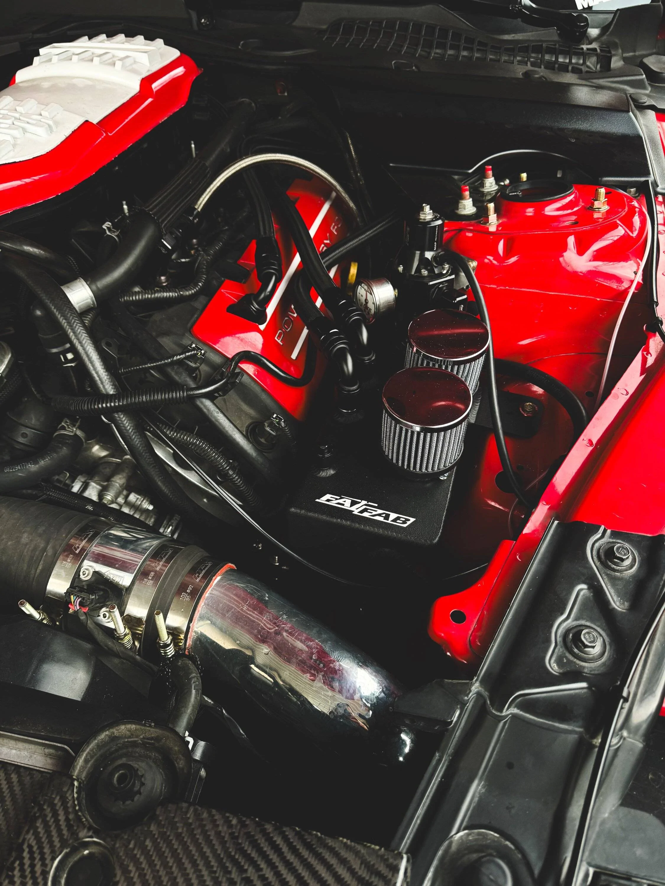

What brand is that?
I built a cardboard template and had a friend fabricate it together. Its baffled and hasn’t given me any issues.
It’s based of the BL fab kit with different breathers.

this upr is by far our favorite
i actually run 2 to releave crank case pressure, but we are pushing 1500 wheel
https://www.beefcakeracing.com/5029-221/
