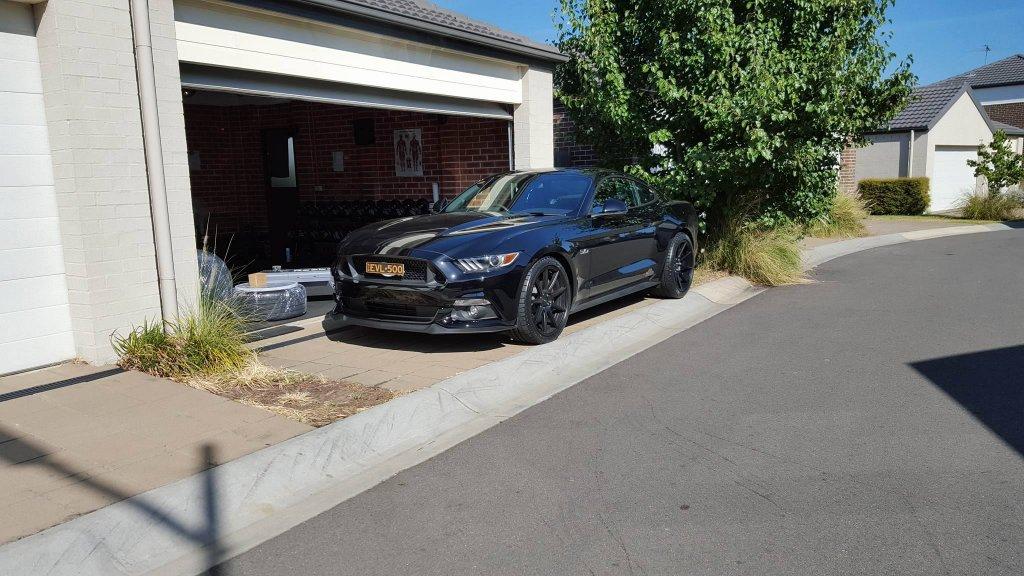

[MENTION=22285]gbader[/MENTION] 275/35 and 295/35 MPSS on VMB9's Aussie delivered mustang. Hope this helps.
Ps: Pictured with stock springs

Thanks for the that, had not see the pics - does look great. I have the gunmetal ones coming, like the look on a black car (just need the bloody car to arrive now)
