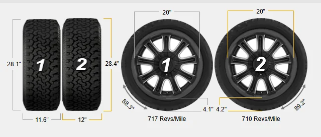

Shouldn't be an issue. The Rear is what will be a bit closer. Make sure you have the space ; here's aeasy tool to see the actual change in height Tire Size Comparison. Little less than a half inch taller.
If it is too tight, you can always grab a Steeda 555 8252 Mustang Billet Rear Spring Spacer 1/8" (15-26)
