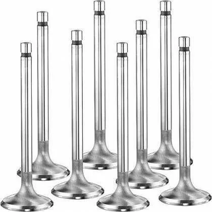

Any other valves available other than Ferrea For built motors? I am having a motor built by RPG and I want to get better valves than stock but I have ordered Ferrea from different sites twice now, one a couple months ago which advised me that they don't have them available and refunded me. Second place it has been over 2 months. This project has gone on longer than i wanted. Any other options for valves?

Try and see if Manley has any available for the Coyote. I’ve used them in the past though I prefer Ferrea.

I got a reply from RPG, they said Manley is more for Gen1 but can be made to work(doing gen 3 block/gen2 heads) RPG is working to get me some directly. Lets hope this project gets finished up before November

Stock valves are stainless steel and work in 1500hp applications. Why wouldn’t you want to use them?

gen1 and gen2 are almost the same. the same oversized valves can be used in both. manley sells them ferrea and mmr sells a set that is there spec made by manley also

IMHO, stock Ford Coyote exhaust valves are a weak link.
I have seen them out of a 2019 Gen 3 with only 11K miles and the seats were pitted.
