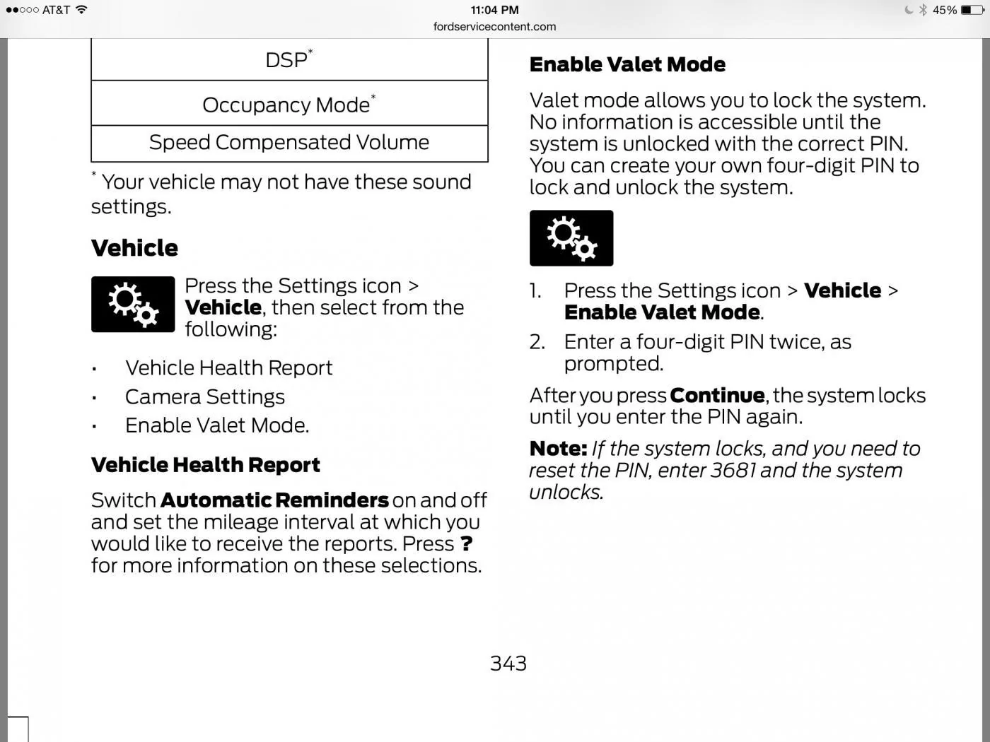

So what exactly does the valet mode do in the 2015 Mustang's?

As far as I know, it disables the NAV (and probably the radio) system so the valet doesn't see where you live.

How do you put it in valet mode?

Its a my ford touch feature. It should be under vehicle setting.
