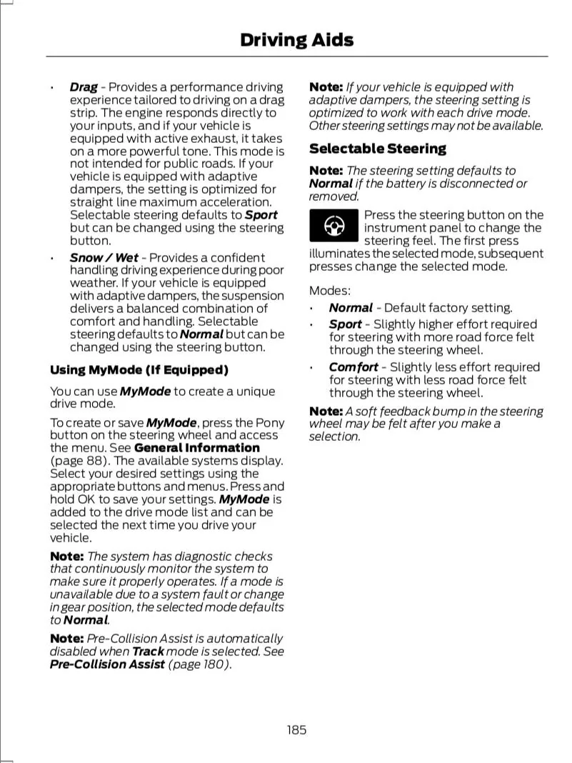

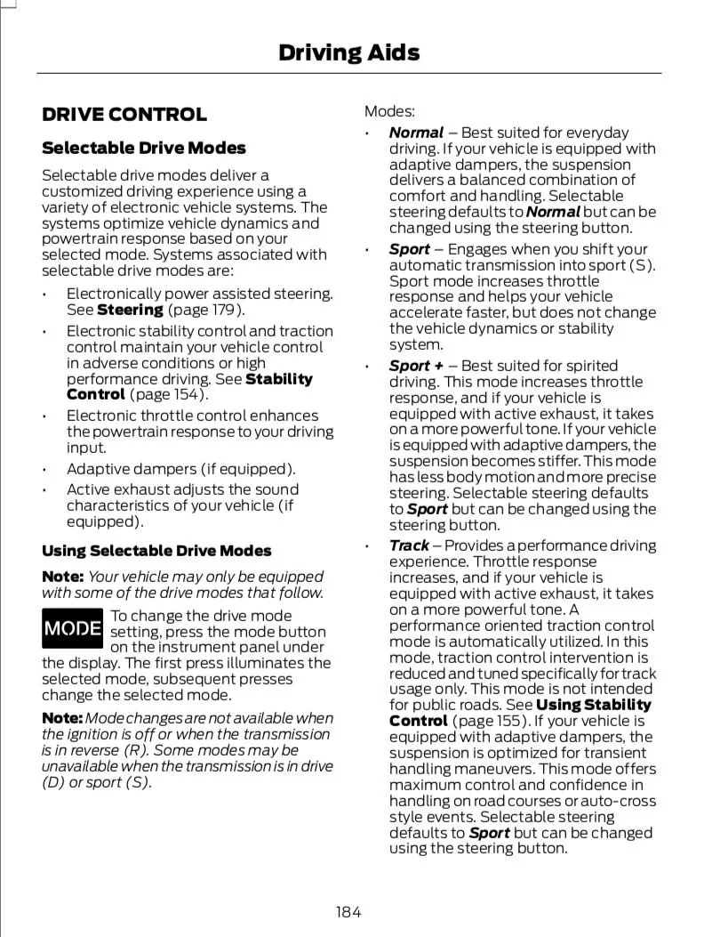

Drive Mode info (ie: as pertaining to only the Center Stack “MODE” switch”).
This is directly form the 2018 Owners Manual (and can be found in prior year Owners manuals):
