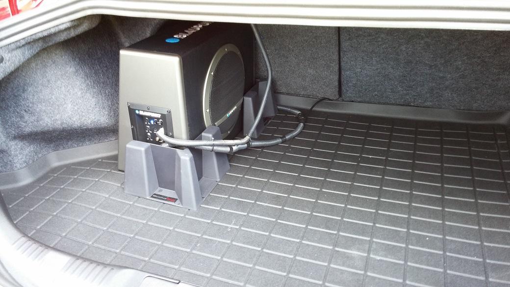

I got the Sub hooked up yesterday. Gain and Bass boost are not even halfway up and the radio bass is midway (flat) and it sounds great. Hits really hard for a 10''. Keep in mind big bass is not my thing though I do like the occasional old school hip hop. For the money it was perfect for me. As far as fitment, it will not go in the side cubby as it's an inch or so too tall. I have mine in the back due to a short ground wire so that will be remedied soon. Please pardon the wiring job as it is temporary. Do need to figure out how to mount the sub so it will not move, but can come out quickly for vacations and such. Sorry about the blurry pic, but you get the idea. Amazon was $207 and the wiring kit was around $16.
Can I ask why you decided to install it on the left side showing all the wires? Seems like it was meant for the right side to hide everything and look better. :shrug:

It's going over there eventually. That's just where it wound up. Might do that later today.
