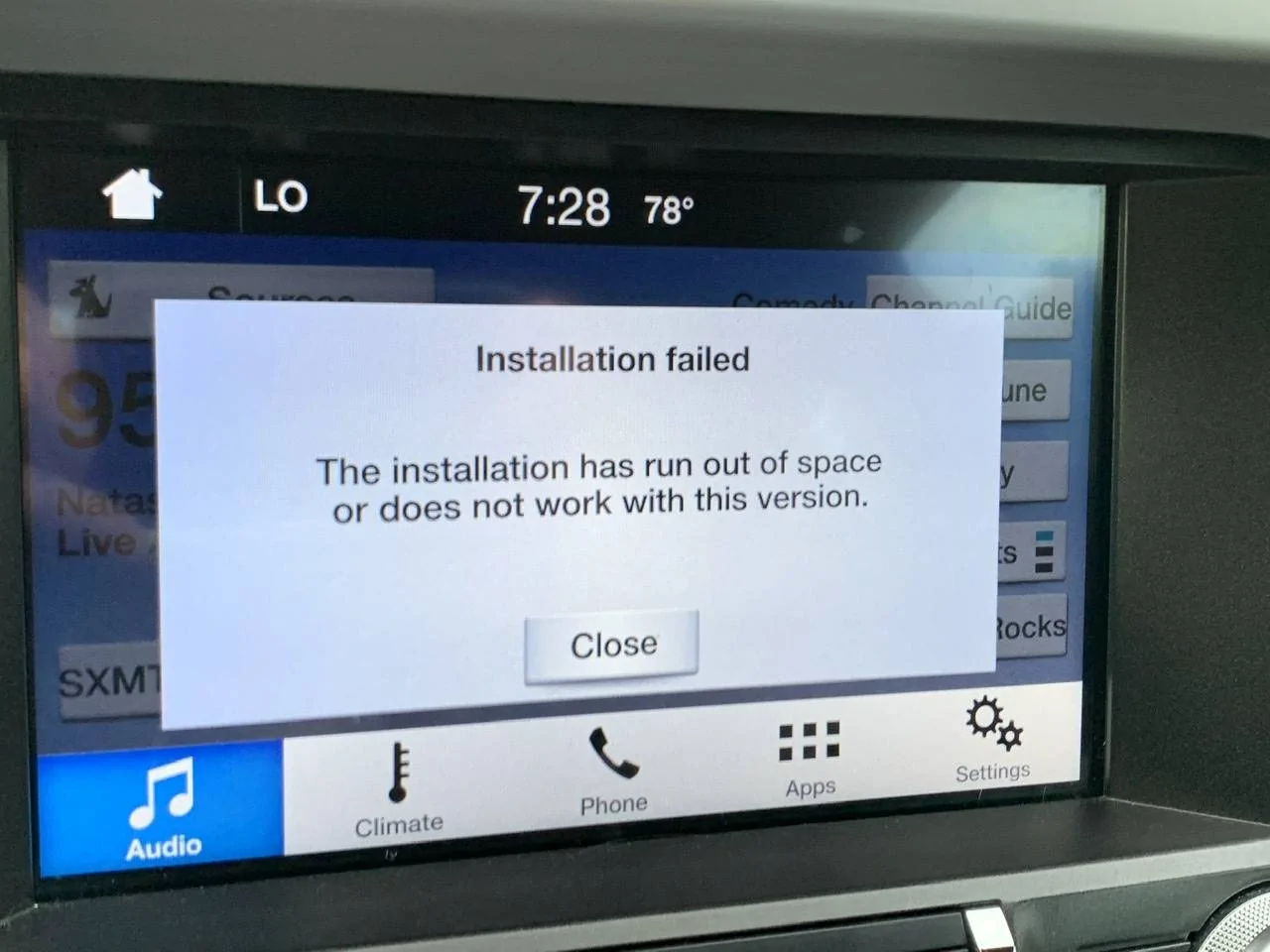

So I picked up a new thumb drive.. loaded up the files and popped it in while I was heading home from work.. after about 20 mins I was greeted with this message. I used a 32gb drive.

SlowWhite

I’m gonna attempt going to 2.2 first maybe.. I have the files for that from a f150 forum..
On a side note, I do have the new USB port for the console compartment.. so I need to swap it first before this process.. also when I format the thumb drive will I need to do the longer formatting route or will the quick route suffice? It’s exFat now but I’ve used the quick format route..
Going to 2.2 first is certainly worth a shot.
So long as its the right format, how you get there doesn't matter.

Still no luck. New thumb drive didn’t help.. guess I’m SOL.. ahh well, would of been cool to update. After several attempts I just threw in the towel on it.
