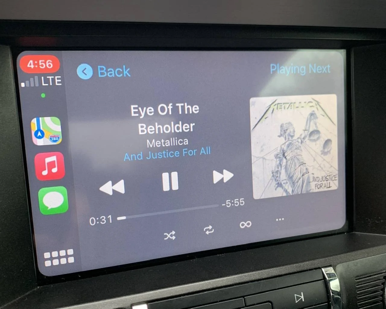

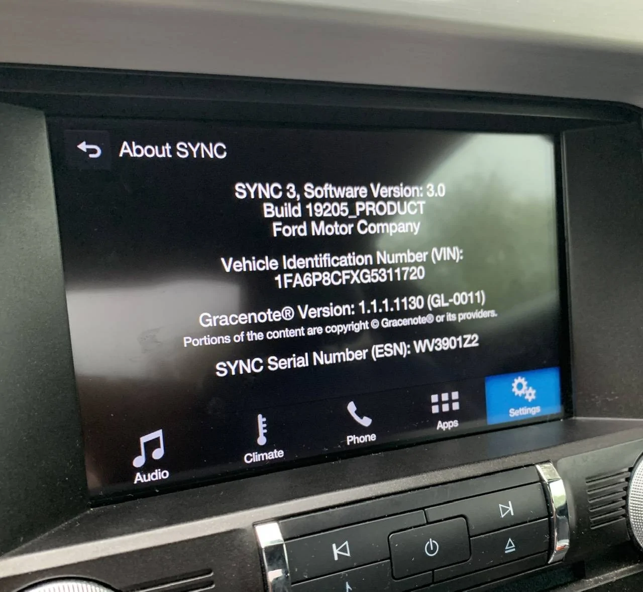

I hate to revive this old thread, but I have been reading countless pages and I just can't seem to get anything to work. I am on sync 3.0, and I have a new hub from ford but the apple carplay is just not working. I have an apple cable and iPhone 11 pro max that I can use carplay in other cars, just not mine. I have a 2016 mustang premium. I installed the HU5Z-19A387-B (not the -A hub that everyone was saying to use years ago, as that hub is out of production and this is supposedly the new version of the correct hub) hub from Levittown and I never am able to get carplay to show up. I have done numerous resets of my phone and sync 3. I am leery of taking it to the dealer and facing some diagnosis charge bs. Any help would be much appreciated.
OK, let's start with your build version on 3.0. You have to have at least 20204. This is the CarPlay update. If you have the correct build # move on to settings for both your phone and Sync 3.
https://www.wheelsjoint.com/apple-carplay-on-ford-mustang-how-to-connect/
Hopefully it is one or both of these things. Good luck.
