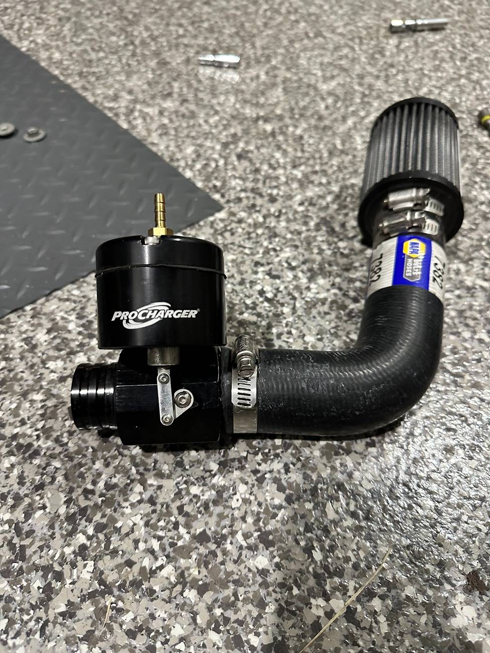

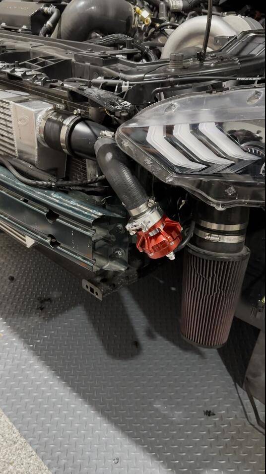

The only thing that I've done to the car since the last two revisions I had on my tunes (93 octane and E85) was adding a bigger blowoff valve, which I did myself. I went from the stock one that comes with the pro charger to a bigger one (see pics).
Again, I'm currently on the 93 octane tune, and didn't want to switch over to E until I figured this out.

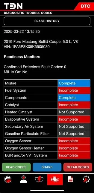

I did a data log yesterday and sent to Wengerd. I also pulled somes codes and here's what I got......
Oh and yesterday by coincidence, I got a "checkfuel fill inlet" message.....this is what made me pulled the codes. I did try and clean the fuel cap, using the extender tube. Not sure if that has done anything, as I didn't keep it out long enough afterwards.
