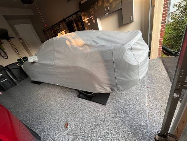

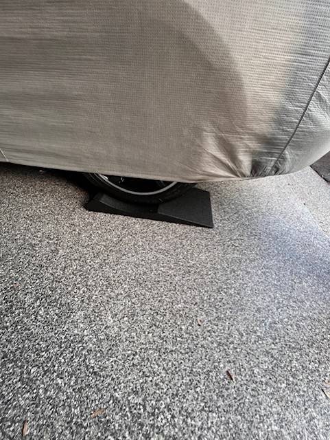

I'm thinking maybe I should do that.....I just don't want the hard starts in the winter when I crank it up. I live in Maryland and we get very harsh winters up here. The only driving I do in the winter is just around the block every 3-4 weeks. This is what winter looks like for him...

Oh I’m am! I’m done with 93 octane. I just need to research a good winter storage system with the E85
My car gets parked each winter in a heated garage with a full tank of E85 (verified E content of 85). I start it a few times each winter and do nothing else for the fuel/fuel system. No issues in 3+ years now.
