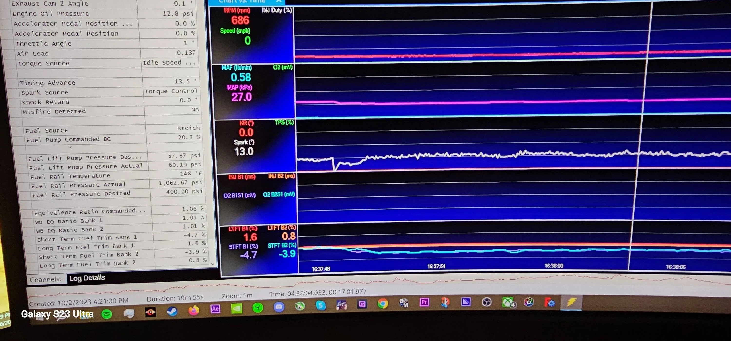

I bought the car with 36k, coyote tick bad bad. I isolated it to the imrc system and confirmed by temporarily locking them out. When I first changed the oil it was burnt and thinner than anything I've seen before. Got a great bath. Cylinder head temps on casual driving always stayed above 215° but spirited driving went alot higher. Saw heat soak at 245° one time. This is irrelevant in my opinion because there's a brand new 2023 coyote installed from Ford due to engine failure. They never determined the issues but it was apparently the worst failure they've ever seen from a coyote. New engine in first drive threw a p03000 again. Dealer did catalytic converter as part of a tsb that was for my car. It doesn't meet the criteria for the rest of the tsb (no cel with dedicated bank misfire failure) so there's no point in taking it back to them. When the car starts hesitating or bucking there is an extreme exhaust tone difference like it's broken up. The throttle squeal is most noticeable at 2500-4000 rpm when I drive against walls and fences it echoes back. I can hear from the drivers seat its coming from the front of the car. Hence the video of the throttle body. The test performed was with the car in KEOE (KEY ON ENGINE OFF) criteria for throttle dead spot test and listening to this feedback noise.
I hooked up vcm scanner and logged some casual driving with small pulls not hitting full throttle in case it runs lean. I was referring to the data in the screenshot provided from vcm scanner. The throttle sits at 2°-3° at idle and I took a picture of where there's a significant deviation of timing being pulled for some reason. All throughout the drive test fuel pump commanded dc stayed around 20%. When taking the video of the throttle body I tried pressing the pedal in a linear fashion to determine if there's input issues, deadspots in the throttle, or hesitation. Considering the throttle only operates on one plane it'd be very easy to see these variations. If you need help understanding anything else please let me know....

LTFT AND STFT were suspect to me in bank 2
STFT's should always fluctuate, and target 0. seeing a slight - and slight + number back and forth is exactly what it should do.

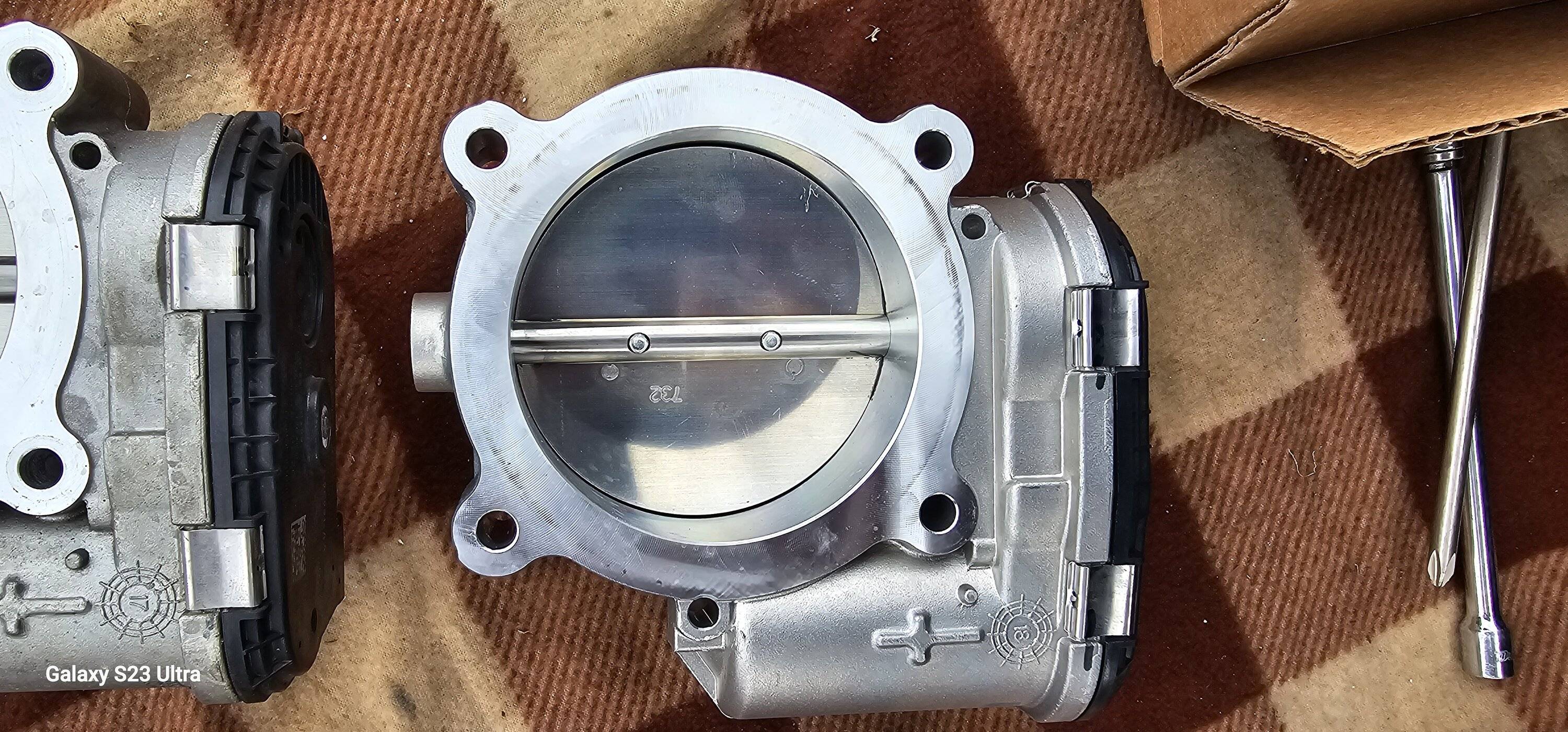

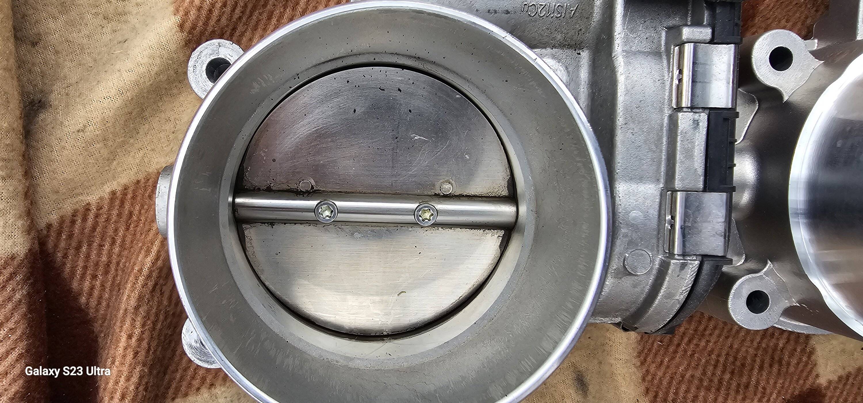

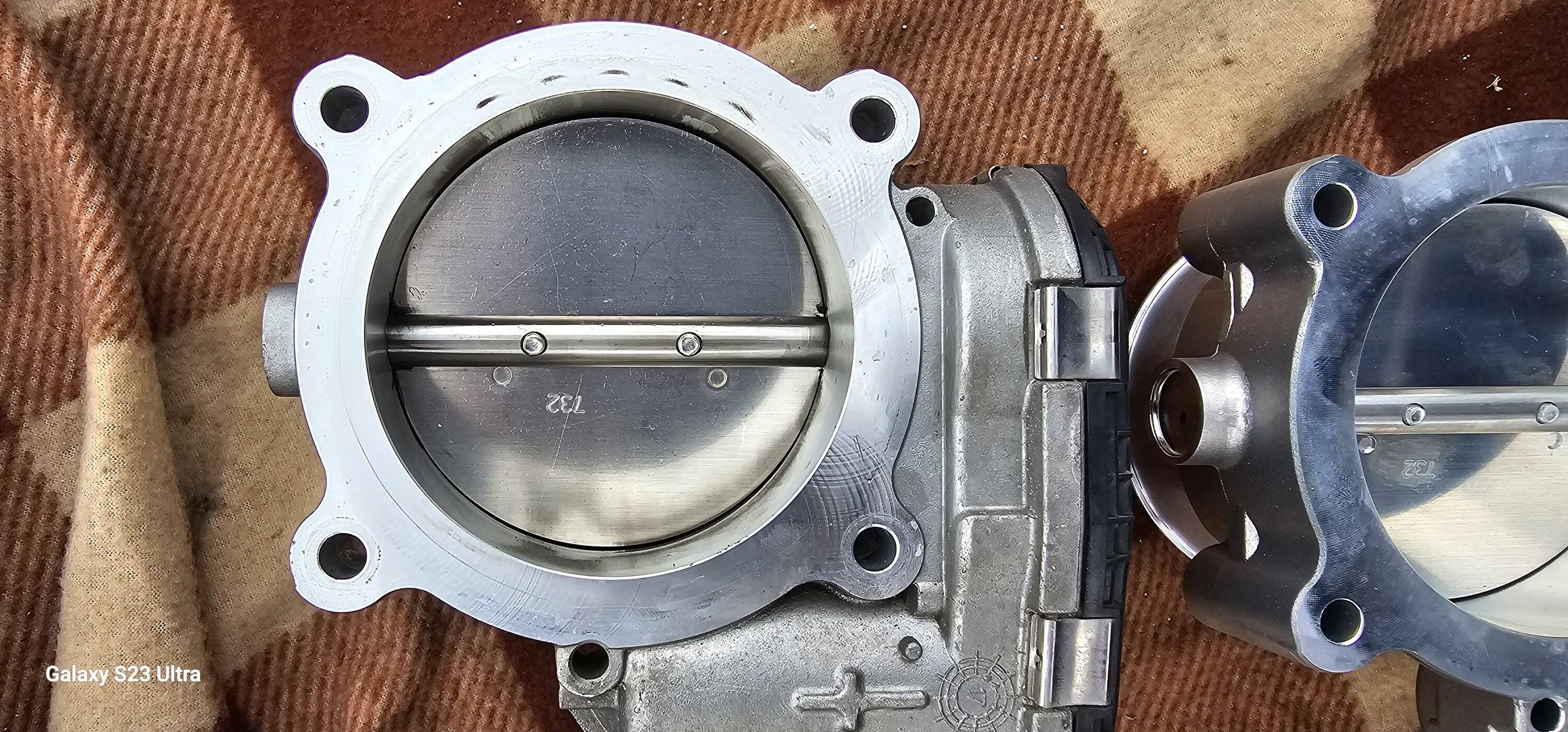

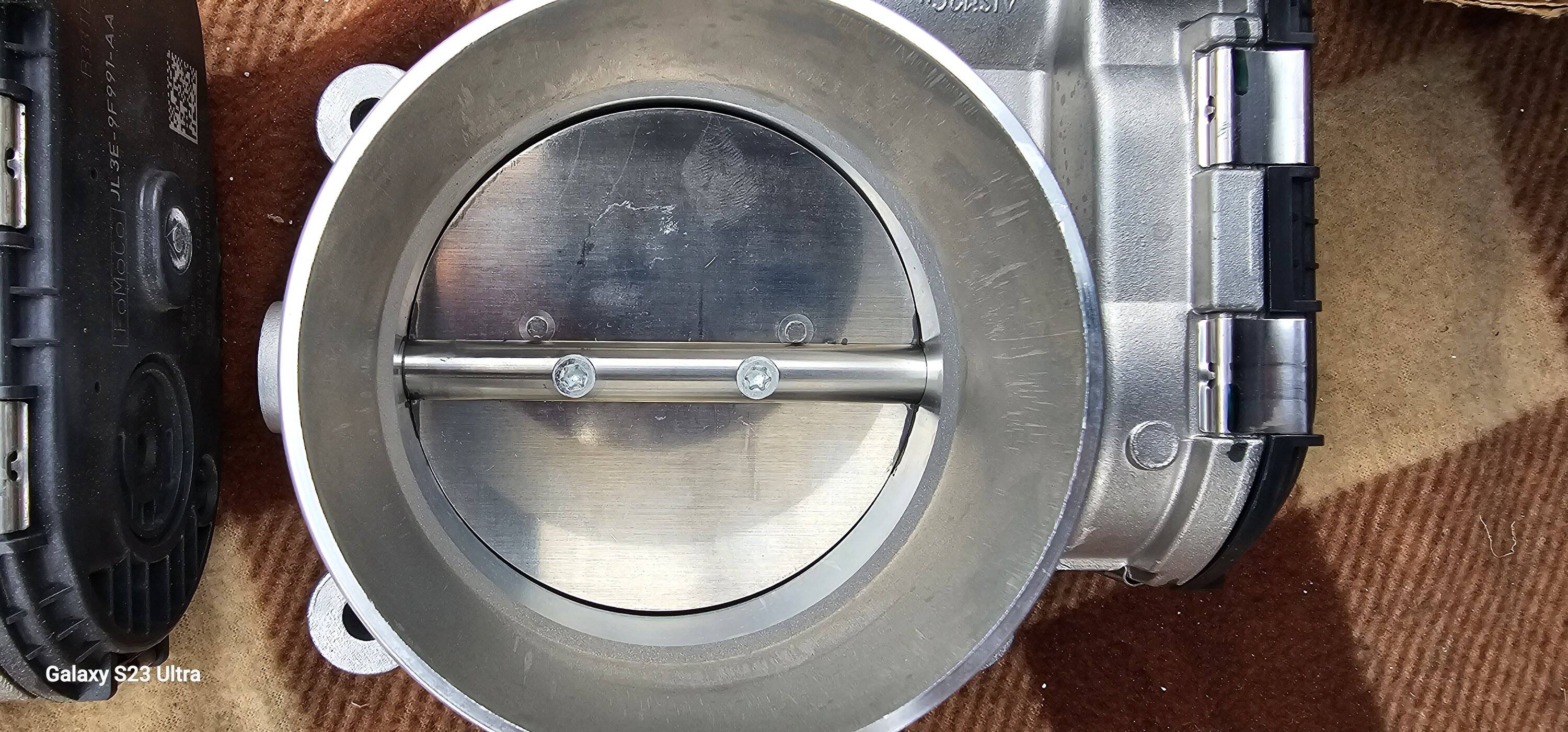

I just installed a new OEM throttle body and already notice a slight difference. The squeal is more of a gentle high chorus vs glass breaking screech. Shifts have already adjusted but there is still some breakup in the tone of the exhaust. I'll checkout the connections at the top end of the motor and see if there's anything that stands out.
At idle ltft bank 1 stays at 1.6% never fluctuating. Ltft bank 2 stays pegged at .8. There was a weird idle fluctuation. Following that the fuel trims all shot negative except the 2 pegged ltfts the values stayed between -3.9% and -6.3% on both stft's for a total of 1 minute until they slowly went back to normal. No other areas of the log have something quite like this and it was just at idle with no inputs from biological beings. Note the white bar graph pulling timing at the time it happened.
LTFT's should stay consistent, and be as close to 0 as possible. STFT's should fluctuate back and forth, but also as close to 0 as possible.
Negative STFT's would indicate a rich condition, perhaps a sticky fuel injector, but if it's on both banks, I'd still be leaning towards a wiring issue like a bad ground, or loose connector, bent pin etc. Bad PCM could also do this

I have put about 350 miles on the car since getting the throttle body and wow I thought I had a gt before this thing is brand new! Everything's cleaned up except that rail noise but even the cold starts are the same everytime now. Sometimes it'd hot start weird too but those are gone. I did have a weird time getting the drivers side fuel pump out. The line that runs to the other pump was twisted and I had to finesse it to get the pump out. Installing was 100x easier than install from that issue alone. I'm assuming inside the tank wasn't happy from an accident earlier in the year. Just got the car back about 2 weeks ago so it could've been that or another weird issue. I'm going to keep monitoring everything and hopefully I can relax soon over this stuff 😂
Thanks for taking time out to reply with help guys!
Here's some pics I snagged too.
