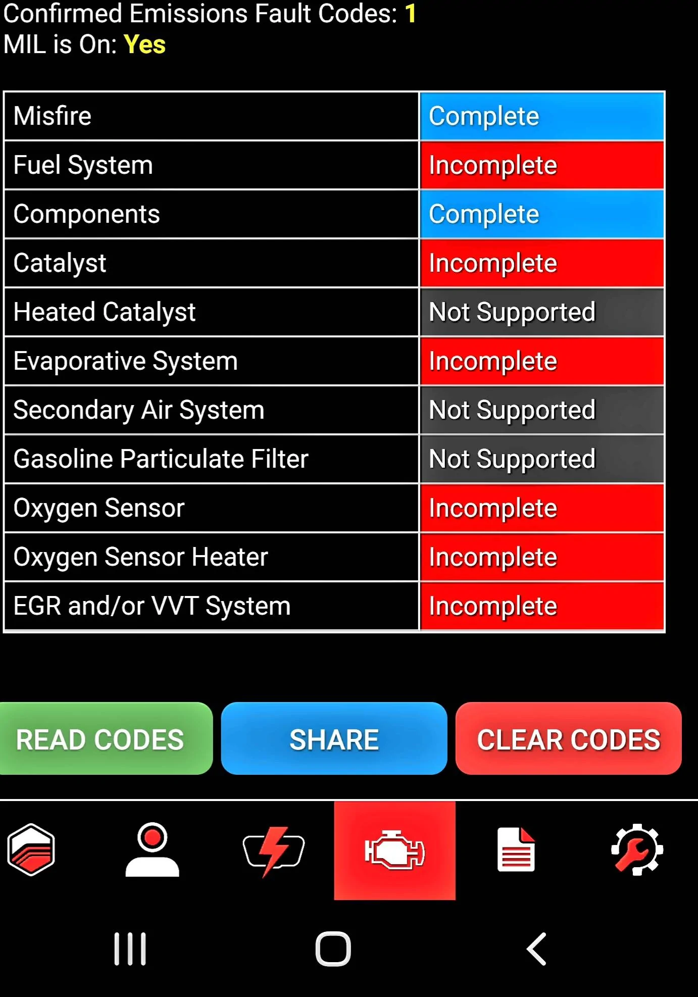

I had my car re-tuned and I popped a cel.
I cannot seem to clear it, see attached
Anyone run into this? Catted long tubes

P1000 means non continuous monitors haven't run yet. Its just means codes were cleared, battery was disconnected, or pcm was programmed etc. its not an issue really unless you are going to take it in for emissions inspections then you need to drive it.

I how do i get the cel off my dash?

On the bottom right of your screenshot, tap on "clear codes". It'll take a few seconds, but it will clear it.

Ive done that but hasnt seemed to do much... I'll have to look again

Just expect that the code may return until all of the emissions tests clear. It can take a bit of driving under specific conditions to get them all to clear.

Im an idiot, and didnt realize i needed to scroll the page..... p0315 crank relearn....
Probably explains my warm start needing cranking
