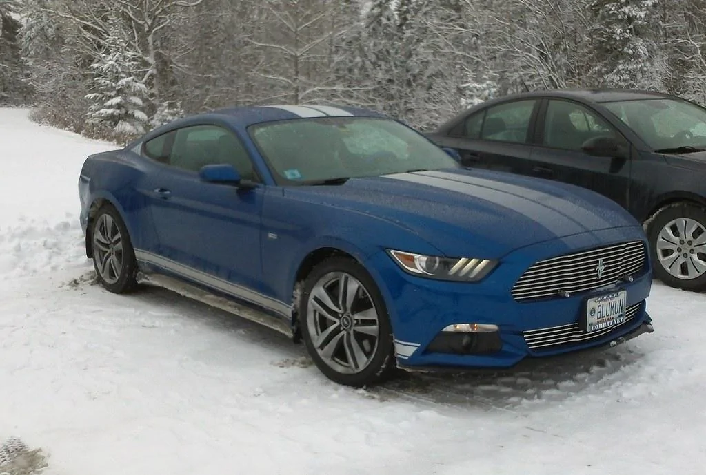

I asked the dealership in Maine (Ripley & Fletcher) to undercoat mine as soon as it was delivered to them. It's been driven through 3 winters now, soon to be 4, and I haven't seen any corrosion yet. I've made a few minor mods down there, subframe braces and vertical links, and I had no problem working through the undercoating. I was just underneath it today, changing oil and manual transmission fluid, and it still looks pretty good.
