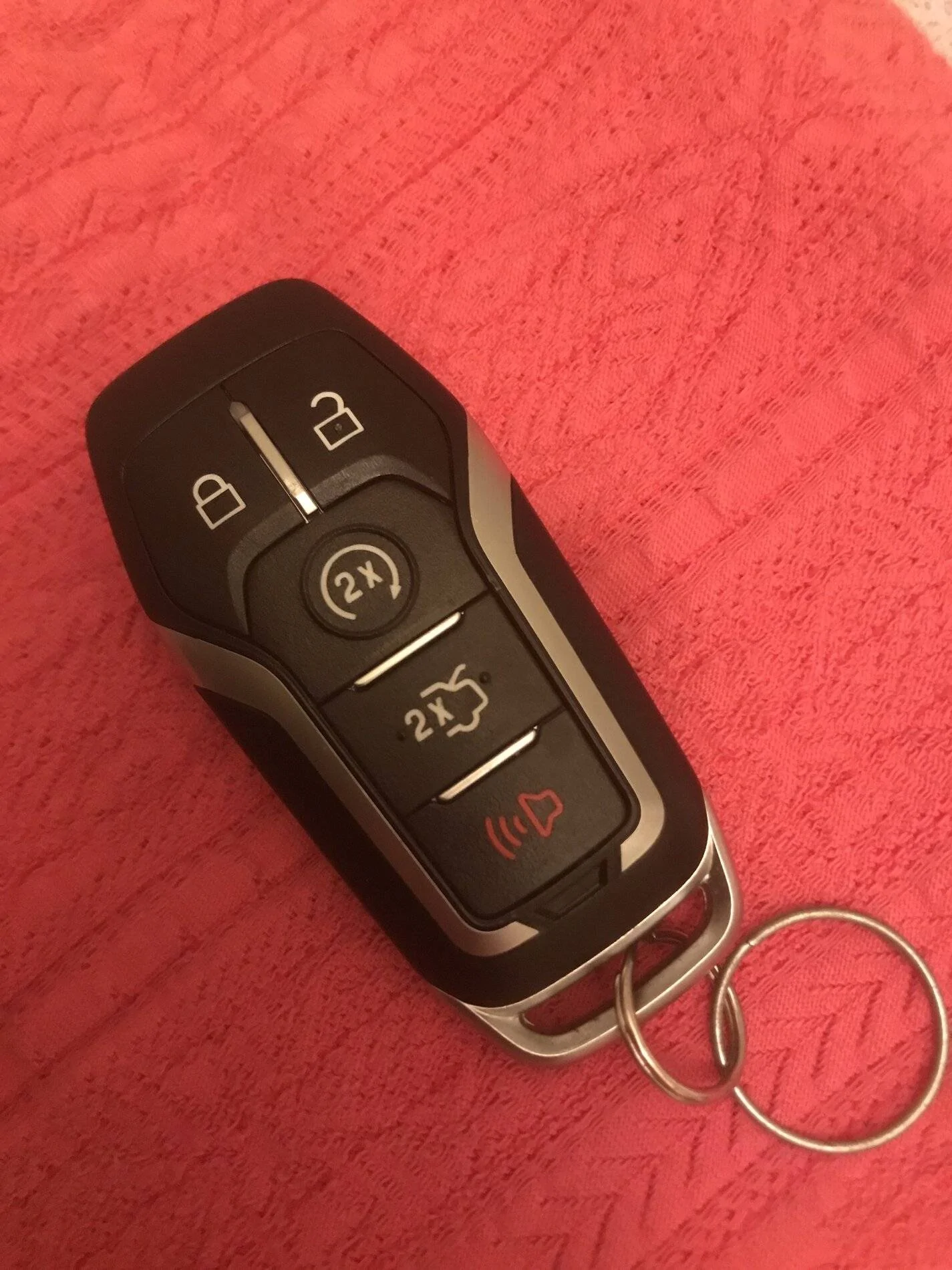

Yes you are able to buy a blank key and program it. I grabbed one off amazon and watched a youtube video on how to do it a few years ago.
Will an old key work or programmed as an admin key for another car? I still have one of the keys from my old gt that I forgot to give to the dealership which is now useless.
It can be programed to work

I was just saying if anyone needs a key I got a spare one for a penny. I don't need it if you can program it to work as an admin key or whatever. My old gt was an auto. I can mail it to u.
