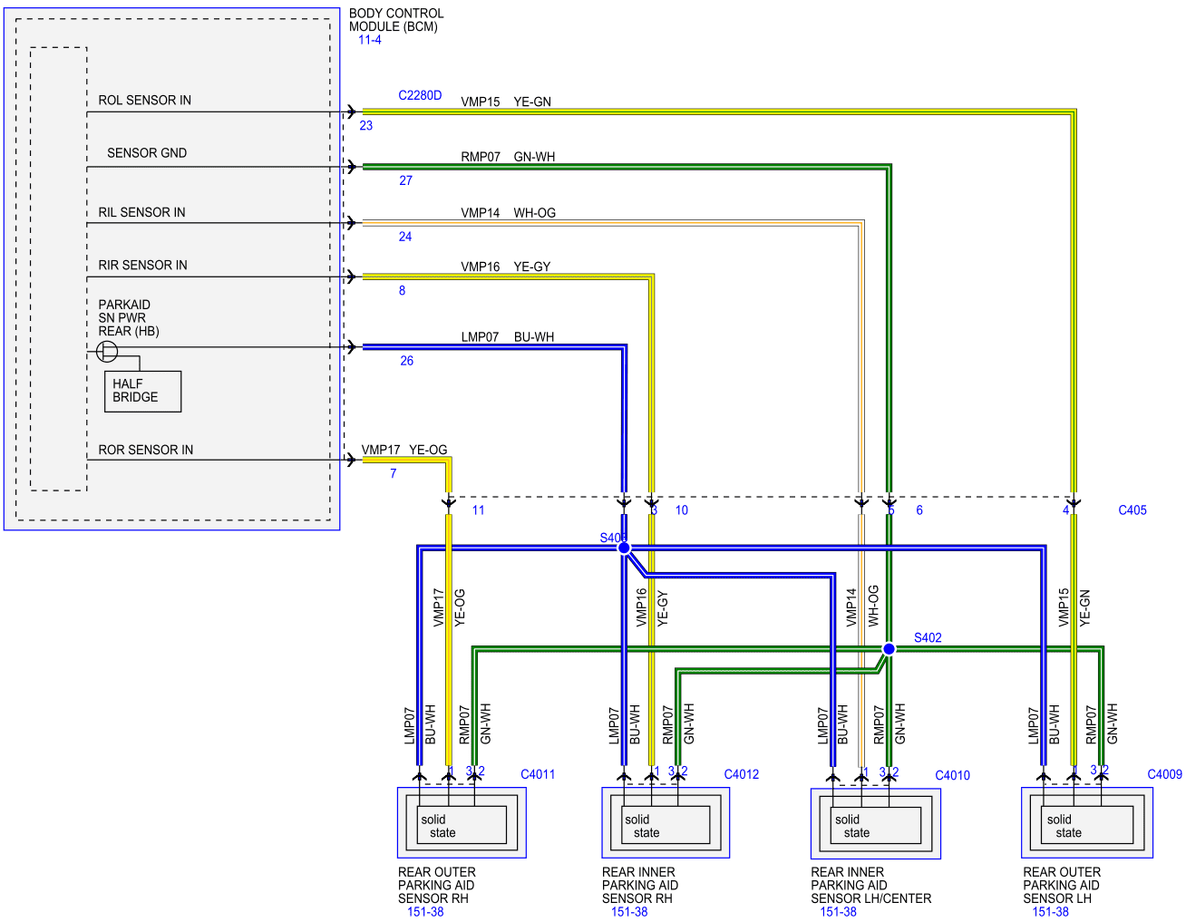

The alarm will stop with just the wire cut or unplug that is mostly what I want. The location and color of the wire is needed.
This is from a thread on how to add the sensors.
OEM wire colorFunctionPin # at the rear bumper connector (C405)Pin # at sensorColor
I used at sensor
Pin # at the BCM connector (C2280D)
Yellow with orange striperight outer signal112Brown7
Yellow with gray striperight inner signal102Purple8
Green witth white strpe- VDC63Green27
White with orange stripeleft inner signal52White24
Yellow with green stripeleft outer signal42Yellow23
Blue with white stripe+ VDC31Blue26

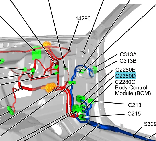

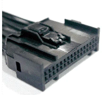

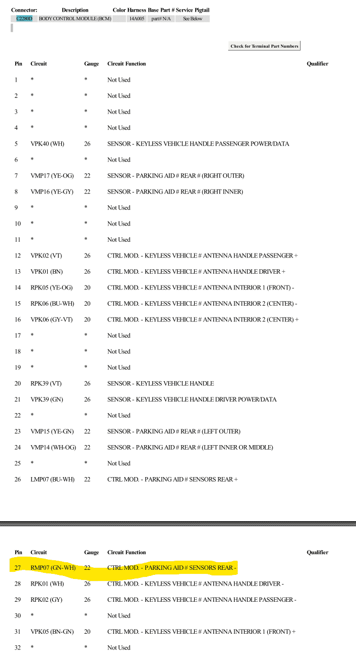

I would pull the pin for GND (GNWH) as a test, probably at the BCM (passenger footwell).
If the system then shuts down without an error message, put a switch in the line wired to the center console, so that you can switch it on and off as required.
(C405 is behind the rear bumper and for other things too, it is much more effort to reach.)
If that doesn't work, then just use ForScan.
C2280D
