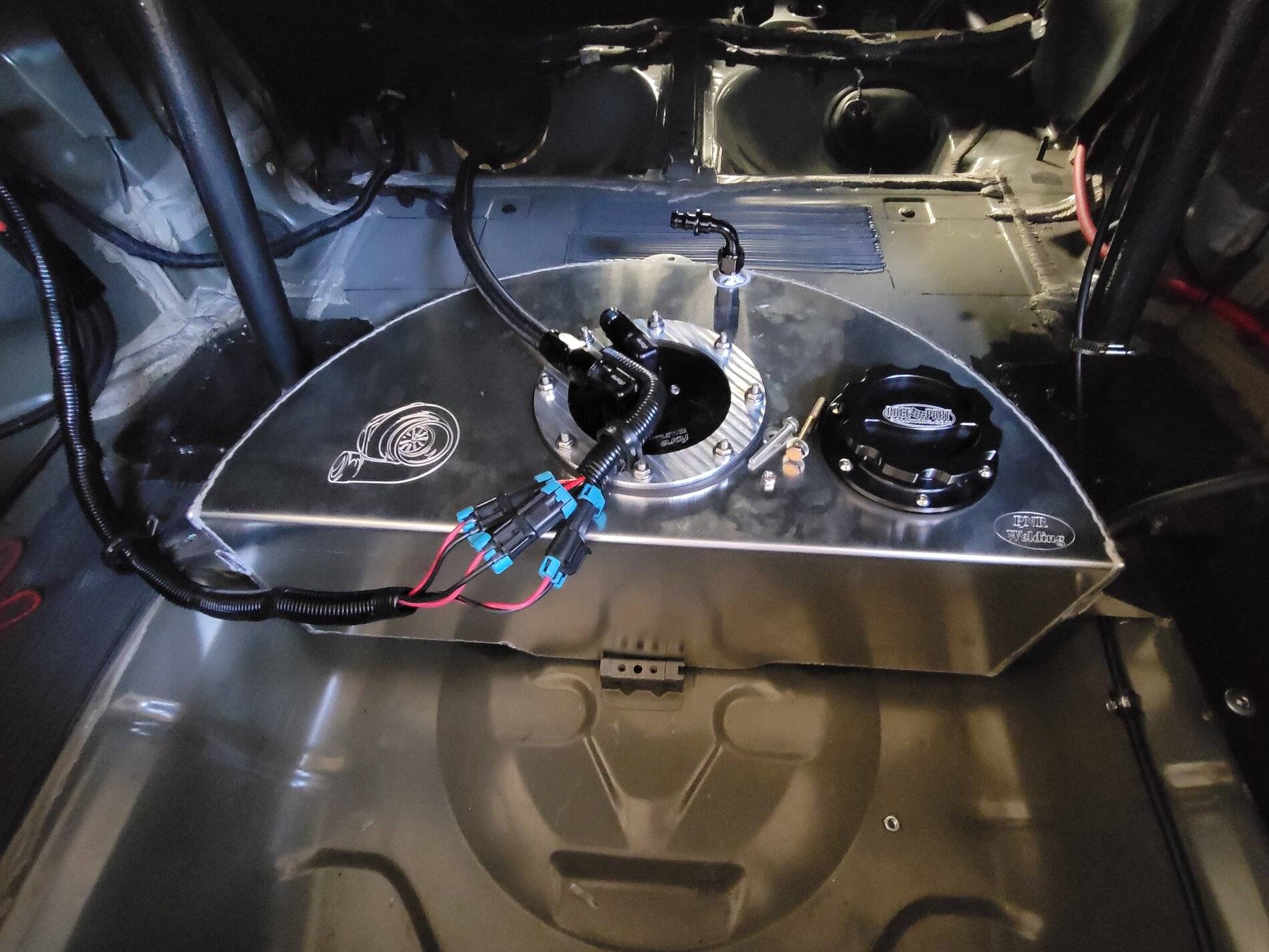

Looks good!
what’s the tank being used for?
First thought was for a W/A intercooler, but the lines look small and the small cap would be difficult to get ice into. Is it being used as a fuel cell?

Looks good!
Thanks
Ken
Yes it is a 7 gallon fuel cell that takes the factory style hat. PNR Welding did it in about 2 weeks.
Just curious. Are you doing away with your stock tank and pumps or integrating the fuel cell into your factory set up for a dual fuel system that you can switch between?
Thanks
The fuel cell is just like the factory setup. I did away with my factory tank. I won't be switching back and forth.

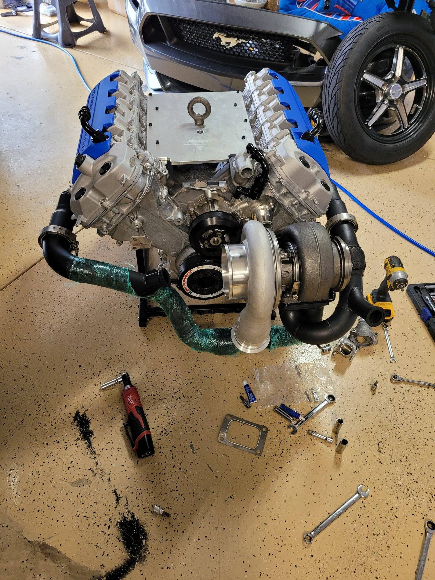

Very nice! Whats the engine details and what th400 did you decide to go with?
It's an FFRE engine and I used JPC Racing for the trans kit. I went with thier stage 3 kit, it's built TSI.
Sleeved with orings.
Stock Gen 2 heads, cleaned up with stainless valves
Manley Rods/Pistons
Boss crank
Stock compression
Unfortunately I used a new gen 2 block so its only got 11mm head studs, we will see how much boost it will handle I am shooting for 25+.
Manley Rods/Pistons
Boss crank
Stock compression
Plazmaman intake
i doubt you'll have any issues lifting a head as long as you used head studs.
