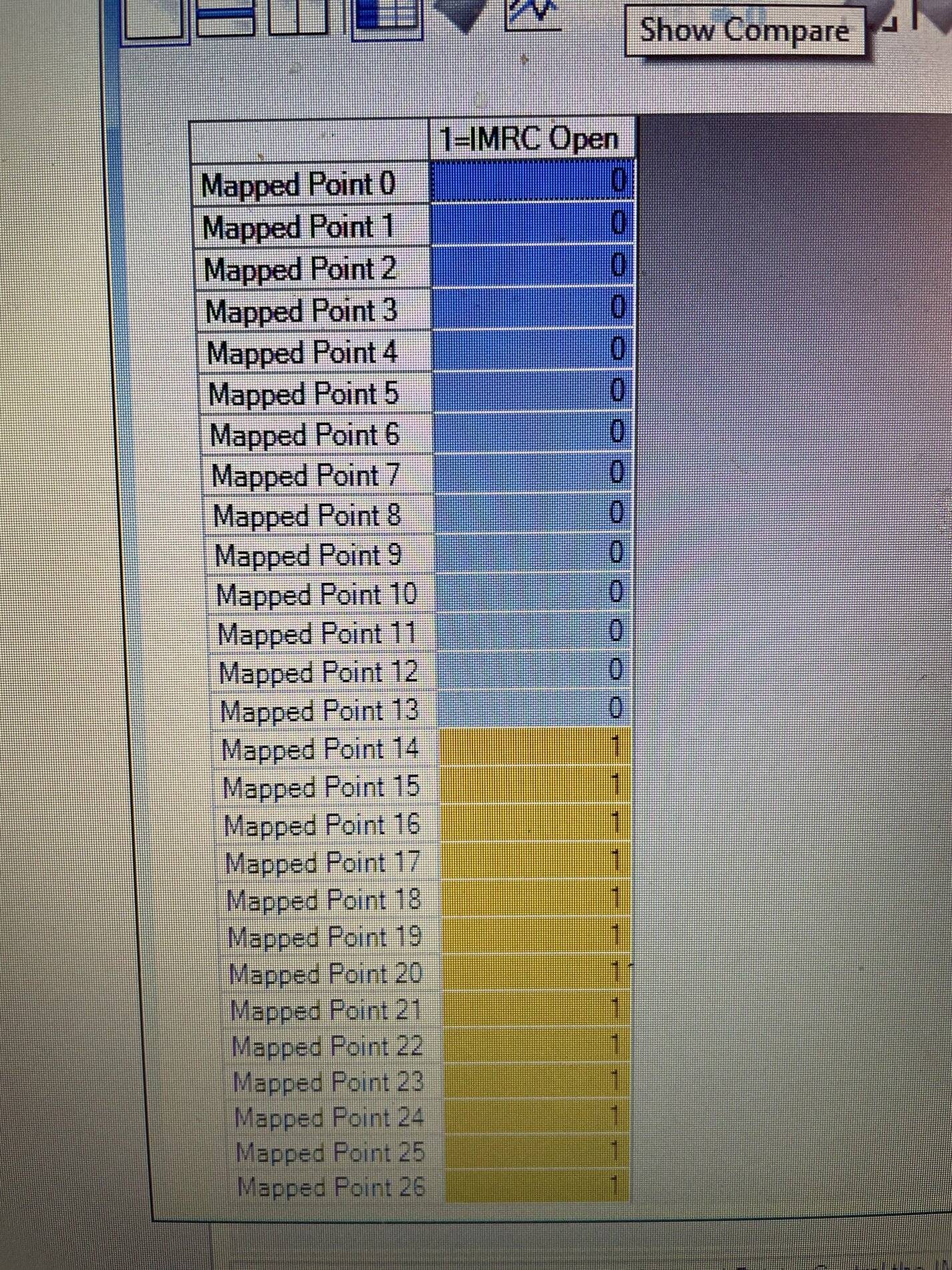

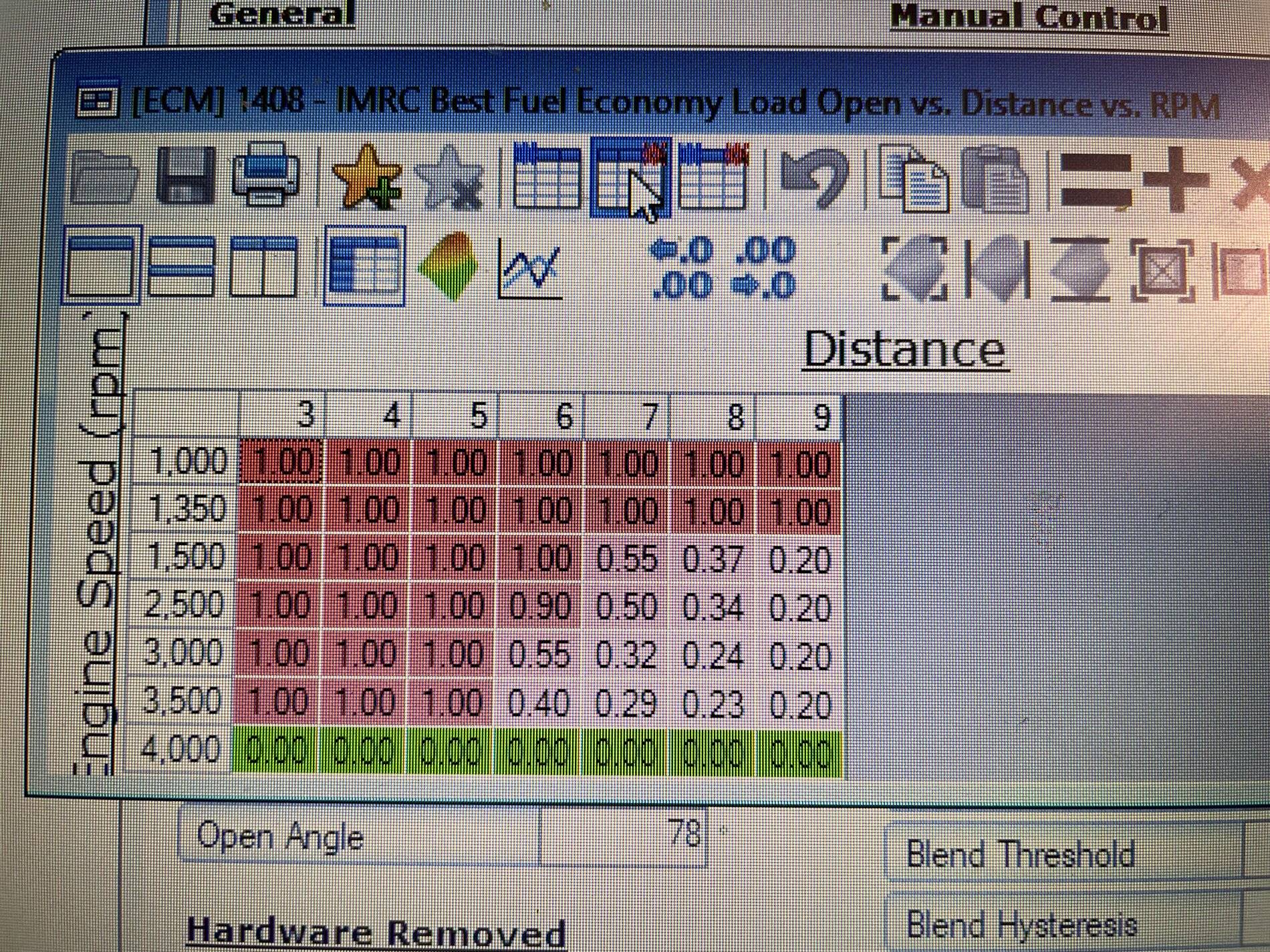

It’s not that simple. It’s open at map 14 and a given load looks like this and a lot more

Don't you just tick IMRC CLOSED and copy everything from IMRC OPEN to IMRC CLOSED ?
Come to find out, this is the incorrect way of doing it.
