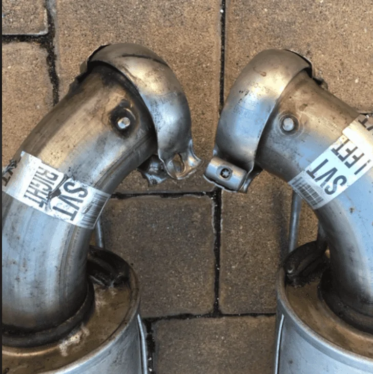

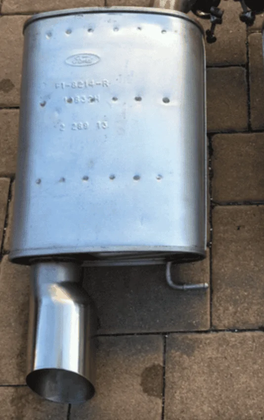

You can look at the part numbers, I have them on my 2011
You want the 8214's they are stamped into the case of the muffler. Not the 5230's
They also have a SVT label on the inlet pipes which will be 2.75"

This ebay post is gt mufflers that visually matche 3 lines and single tip, so I think stamped part # is essential for correct identification. Correct me if I'm wrong.
P.S. Also found mufflers that are sold as a GT mufflers but have 8214 part # stamped.
https://www.ebay.com/itm/3152846760...fOOUIcvRnO&var=&widget_ver=artemis&media=COPY
Interesting, off the dome i didn’t remember the GT looking the same. But I stand corrected, best look at the number.
I had them on my car when it was near stock. They sounded great
