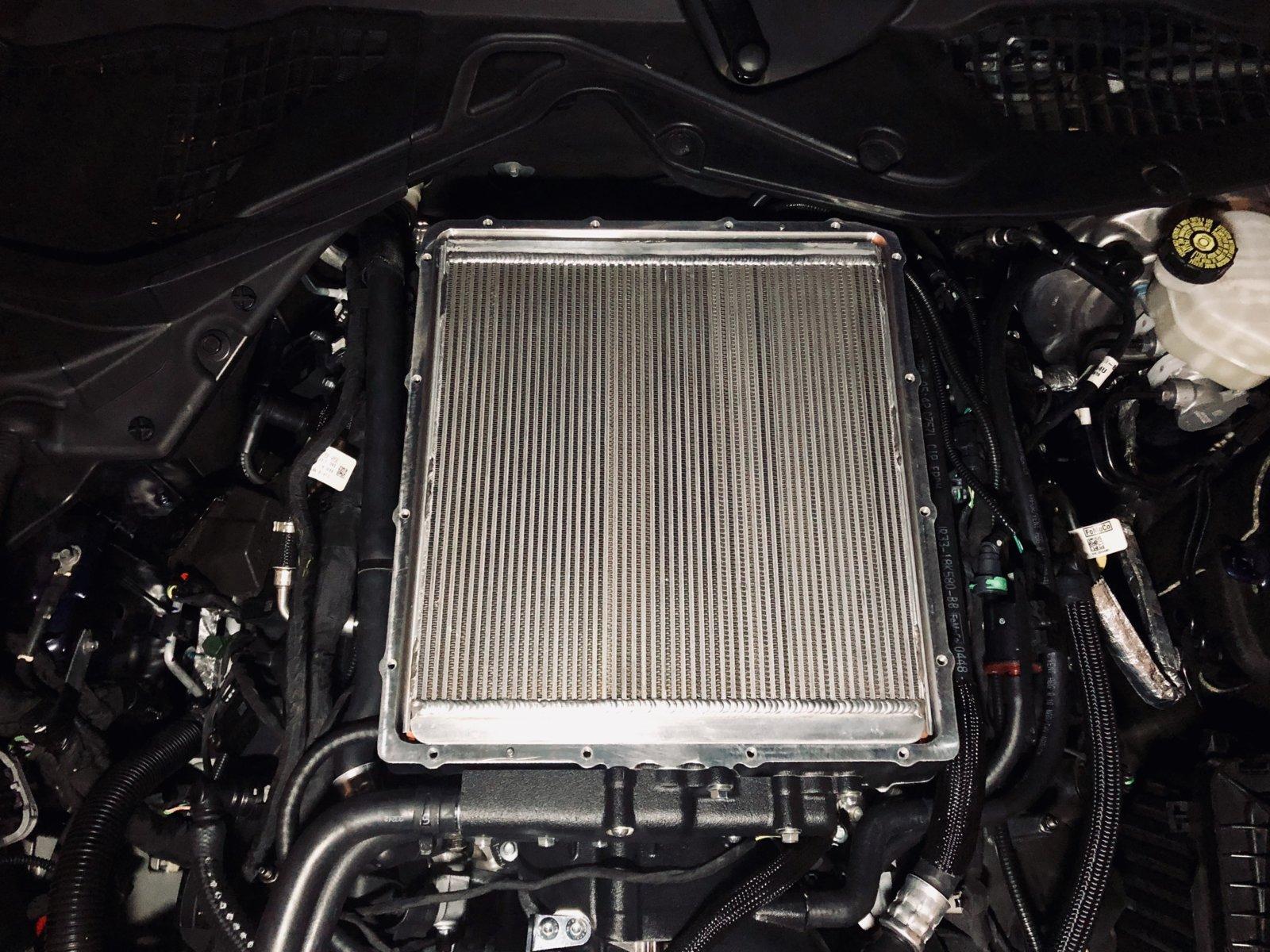

The Whipple warranty is pretty close to what the Roush Warranty is, and they both suck so I wouldn't be looking at the blower based on the warranty that you can get from them to cover the engine. You don't need to add anything to your car with a Whipple stage 1 or 2 kit that you wouldn't have to add with the Roush kit, so that shouldn't really be a factor. The nice thing is that the Whipple should give more room to grow as the inlet is not restrictive like the Roush. The other kit I really like is the Edelbrock kit if you want a TVS blower vs. a twin screw as it is the same rotor pack as the Roush, but with better intercooler, and less inlet restriction.

The Edelbrock 2650 is also doing great. I don't think you can go wrong with either one.
The Roush blower doesn't look to be designed as well as the Edelbrock.

Def check out the Edelbrock, their stage 1 comes with their warranty if that is something that you want to keep. The Edelbrock's design is also more efficient than the Roush not to mention their intercooler is much larger and also helps make it better than the Roush unit.

I have been looking at the Edelbrock after a few comments from you guys and looking into it a bit. Their warranty seems to lie somewhere between Roush and Whipple's offer and the actual blower seems to be better than the Roush if for nothing else the improved cooling. I usually spend a lot of time reading the forums, little time posting... Glad I did! Thanks and please keep the comments coming!
