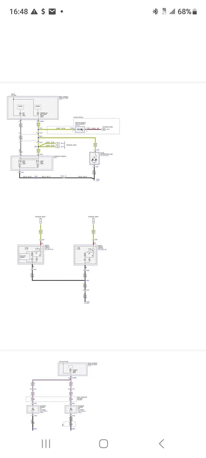

If you have the tools/skill set you can get a DVOM and test to see if the lock is getting the unlock signal. The following wiring diagram is from my '18 FSM, maybe it will help.

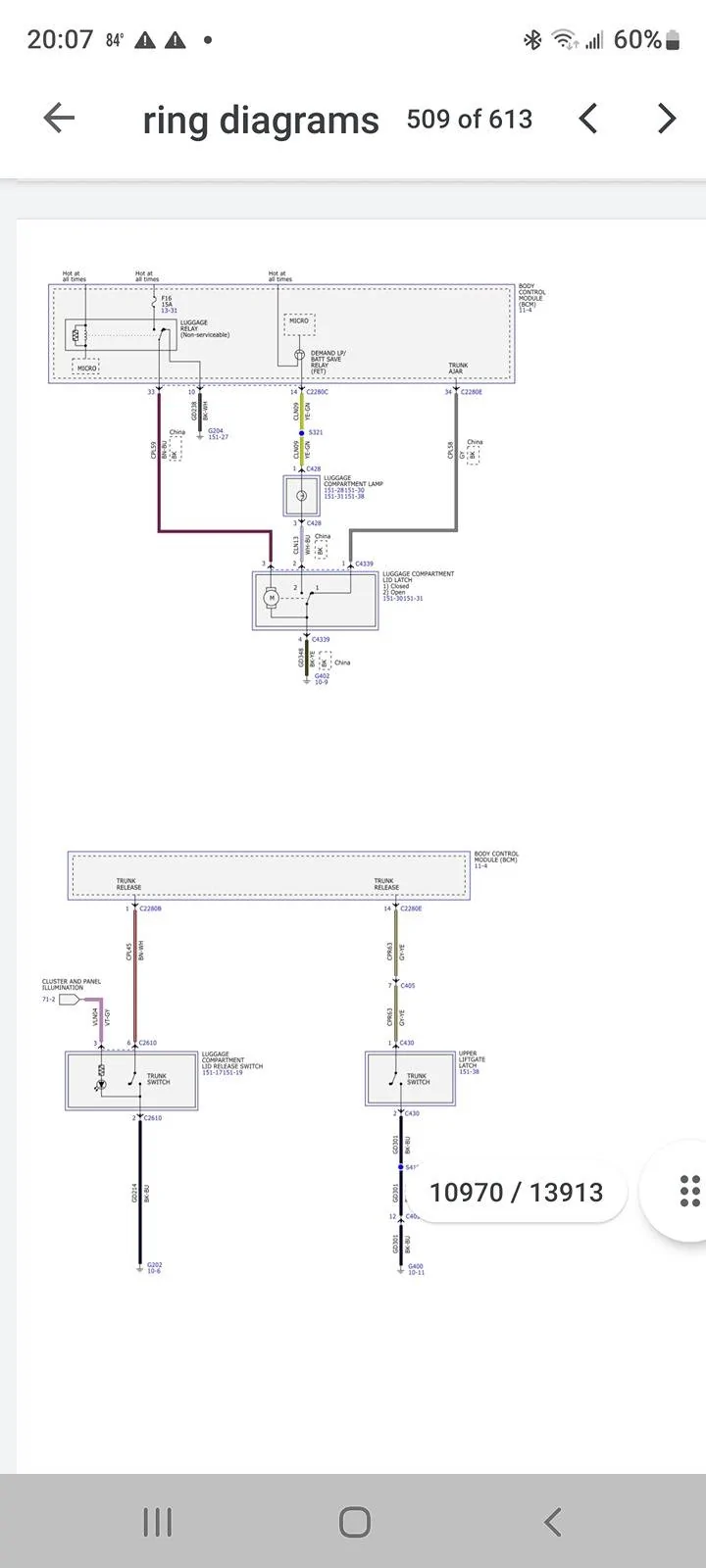

Just realized I linked the diagram for interior lighting. Sorry. Here's the one for the trunk lock/release.

Thanks. That’s way over my head!
