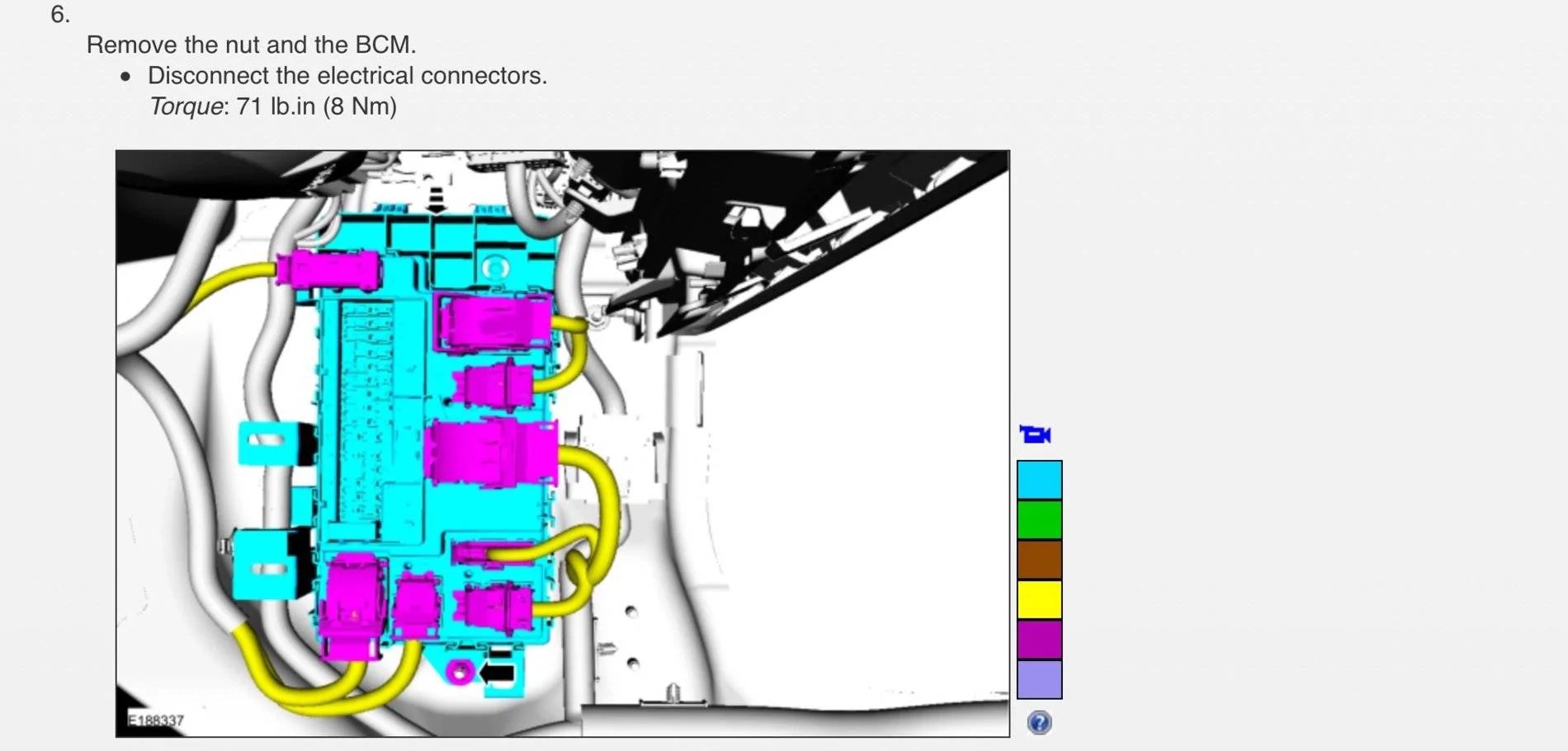

I was curious how the latch was powered, which fuse supported the latch.
It isn't documented in my Owners Manual. The fuse position is labeled as "not used". But from one YouTube video, several thread posts, and the attached, internal fuse panel, fuse position 16 powers the release latch. Have you checked that fuse?
The panel I'm referring to is in the interior, right side, near the door and where someone would place their feet. I've attached some references.
Fuse #16 is a 15A fuse. It sits opposite of fuse #34.

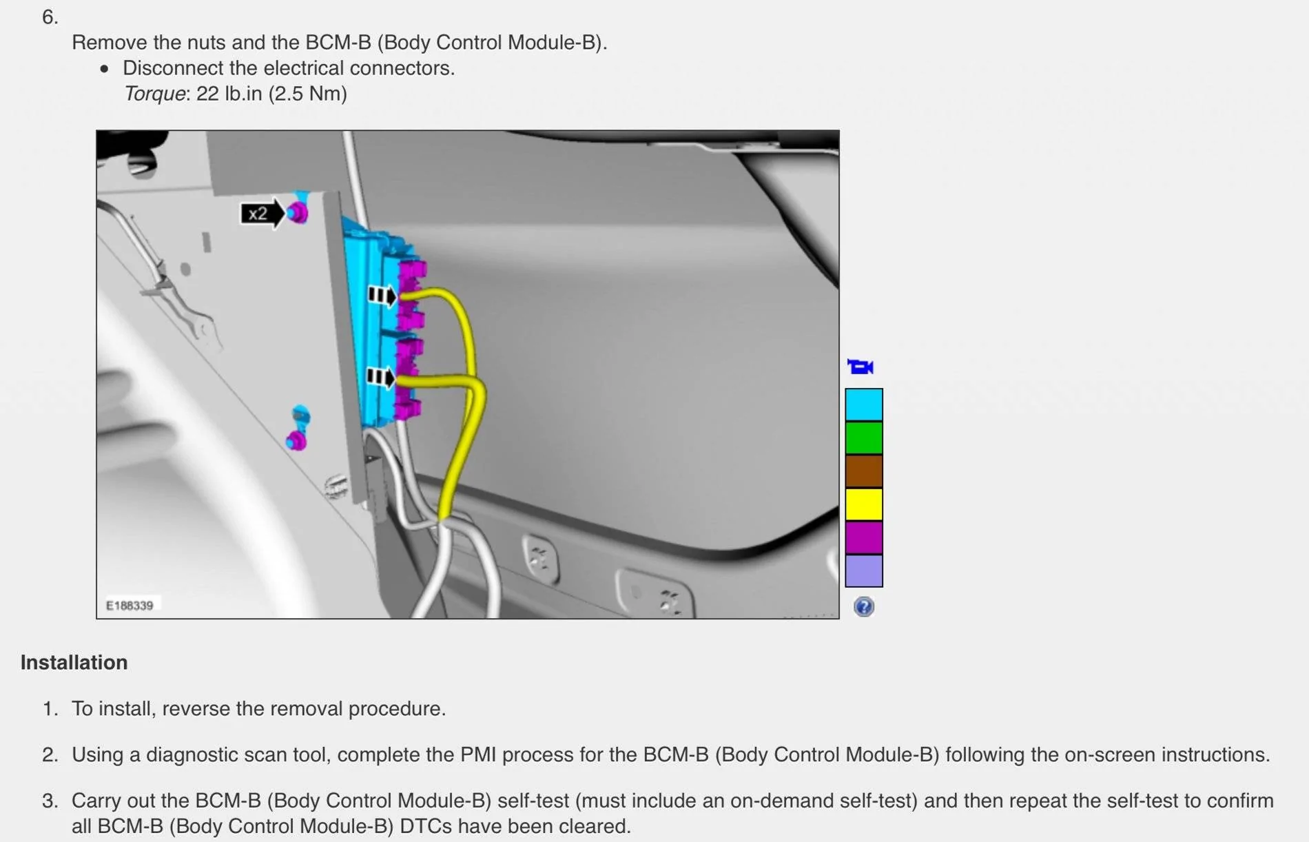

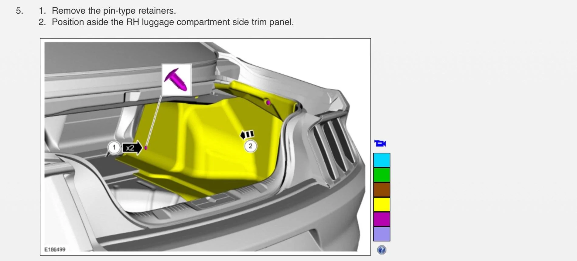

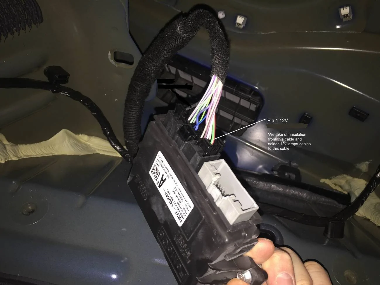

The thread is new and the day here in the US is still young. Other Members might have better ideas. The only other action I can recommend is to begin physically tracing and checking wires all the way back to the BCM in the interior.
In the trunk, there is a second BCM, BCM-B, on the same side of the vehicle as BCM-A. Your tracing might initially lead you to this general area, and ultimately back to the fused connection at interior BCM-A.
From my references, BCM-B has no fuses. Just two, large physical connectors, supporting wiring and functions in the rear of the car. While checking, I'd confirm these two connectors are seated well.
