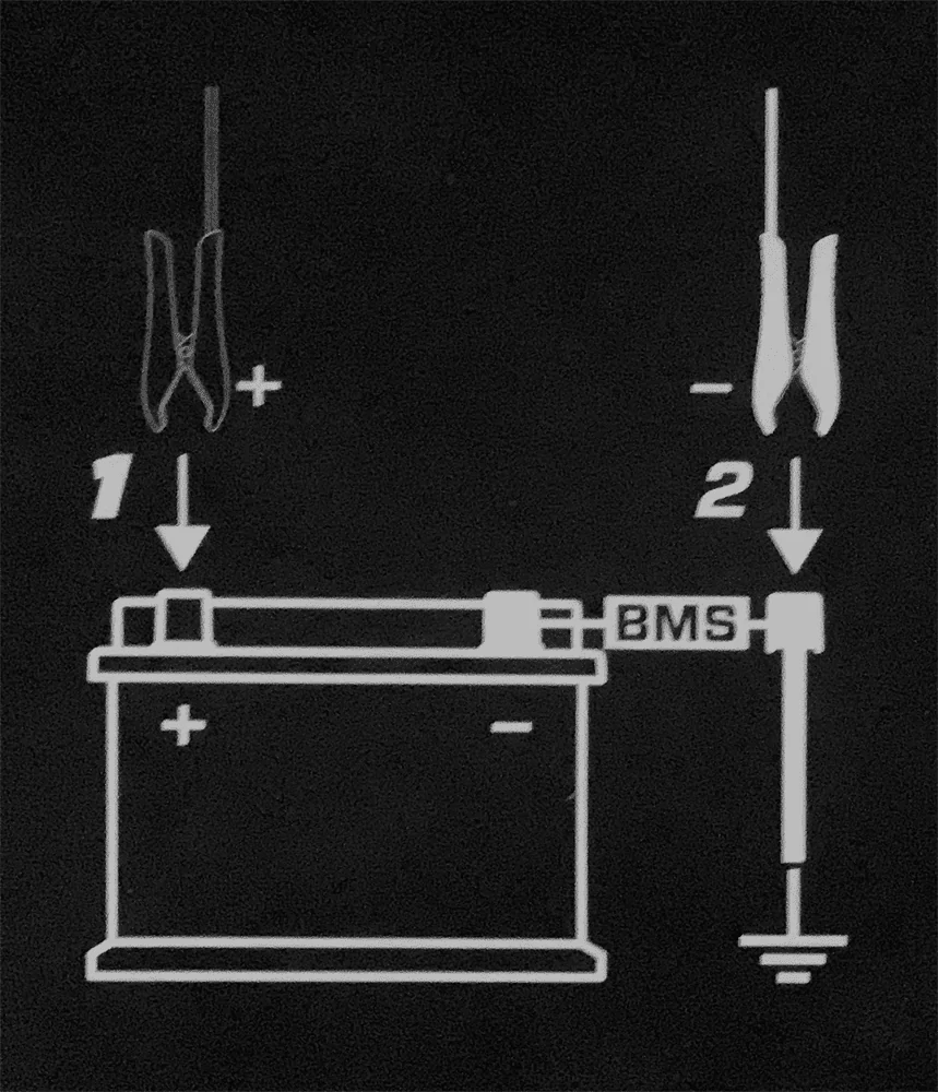

The negative lead of the battery tender needs to be connected to a chassis ground or the battery charging monitor will not know the true state of your battery.
Your car could think it jas a 3/4 full battery, when in fact it is full because the charge put on it was not monitored.
Positive lead of the battery tender lead to the battery or + lead and the negative lead to a chassis ground.

Why would the neg go to ground rather than the battery terminal ?

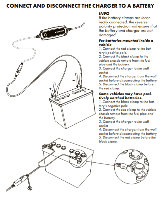

The chargers are looking for small voltage increments to determine their actions. Adding extra connections and / or extended voltage paths will increase the discrepancy between the real battery voltage and the voltage that the charger sees (I accept that some compromises have to be made if you need an extension cable due to charger / car location restrictions etc).
The text from CTEK is confusing, but the diagrams are clear :
I assume 'fuel pipe' should read 'negative cable' or similar ?

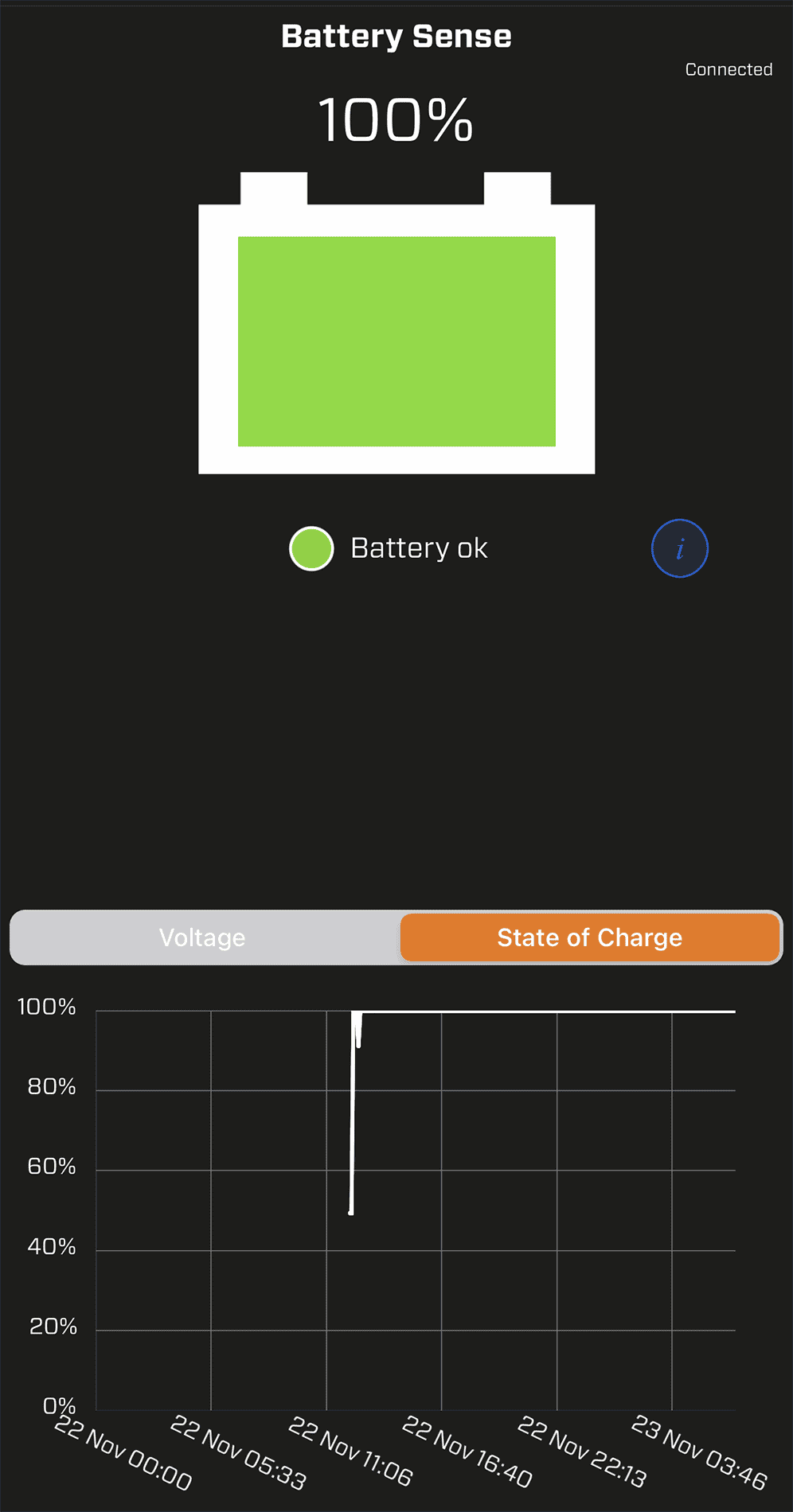

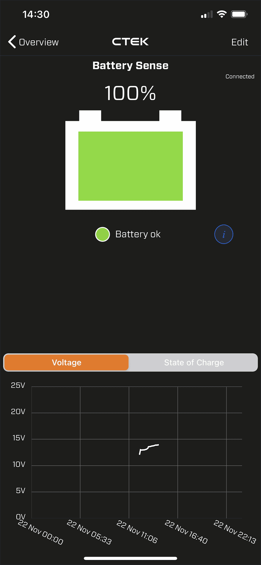

WD: The Physics involved are long gone from the brain cells here and all I know is that connecting both the charger and the BT Battery Sense module to the same positive post at the fuse box...works, or at least APPEARS to work. Mine charged last night and when I checked first thing, Mr. CTEK gave me a thumbs up with a green light, fully-charged indication.
KB
Edit: I keep forgetting about the damn BT thing. <laughing>
Yep, Smarty Pants Smart Sense says all is well, too. Pretty darn cool I gotta say. :cool:

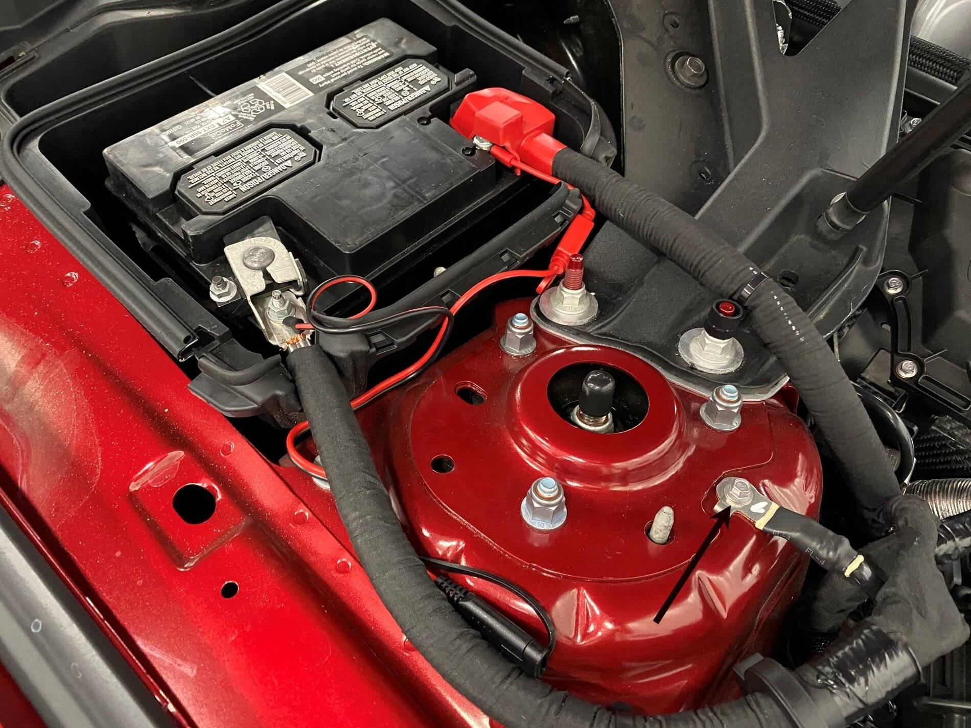

Can someone pls post a pic of the ground you used? It would be much appreciate for the not so mechanical.

This is one option, black arrow.

If you're talking about the blue jumper Tom, that's the Powerpoint Relay jumper that Earl turned us on to. That's the only one I used. Both the charger and the smart sense are using chassis grounds at the strut tower.
KB
You shouldn't need the powerpoint jumper unless you want your powerpoints to be hot all the time.
