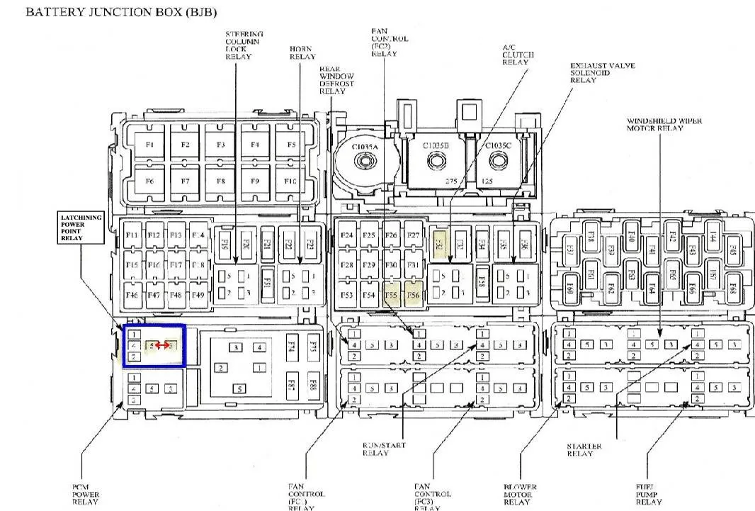

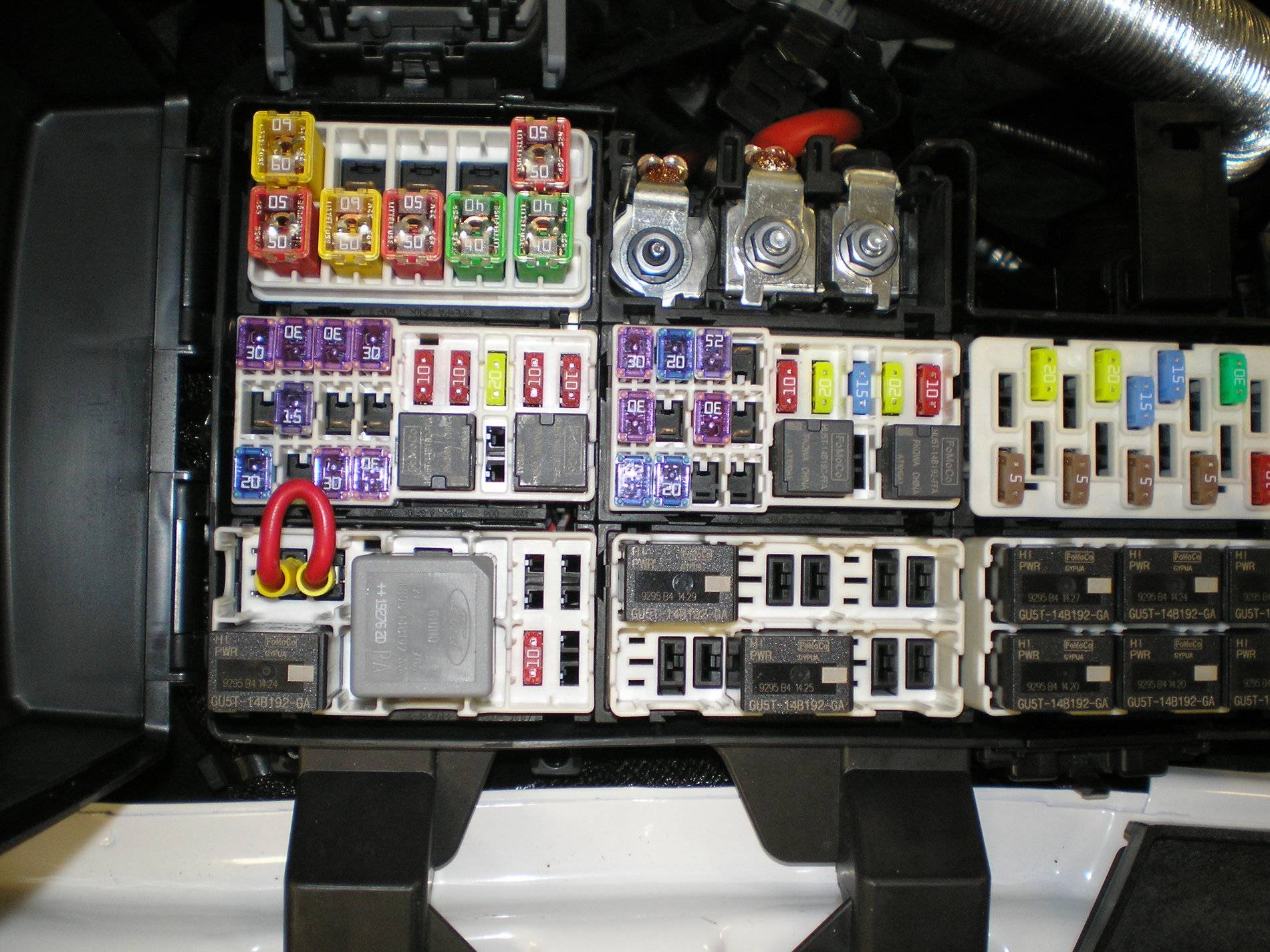

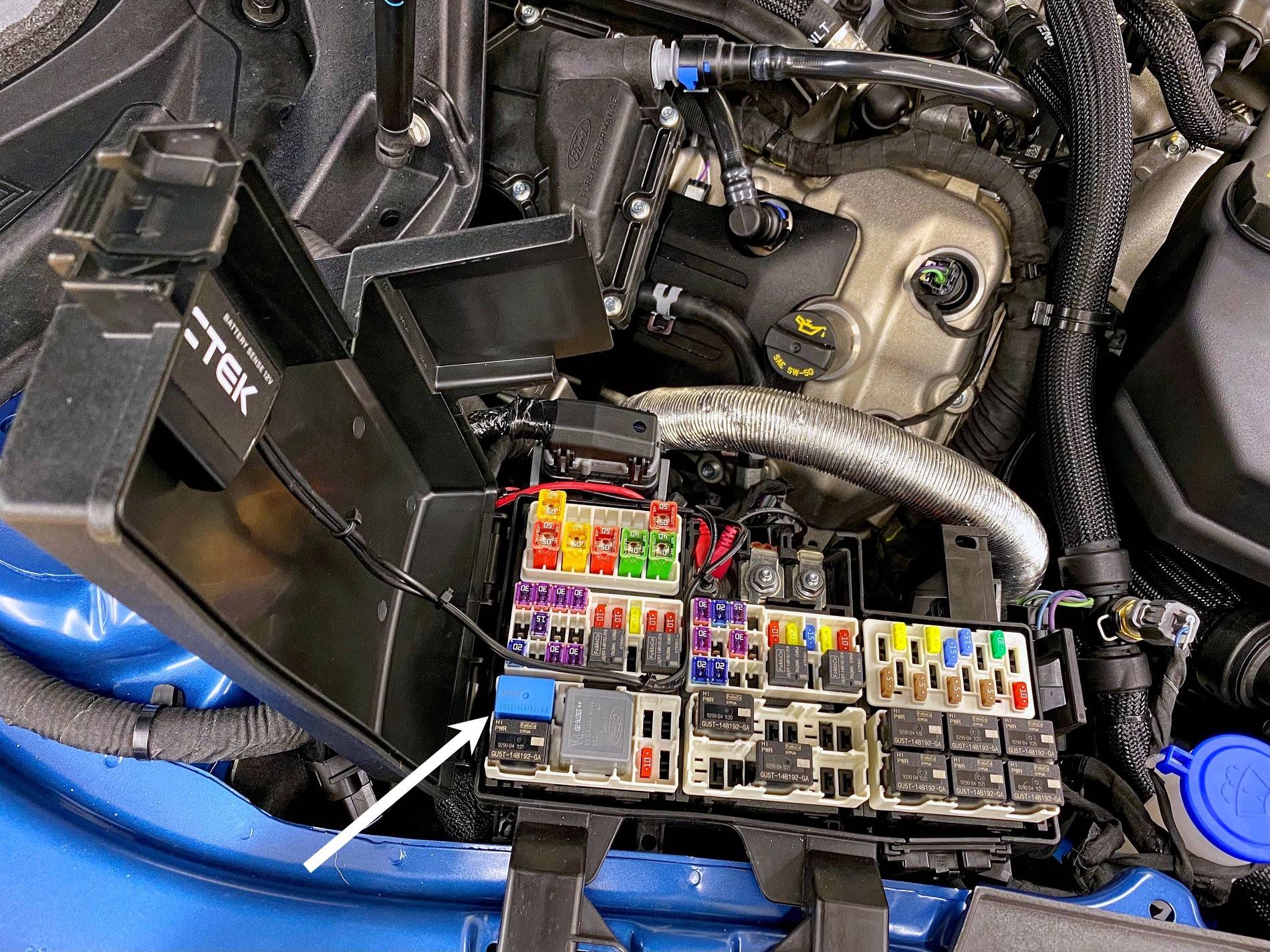

You have to remove the latching Power Point Relay and install a jumper wire between pins 3 & 5.

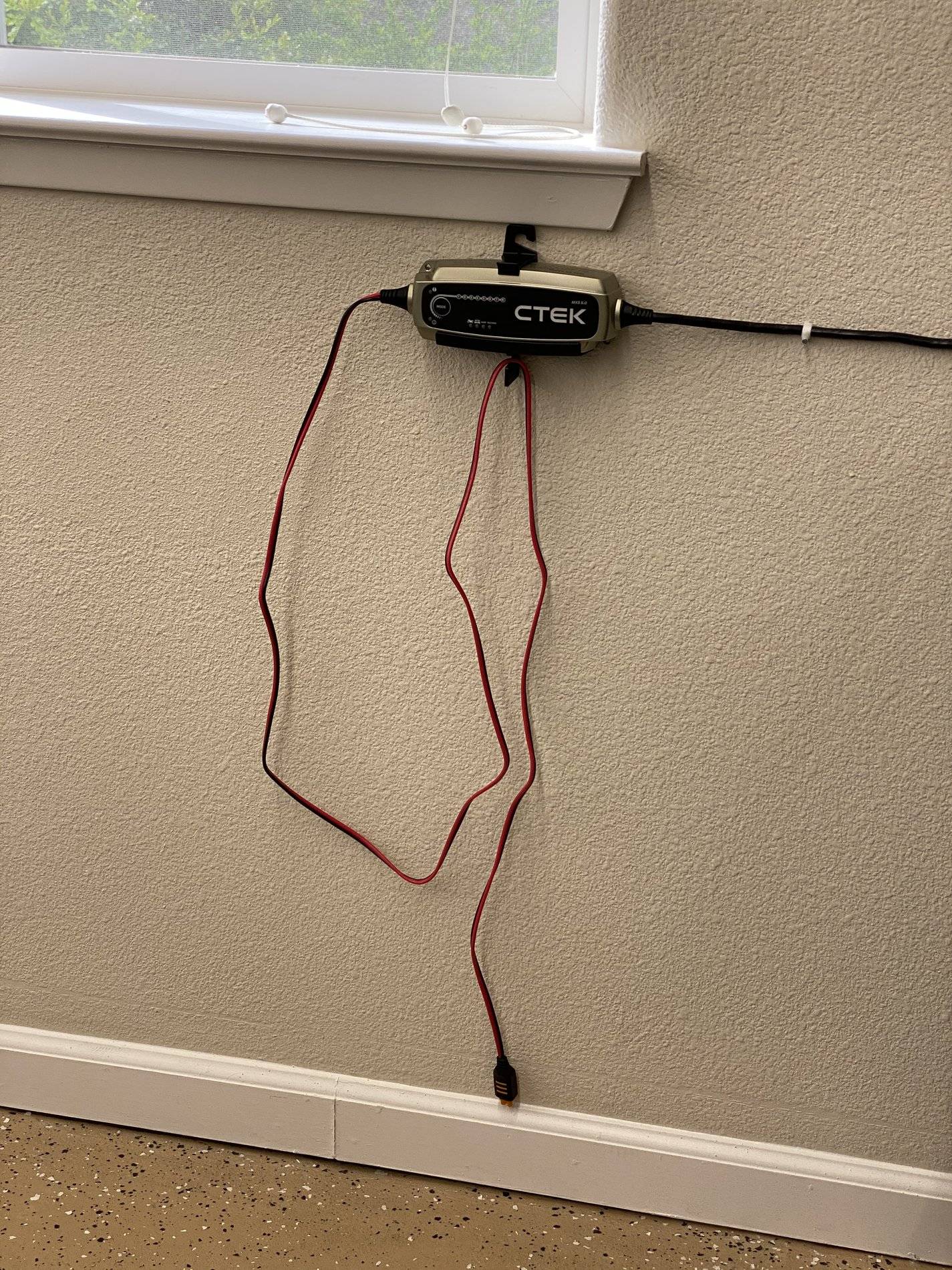

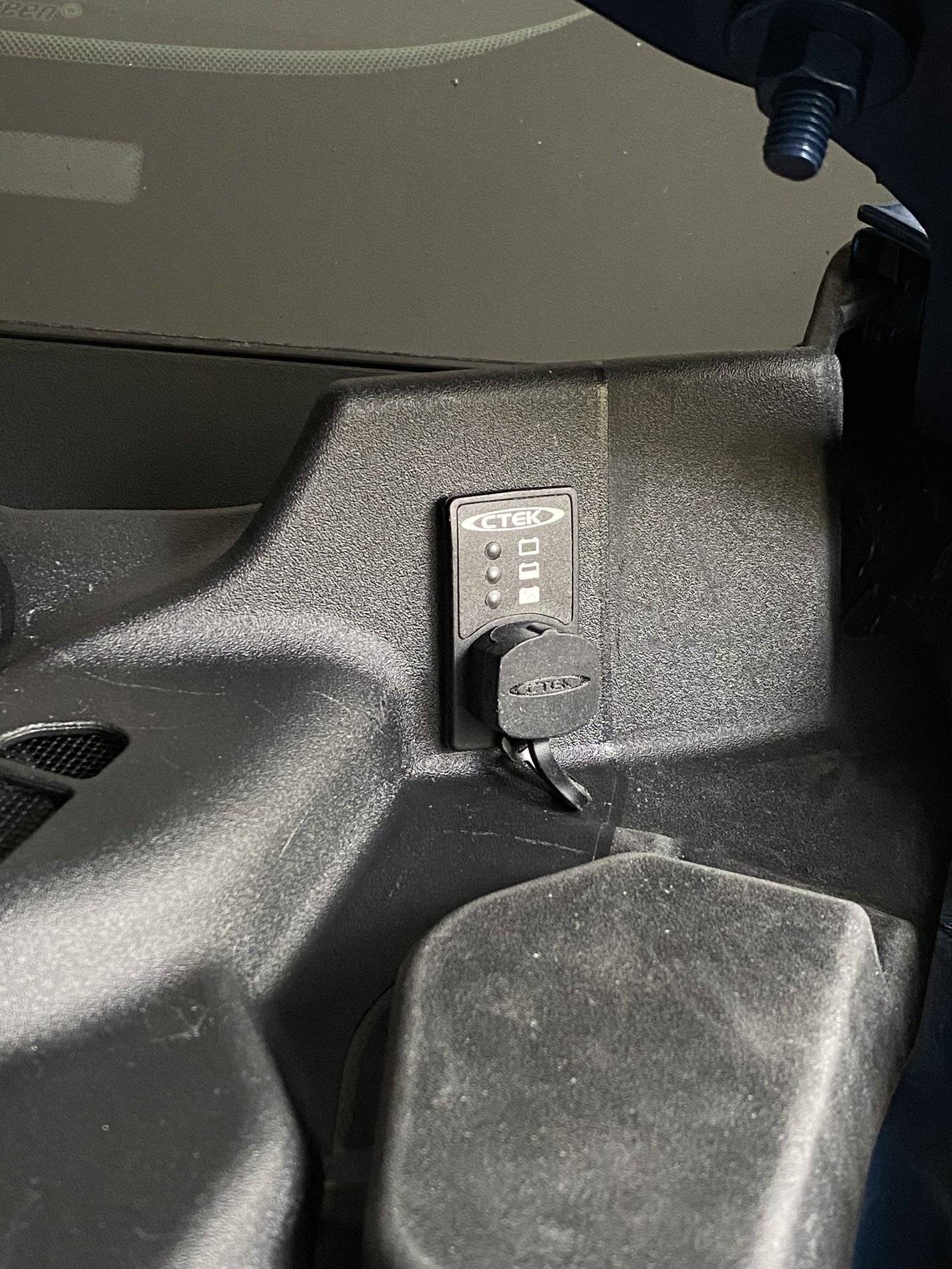

I added this CTEK remote plug in the engine compartment next to the left side hood hinge for the CTEK trickle charger I have on the wall next to the car. It is hooked directly up to the battery.
Earl, nice photo of the CTEK Battery Sense. :)
Thanks to your photo, I was able to easily point out the relay without disturbing you magnificent CTEK Battery Sense installation. :like:

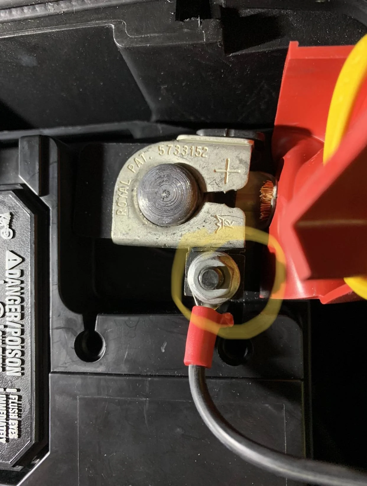

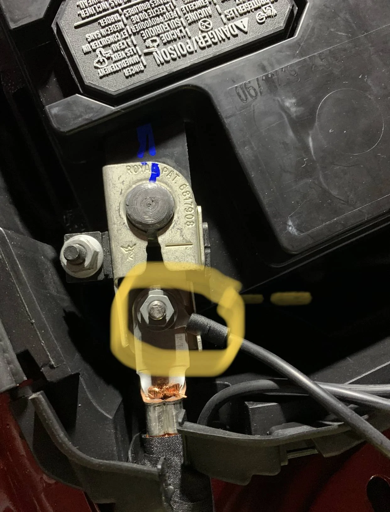

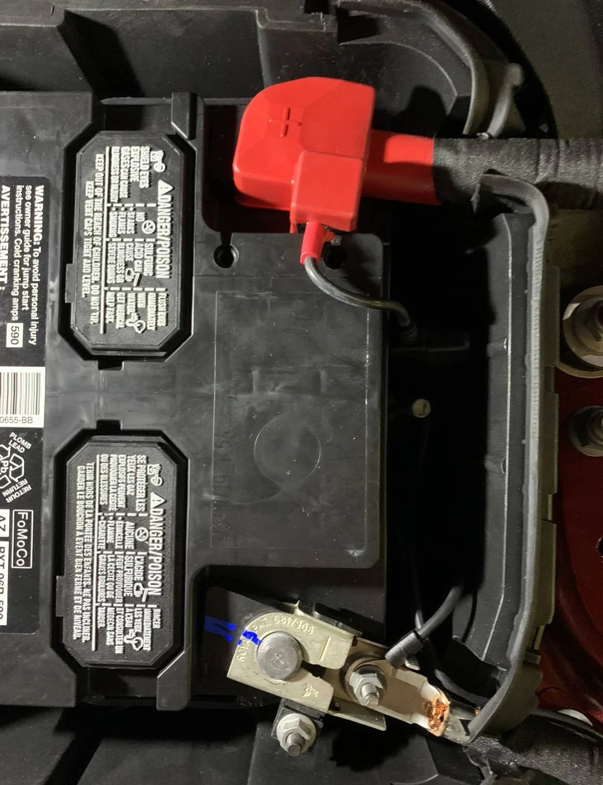

I use a battery tender. I hooked it up this way :
There is the negative connection
The positive connection attaches to the nut that holds the positive cable to the terminal.

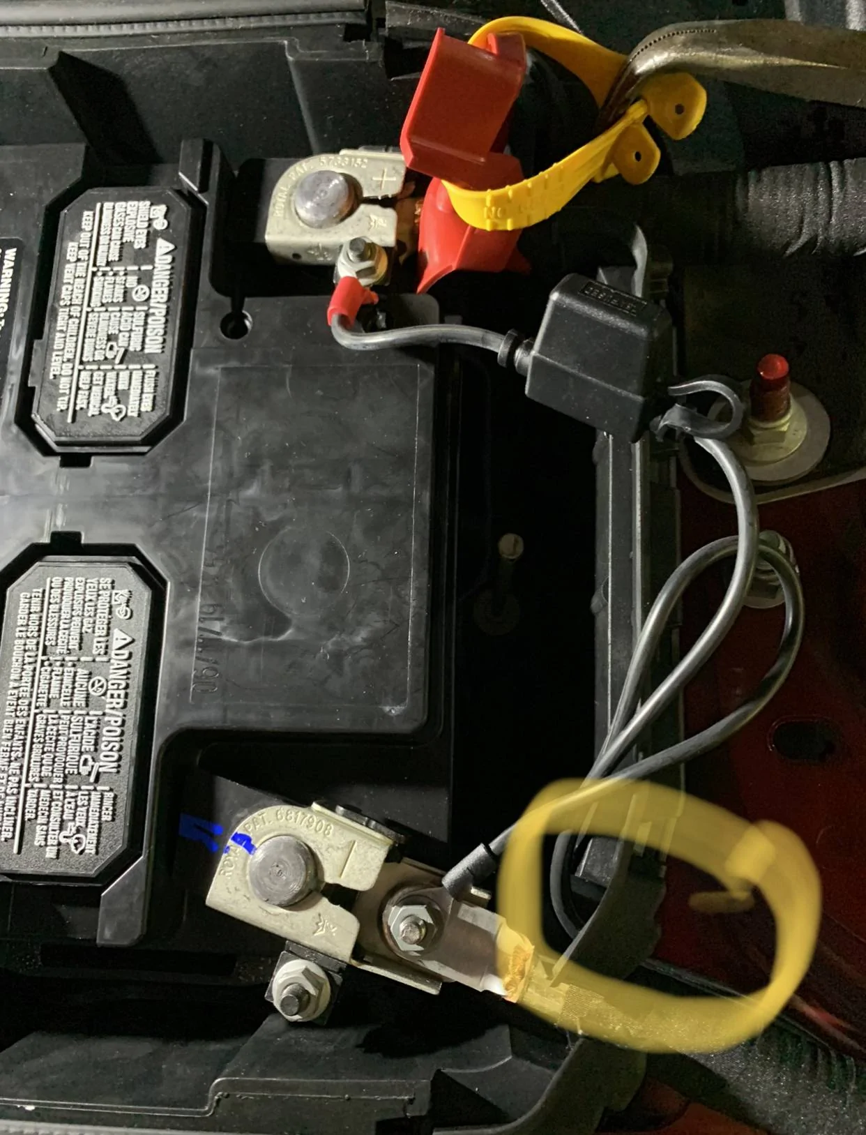

It looks like this. Yellow highlight shows how I tucked the charging cable next to the battery negative lead.

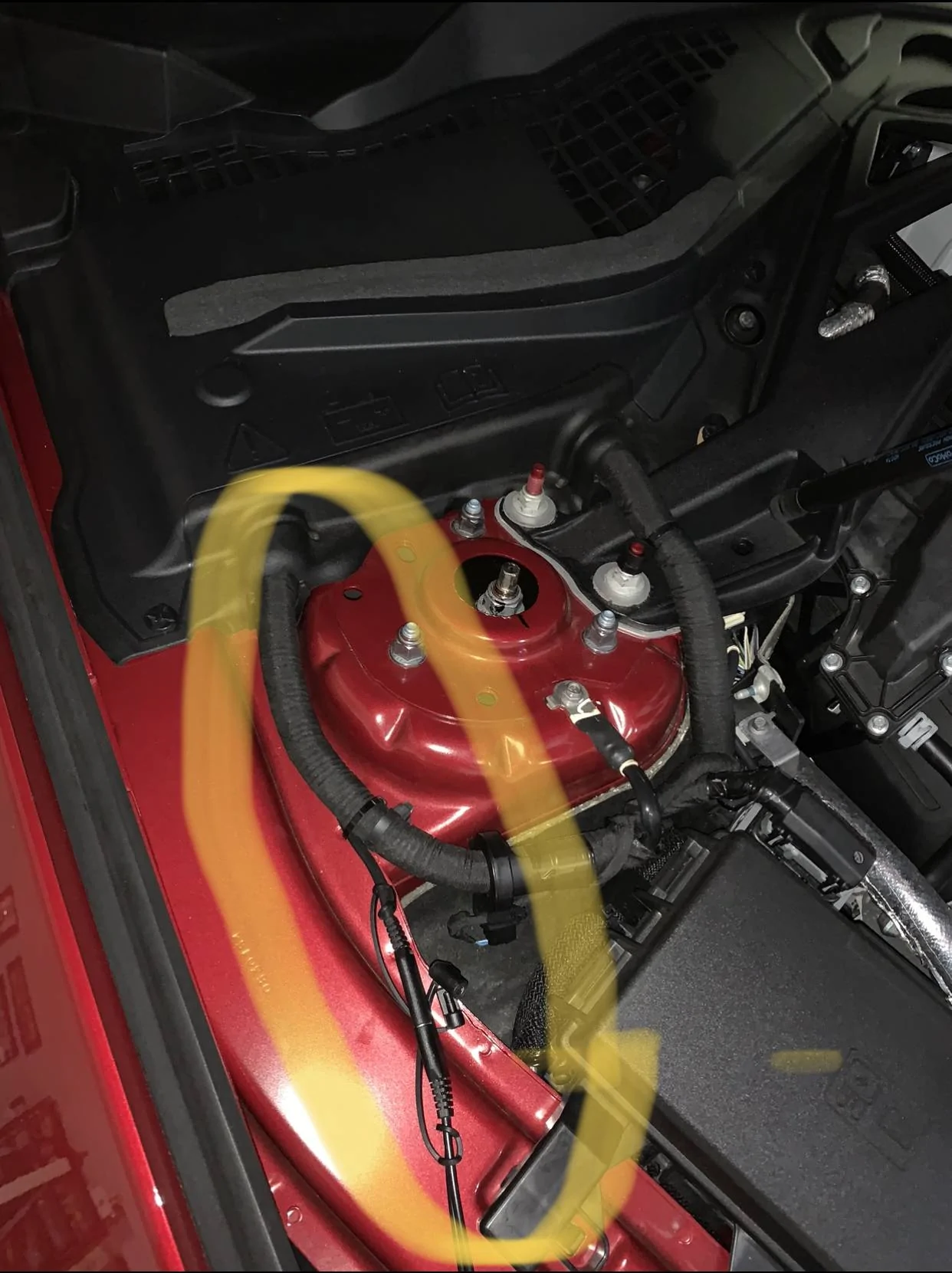

Tuck the cable next to the battery and install the cover.

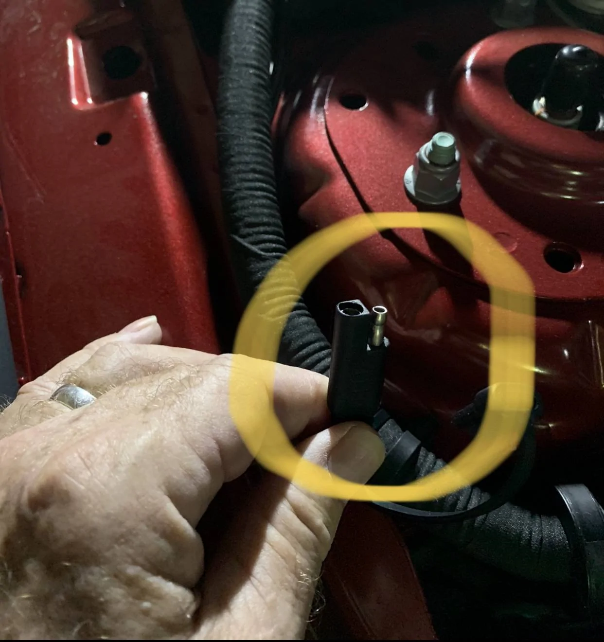

I zip tied the charging cable to the negative cable. Now plug into the battery tender extension cable and your charging the battery.
here a picture of the connection:
