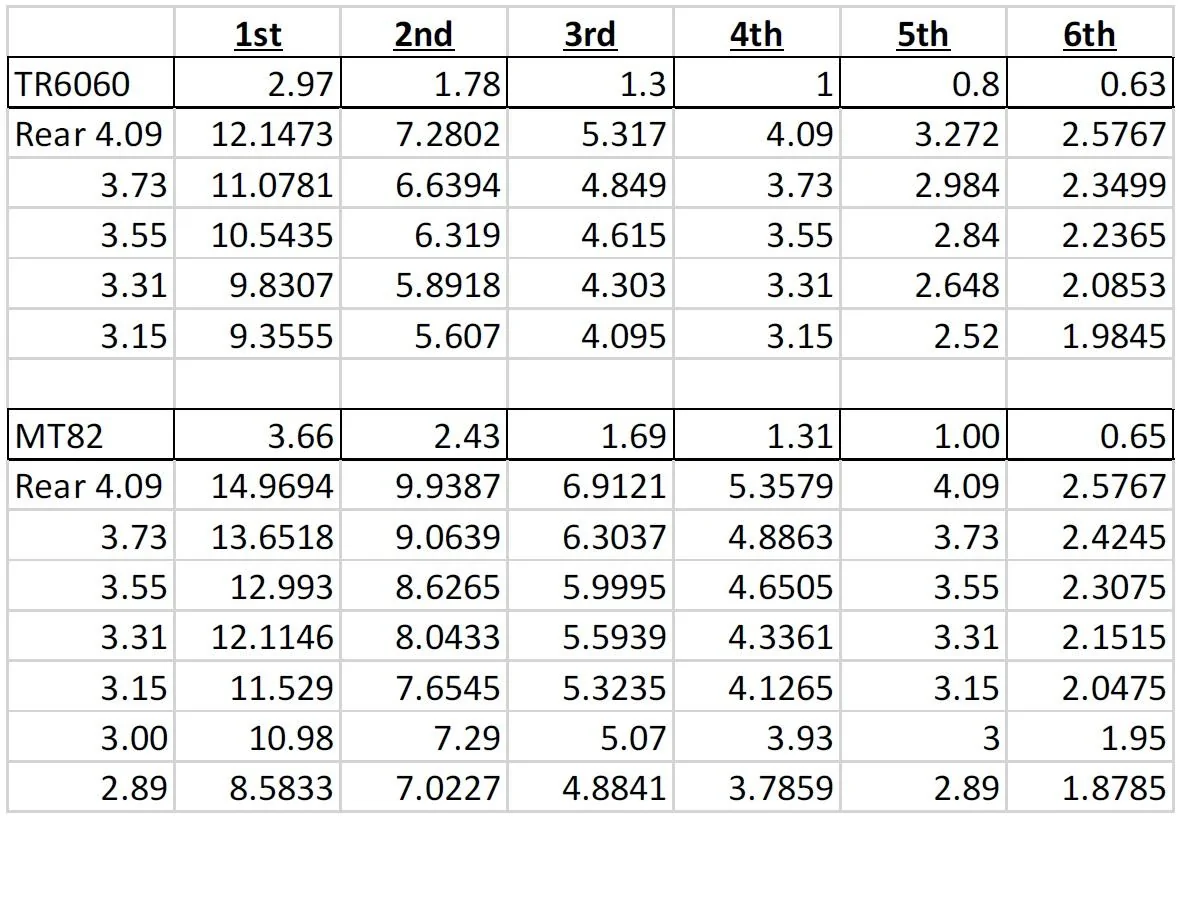

Yes...with 3.73's the Magnum or 6060 (with the 2.97 first gear) 1st would be equivalent to the MT82 with a 3.15.
Awesome. Thanks again for all of the info. Might just go ahead and do so just for peace of mind (and better drivability is always nice too, although i don't have too much of an issue shifting my MT82)

I run the close ratio gear set in my Magnum. With the RXT clutch it took a bit to get used to the tall first gear 3.71 rear end ratio and 28 inch tall tires. But now I am used to it it is fine. I find I rarely ever get into 6th gear most of my driving is in fourth.
T-56 Close Ratio Gear Set
1st 2.66
2nd 1.78
3rd 1.30
4th 1.00
5th .74
6th .50

If you do the swap absolutely go with the 2.97 first gear..NOT the 2.66.

I have the 2.97 with 4.09 rear and love it! I have never had an issue.
