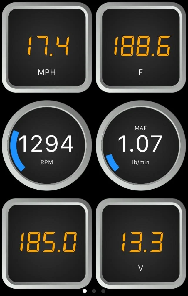

So I'm back from the autocross. Like Hack said the autocross would not get the tranny hot. Max temp was 134F.
On the way to the event I left the car in 5th and cruised around 80 for 10 minutes. RPM is around 4k or just shy of it at that speed. When I exited the parkway I took this screen shot of the apps dashboard. Tranny temp is bottom left, 185. This was the highest it got today. Ambient temps were cool at about 82F.
The Kiwi3 is pairing up with the OBD Fusion app reliably. Nice to be able to monitor the temp and not guess if it's getting hot.
