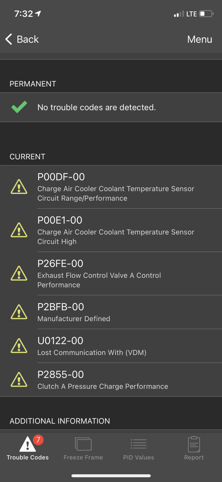

i ran my own obd scan and found a few codes in the Tcm. Problem has not reoccurred

What scanner do you have for the TCM codes
to show?
to show?
I use OBD fusion app with add-on software for our vehicle. The scanner used is really up to you.
