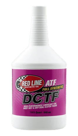

I ran BG in my 2019 car for sever thousand miles and liked it but switched to Redline DCTF Fluid and saw a pretty good improvement in shifting smoothness with ZERO cold nibble!!
I only have 5K miles on my 2022 car and have 3 quarts of Redline ready to go when I'm ready to go with it!!
