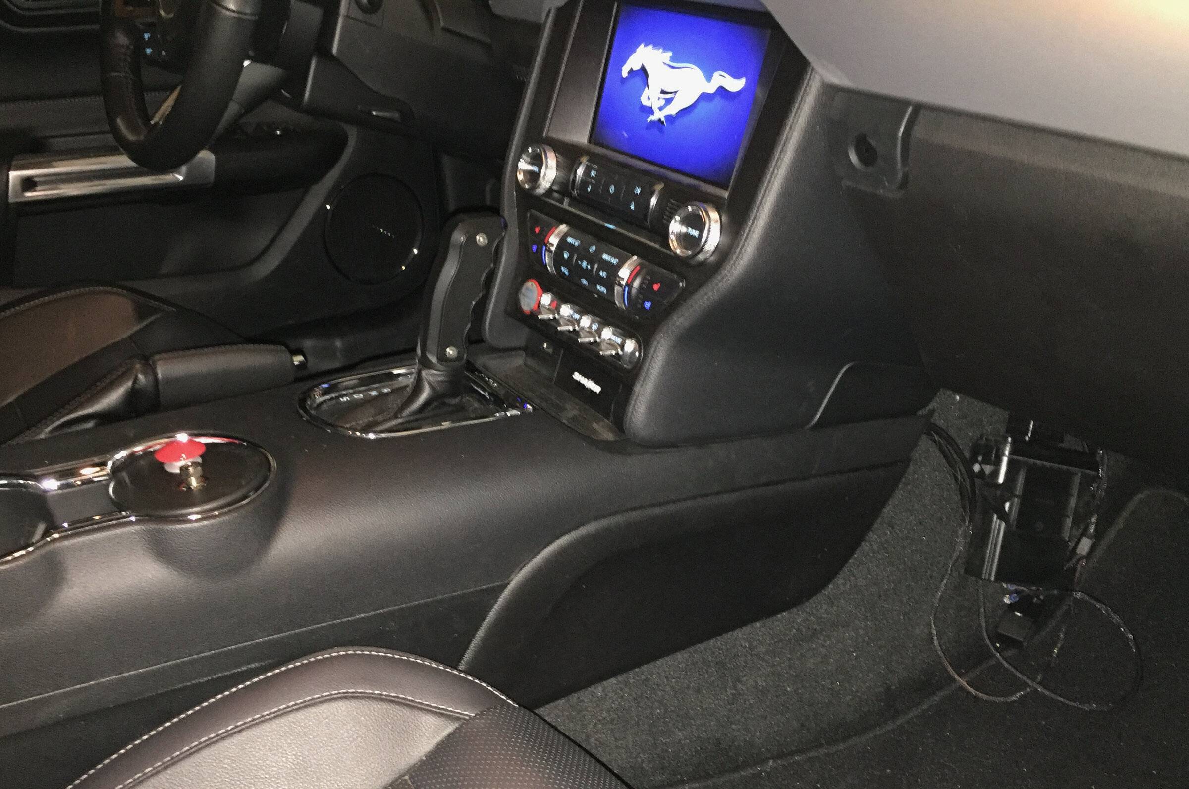

I'll find out for ya exactly how it works if our weather holds - got mine from Terry (BCR) today & popped it in a li'l bit ago, figured I'll zip-tie everything under the dash once I'm certain I've hooked it up correctly!

Just got it this afternoon and hopefully will be able to test it tomorrow before the snow starts flying again. Definitely an easy install, sure hopin' it works as advertised!

Well, so far I'm still waiting for Suncoast to come up with a solution to make it work on the 6R80. With everything hooked up according to the provided instructions the TPS won't send a signal to the throttle body to allow anything but idling in normal driving mode. The launch controller works exactly as it's supposed to when activated according to instructions - it's just that you can't give the car any gas when driving anywhere.
Suncoast did try a workaround that they thought would solve the issue but it did not work on my car. They are supposedly working on a next gen controller that will work on my 6R80 but haven't heard anything from them since 20 January so perhaps I'll give them a call today to see what, if any, progress has been made.
To be fair, this issue seems to only affect the 6R80, not the 10R80 so perhaps someone that bought one for their '18 & up can chime in about their experience.
