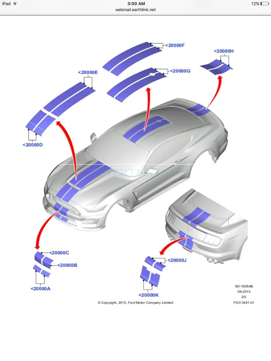

I have the PDF stripe part diagram with corresponding part numbers. They are not cheap. Mcars fan has regular black stripes that could be made for a lot less than what Oem will cost. I'll see if I can dig up the diagram
Edited to add:
I found the parts diagram but it is a PDF. Contact Mike Ruhburg at white bear lake automation parts and he will take care of you. You will need your VIN. AGAIN, NOT CHEAP

Also on the stripes, you buy just the pieces you need. And yes even single stripes are expensive for what they are.
