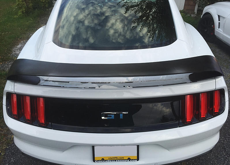

It looks from the schematics that both the base/tech and track spoilers have only 2 mounting points, one on each end. See that they connect down to just one HN1 nut on each side. Compare to the R spoiler that uses the same holes but also an additional one per side connected to bolt HS1. Not sure what to think of the holes in the decklid near center, however, in the Shelby spoilers schematic. Hopefully they are not there if you want to change the spoiler. If you look at the non-Shelby spoilers, they do use the center holes and 4 or 6 HN1 nuts total.
