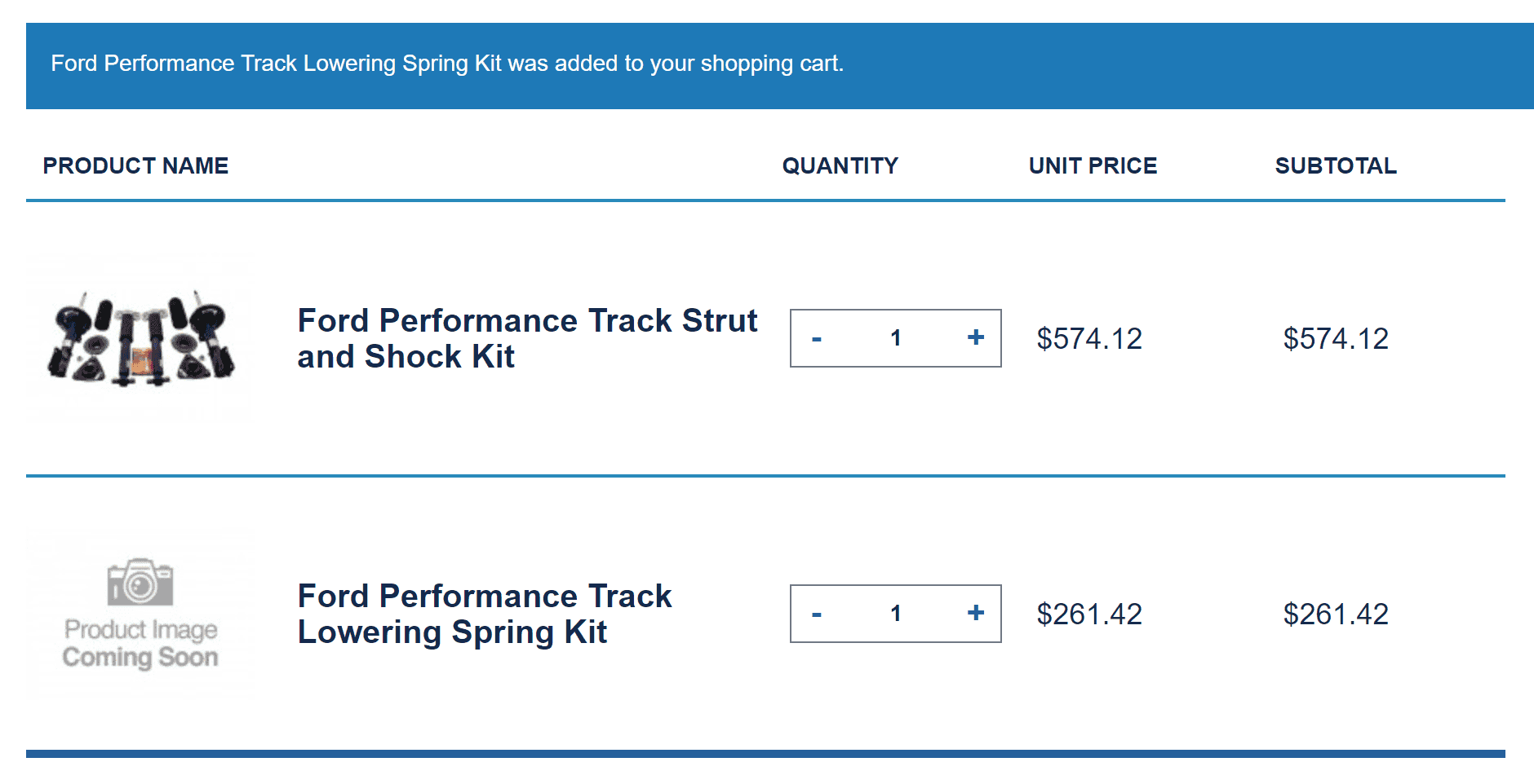

this is good info thanks. I'm about to pull the bang switch on either the track pack or this. right now its out of stock so I thought id just do pieces of it at a time. I've got a pp1 so I think the sway in the rear is decent but I want to drop it a bit and get better shocks and struts. do you think I would get 80% of the track pack with this?
Doug T
Jul 13, 2021
76
Pa
Doug
2020 Mustang GT PP1
IMO. If I had to do it all over again, that is the route I would take. I don't know if they sell the kit with the springs installed minus the sways and toe link. If they do. that would be the ticket. Now if you're trying to build a cone crushing HDPE autocross monster maybe not. But for the street it's really good. The BMR cradle stuff is a nice extra but since I did it all at once I can't say how much that helped. However common sense of how it works by locking things together is almost a no brainer. One reason I chose to do it all at once was because you have to drop the cradle to do the springs anyway so why not. Believe me once you start tearing into this job you're not going to want to go back in and basically have to do it again. Also might want to do the free front sway mod by drilling a second hole. Can't hurt and then you have some adjustability. Plus it's free. And as others have said make sure to have good drill bits. Hope this helps.
