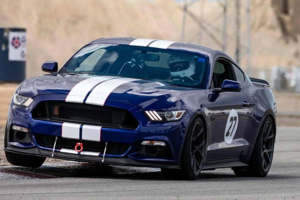

Perfect, that's what I'll do. On a completely different note...what toe-hook did you install?
I have the “ZL1” tow hooks (front and rear).
NvrFinished
Sep 11, 2015
1,035
505
So Cal
2016 DIB GTPP
You need to remove the front bumper to install it. The part that is a B**ch is drilling through the bumper/crash bar mount.
SgdriskillGT
SgdriskillGT
Jul 30, 2018
204
52
Alexandria, VA
Scott
2019 GT350R Ruby Red
I might not do the center one then...although I havent gone off track yet so I don’t know if it’s bad to be towed by a non-centered tow hook.
