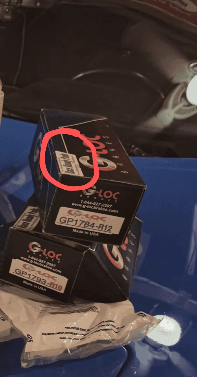

np, but now you have to tell where you got them for 100 loonies 😁
From a very nice guy, who unfortunately had to sell his track only car.
So right place, right time kinda thing.
this is what I got for a 100 Loonies:
*new*
Ford Racing M-6766-A50 Oil-Air Separator
G-lock front/rear brake pads
Ford Racing M-6731-FL820 HD Racing Oil Filter x 2
Ford FR3Z-19A412-B car cover
Ford 8U5Z-17B068-B Funnel x 3
Calliper /Differential heat sensors

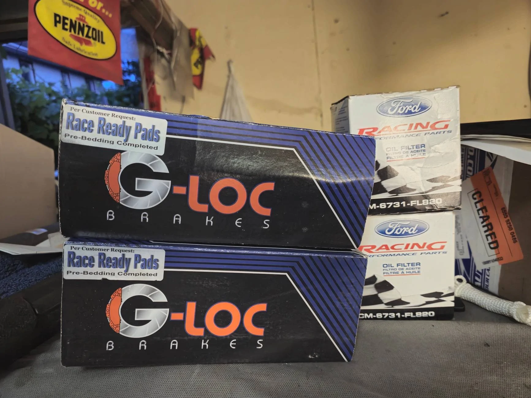

You need a sequence of increasingly high speed 75% power (i.e. just below ABS) stops, back to back without stopping at all, so your options to do this on the street surely pretty limited. Where you can go up to 100mph a half dozen to dozen or so times stabbing the brakes that hard without somebody rear ending you or calling the cops? Then you need to get the car cooled down enough and park it for 30 minutes to finish cooling. You're looking for an even blue-colored deposit on all the rotors.
I've done it on a Texas Mexican tollway access road, late enough at night, because there were some U turns where I knew I wouldn't have to stop.
Depending on the pad compounds you had most recently, resurfacing the rotors is either going to be really really important or possibly a non-issue. Since you're using these on track, I'd take it srsly.

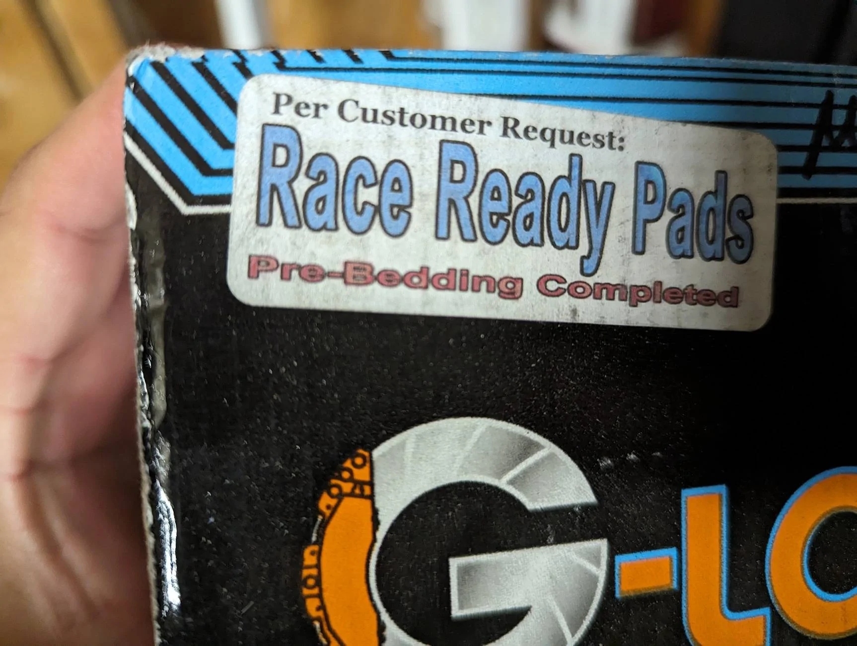

But they say pre-bedded. I'm still on the original pads.

Oh gotcha. Well just (attempt) to surface the rotors and call it a day.

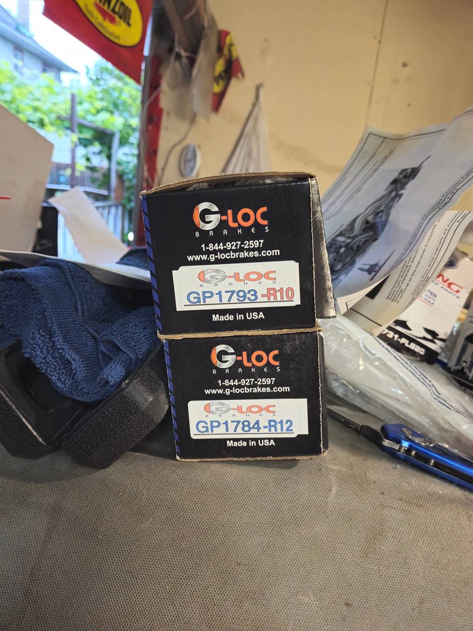

So driving with them for a week now
~ unbelievable stopping power
~ very noisy ha-ha.

Ok, way, way too noisy. So went and bought some Premium Ceramic brake pads ha-ha.
